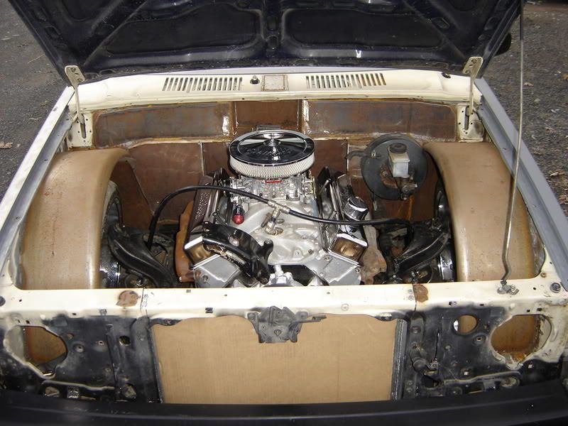

dragginmazda86 (dave)
It wasn't that hard it was just time consuming. My firewall is in no way smooth/flat. heres a pic.
