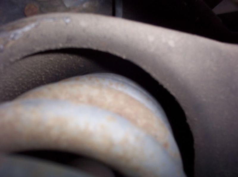

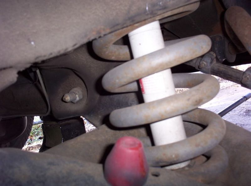

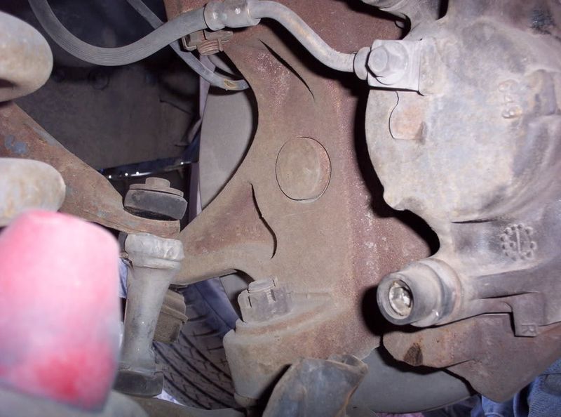

^It appears to ME that the spindle is in the middle? I dunno.. Look like a drop spindle to you guys?

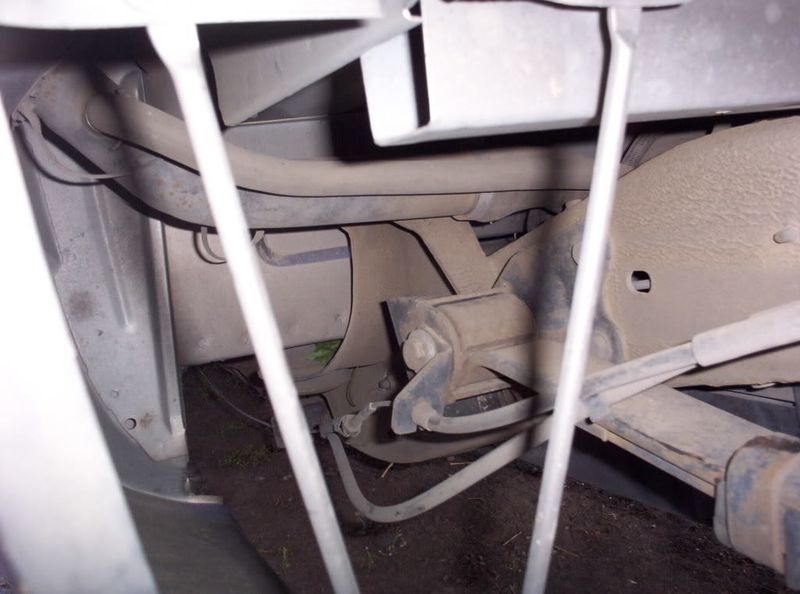

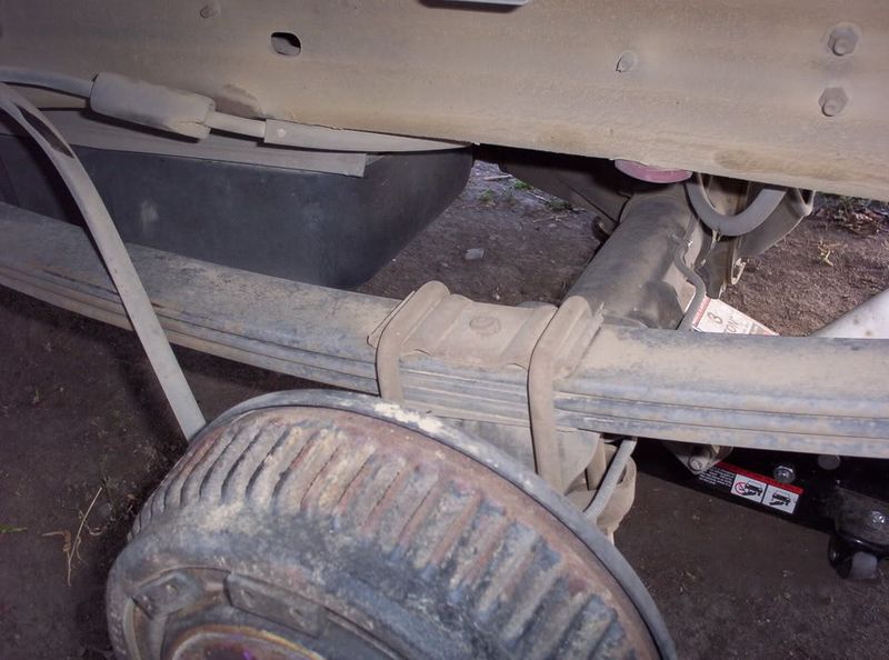

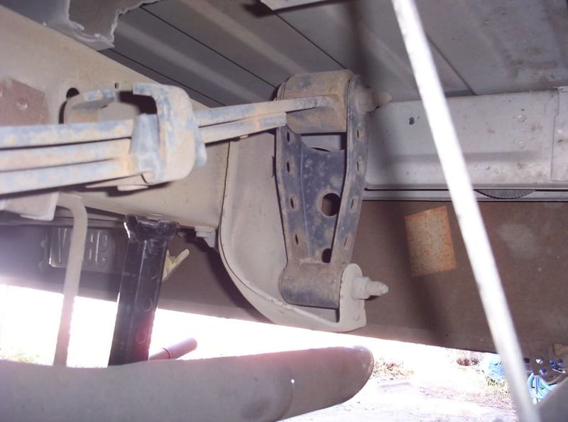

^This is my leaf pack, stock is actually a 4 leaf pack. So that means I'm missing a leaf. I'd like to add an overload, but these trucks never had overload leafs. Anyone know if an auto store will carry leaf studs? The stud on there already is too short to add a leaf to get back to stock! Blah!

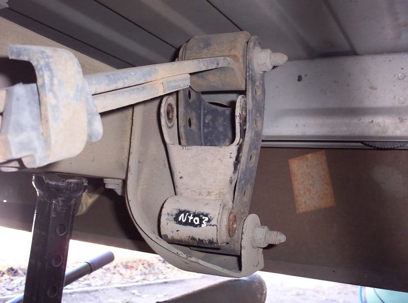

^This is the stock shackle compared to the aftermarket shackle. I might end up just adjusting the aftermarket shackle...
Other then that, if the spindle is'nt the drop spindle, hopefully it is the coil spring then cause, I'm out of ideas. Those are the only two ways to lower the front, right?

It looks like to me that it has stock spindles and the drop shackles on the rear. The front looks like it has drop coils mostly because they look like they have silver paint on them ala' BellTech or (ack!) AIM, but the red bumpstops make me lean more toward the Belltechs. Raising the rear is simply a matter of lowering the positition of the bolt in the drop shackle or replacing those with the stock ones. The front will require a stock pair of springs.
I'd say the reason the truck feels like it "walks" because of the crown of the road is due to the wider tires. I've had 4 of these trucks and every one of them have had wide tires on them and they all have a tendency to squirm if you are on a road with a severe crown.
Your local GM dealer SHOULD be able to get you a longer bolt for your spring pack. On my '91 that I had dropped 5/7 I had to get longer bolts for the rear spring pack because I also installed a set of helper bags and the stock bolt was too short for that application.
There is a company that makes a helper spring for the rear that bolts on to the back half of the leaf. I can't recall the name of the company right off the top of my head, but you might google helper leaf spring and see what comes up. Hope this helps!

Yea, I've been posting on the Chevy site, and a guy told me he said the front shackles are stock.
I've already picked up stock coils for the front. Did it yesterday, lol.
It could be because of the wide tires and road crown, not sure. But I also found out that trucks are made for haulin' and I guess its setup to react on the road when it has a load in the bed. Hence why I "float".
The dogtrackin' part has me stumped though. I can only think of it being because of the fact that its missing a leaf. Which IMO, altered my spring rate and is causing me to have rear steer.
I guess tomorrow I'll go to the chevy dealer and see about getting some studs for the leaf pack. Maybe even see if I can get a leaf from them too.. Probably not.
That helper spring is'nt going to raise the truck though, right? I want to add the overload to also lift it as well besides helping hold more load...
But thanks! I really appreciate you chming in!
Another question is, how can I raise the sucker? The drop springs by themselves seems like it would'nt drop it that much. I dunno, lol. We'll see when I put the stock ones in!
I'm thinking about just getting another leaf to go back to stock and then add an overload leaf and a 3" block. I just need to figure out how I can raise the front, lol.
