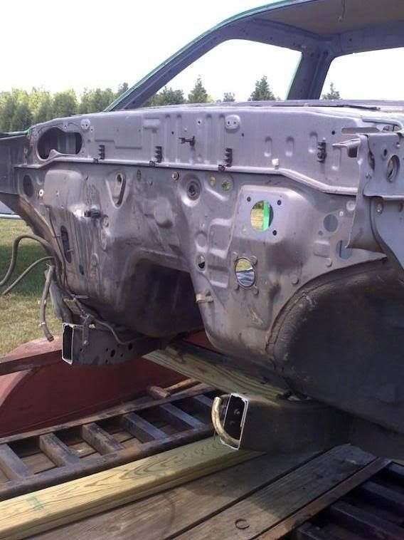

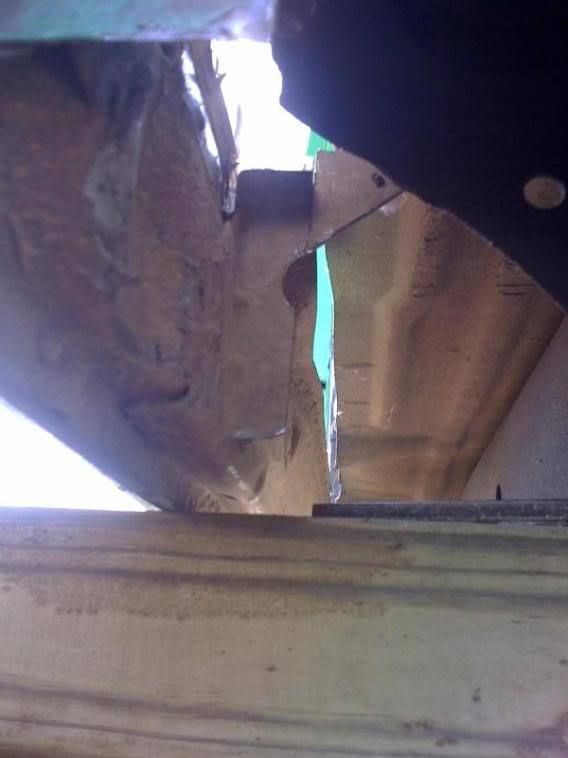

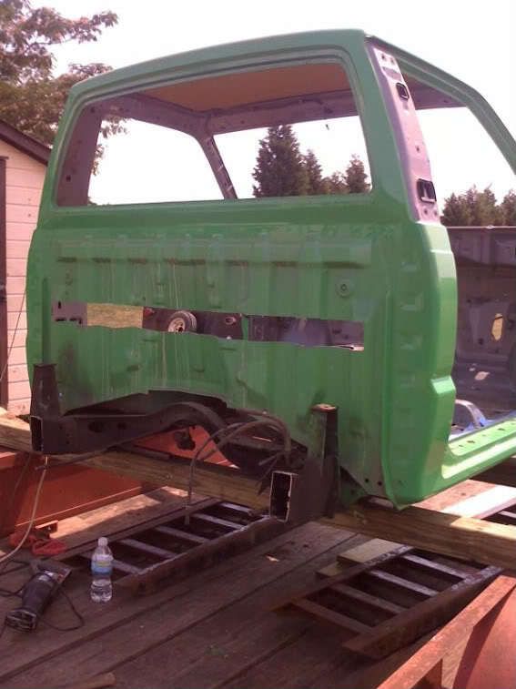

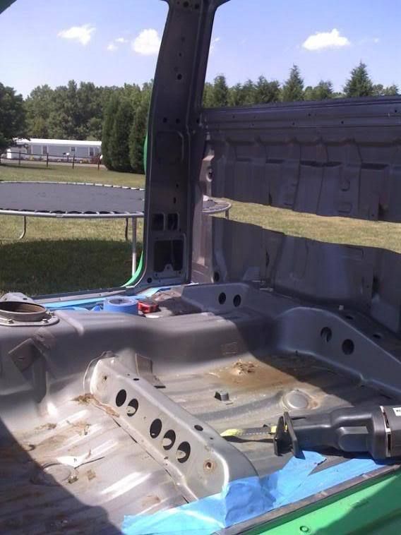

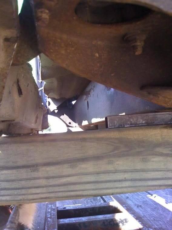

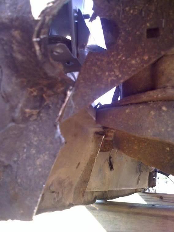

does this look right just got to get it welded up let if something doesnt look right

No offense, But those pics are hard as hell to tell what youre taking a pic of. Maybe some better pics? But it looks alright I guess

i was going to say the same thing.. all i see is cut metal.. i would have recomened a grinder with a zip disk for the cuts.. way easier to make a straight cut..
rotate the pics man

rotate 90 degrees

danm I feel one hell of a headache coming on but I turned my screeen on it's side and you need to get those lines abit straighter I would suggest the same thing as at dusk wrote cut off wheel and a marker to make a straight line but you have the idea down bro

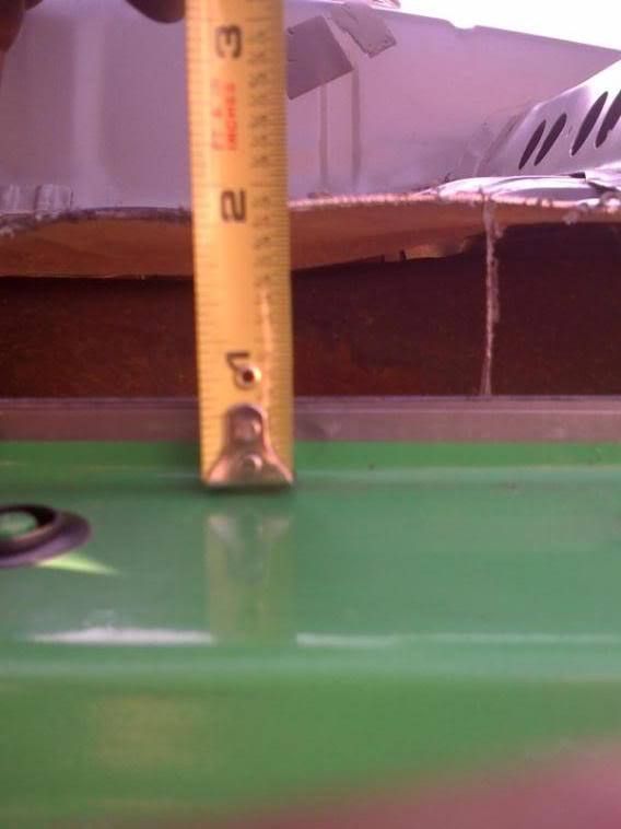

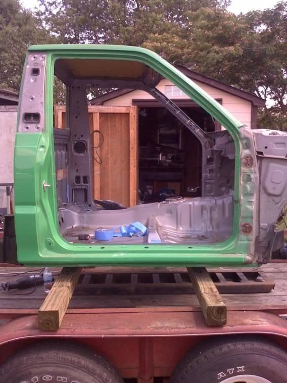

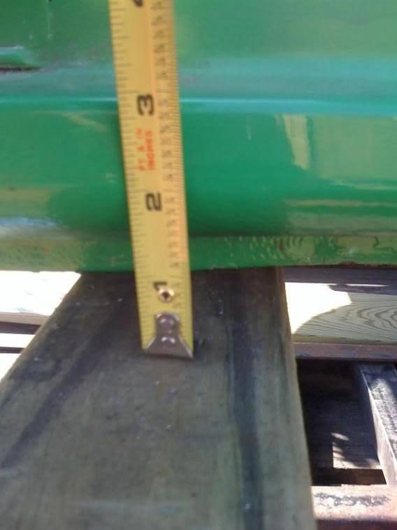

question #1.. are you laying your body lower than your frame.. it looks as though in a couple pics ( once i turned my screen sideways, thanks for the tip v8mazda) that you have the frame on the wood plus a i/2 inch peice of metal..... but the body sits on the wood only.. therefor making your body drop a 1/2 lower than your frame.. here is just a helpful hint... i did a 4 inch body drop on my 73.. and the frame lays the same as the body.. if i were to do it again.. id likely make it so my body sat about an 1/2 inch higher than the frame.. .. just my 2 cents... ( canadian, so it really doenst add up to much)

no it looks good i have done a ton of mazdas so i know that your pics are looks good man be carefull not catch the wood on fire when welding it up ...

answer to your question 1 no it still has the pinch on the bottom that im sure he will cut off later and then it will lay rocker and frame at the same time
