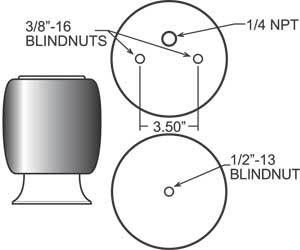

Get me some dimensions and ill cook one up for you. Ill need the bolt pattern of the bag, the diameter of the bag, and the diameter of your axle. I can make them 1 piece but youll have to have the outer flange of the axle removed, unless i make them 2 piece and you can weld them together around the axle.
severeddime
Thanks for relying so quickly. I guess I should also ask if you ship to Canada..
Axle Diameter -3.5"
Bag Diameter - 9.1 max
Two Piece
Bolt Pattern:

i started to then got tied up. The only thing i need is a dimension from the centerline of the mounting bolts to the center of the air inlet. I tried searching around for something but no luck. Do you have the bags in your posession?
severeddime
I don't have the bags yet, still waiting on them. I've asked a few club members, hopefully one of them can get me the dimensions.
