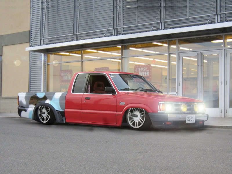

lower it...LOL
roger26i's avatar
roger26i
to hell with the rich kids be a snow plow lower it
roger26i's avatar
roger26i
pepehn
haha i had thought about bagging it/lowering it again...who knows.
we'll see what i can find.
if i go that route i know i'll need a box. maybe not right away, and i know i can find one..but i would definately need another. we'll see what happens here boys. lol

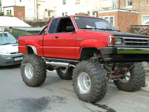

that last pic kinda makes me want to find a set of hummer wheels
pepehn
you can pretty much get them at the same price as you can steelies. haha.
if i do slam my truck, im gonna snatch a set.

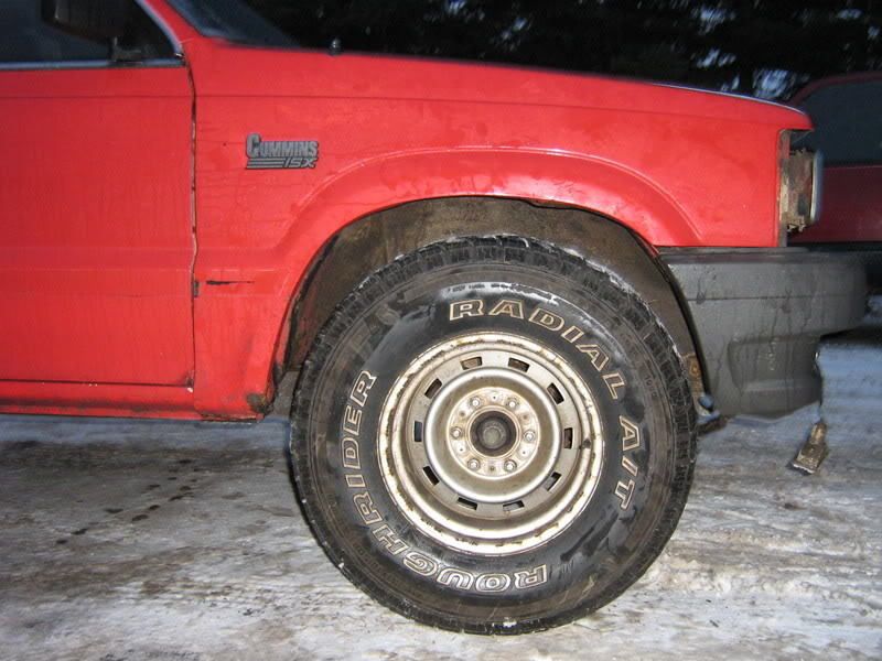

(235 75 15 Wrangler's)
i was thinking maybe i'll just go with a 2" balljoint spacer, and replace all my balljoints/wheelbearings..and maybe get some airshocks. maybe i'll just throw my pathfinders back on and rock a 31x9.5/ or 31x10.5 super swamper radials
(31x10.5 on a K5 Blazer wheel)
Old Wranglers: Mea RimWdth/ Sect. Wdth /Ovrl. Dia
P235/75R15 //6.50/9.3"/ 28.9"
Swamper Radial:
31x9.5x15 //7.5// 9.6 //30.7"
....hmmmhmmmmhmmm...just kind of thinking if the spindle will be able to deal with having a rim that sticks out as much as they do, with a wide tire...im thinking these should fit on my pathys with no rub in the rear, and minimal rub in the front after 2" spacers and a bodylift Im thinking...just looking for some more opinions.
