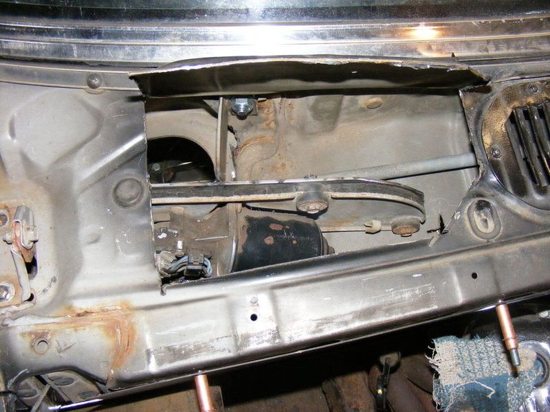

dragginmazda86 (dave)
These are the only pics I have of mine works great.
scotto79
I went ahead and just made a bracket lastnight and it worked out great. I cut a pattern that bolted to the back of the wiper motor, then just did a few tabs from that to the inside of the cowl. The whole thing just unbolts and is removable incase something goes wrong with the wipers as well.
scotto79
And thanks for the pics Dragginmazda, they really did give me a better idea on what to do.
No problem man. I was hoping they would help you, those were the best ones i had. I attached my wiper motor very similar to your's.
