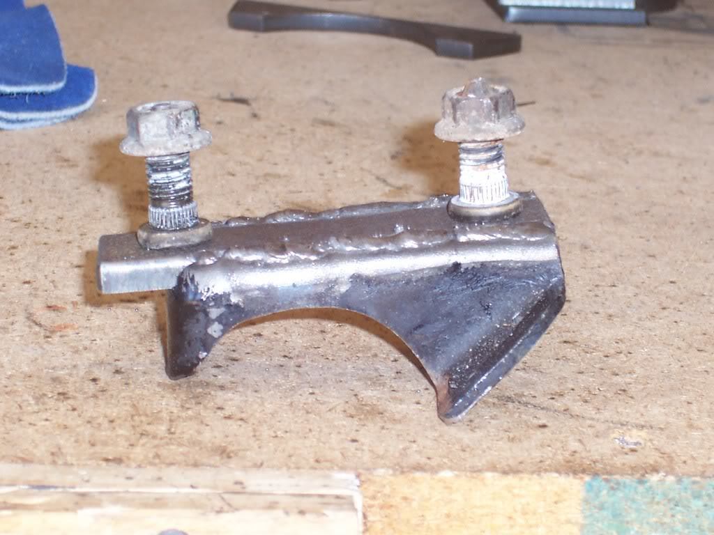

well here is some of my accomplishments so far in pics....other than this, i got the engine crated up &amp; shipped up to chi-town for cryo treatment....

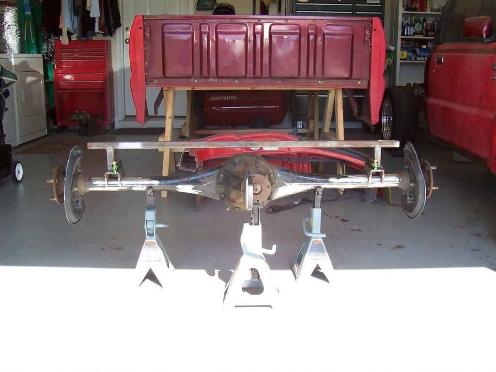

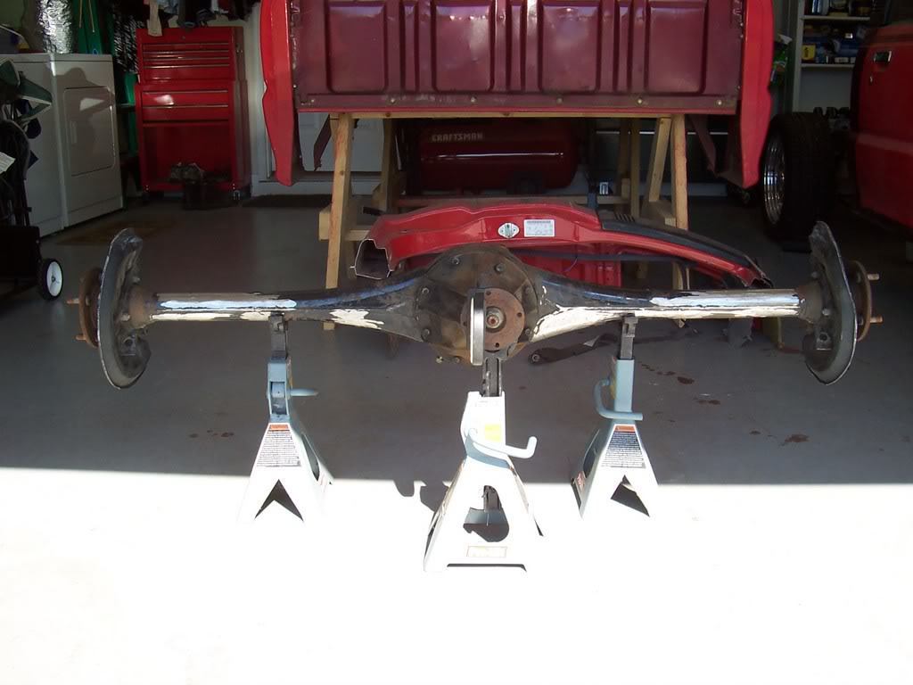

axle with all bracketry removed

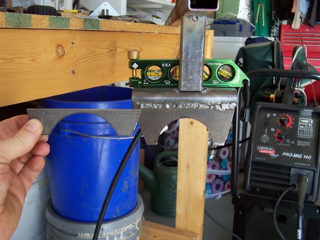

axle with homemade jig to position the leaf spring perches

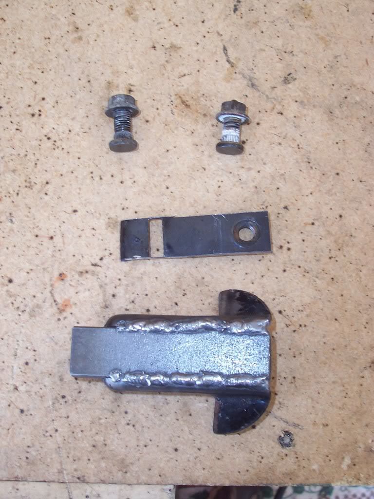

modified spring perch (had to cut off 3&quot; dia uprights &amp; reweld on 2 1/4&quot; dia uprights)

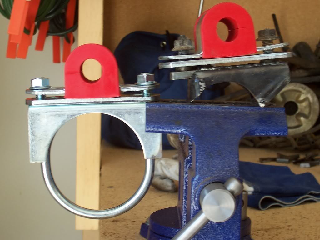

modified sway bar mount bracket (removed center piece, welded in new longer piece, and left over studs from when i swapped out the front coil springs on my old tacoma)
comparison pic, u-bolt came with the bell tech kit for 3&quot; dia axle shaft, had to redneck engineer something that would work.....modified mount that i removed from the axle
should be able to have the axle in the truck in the next day or so with the sway bar on, and the shocks mounted.....will have to pull the axle shafts &amp; carry them to be drilled for the 5-lug pattern....

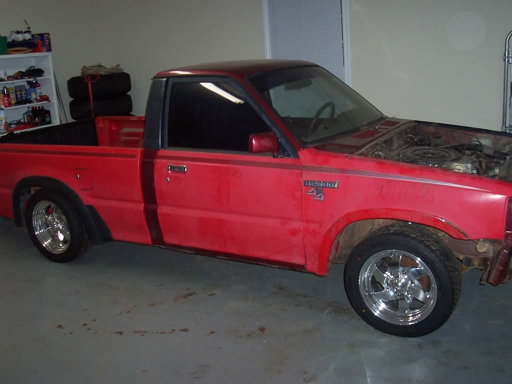

Lookin good...Whats your truck look like overall? I dont recall ever seeing it... Post some up.

not much to look @ madmaz....but here is an old pic.....
