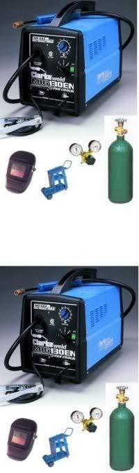

Ok. Well I sold my 302 today and possibly have my hot wheels sold...so that means I get to possibly get my welder for Christmas. Question to you fabricators in here is this welder ok to weld frame, body, and whatever else may need to be welded on a mazda? Here are the copied specs and the link
Clarke® 130EN Mig 110 Volt 130 Amp (No Gas or Gas) PKG #8 - 130EN Welder, Regulator, Mig Cart, Solar Auto Helmet & Cylinder

Simple answer, no.

Ok. Not a good brand? Or just cheap and wont weld worth a damn. I was going to be using gas.? What about the 220W one that they have?

I would aim towards a Miller.

I would love to buy a miller but they are sooo expensive. Since I am so friggin lazy anybody have the details on a welder to buy? Also where to buy at? I would love to find a package deal like above.

I bagged my truck with the same welder. Just have to take your time with it. The 220w 180 is better though. If I had the money I would have got a miller matic though.

I use the lincoln 135 and it does the job With gas. I have used the miller 210 and love it. When i upgrade it will be a miller...big one The lincoln you can find on sale priced right. I use a certain plug in my shop 30 amp with 30 amp wire to my power panel (very short) and NO extention cord and works just fine. If i did it again i would go with the 220 one thow. I got it at home depot on sale!

I use a millermatic 130 with gas, I would love to step it up, But it does the job.

Ive got a lincoln 135 just like dirtracer14, I love it.. I went to a local welding shop and it was used for 1 semester at a local college of technology.. I got it with a cart, full bottle of gas, nozzle, wire, ready to weld for only $475.. Not a bad deal if you ask me,, maybe you can find a similar deal...
Heres the welder new on ebay/ no cart no bottle for 200 bucks more...
