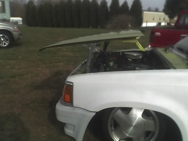

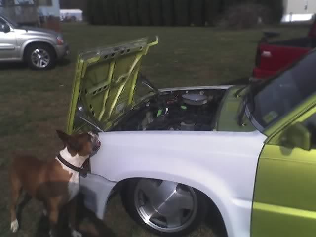

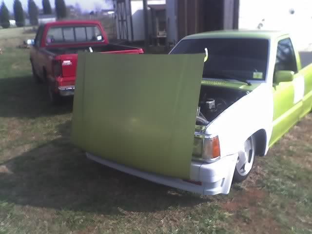

has anybody done this if so can i see your pic of it becouse i had to drop the hinge down 1 1/2 so the hood would shut all the way down and i dont like the way it is post pic if ya got them thanks

Best I can do for ya. Look carefully at hour your hinge setup mounts to the fender area. I modified mine quite a bit - actually swapped the bases side to side and welded the "stop" in a new location so that the hood is at an angle when open and not straight up and down and resting on the bumper.
As for tire clearance, you would have to be in the 20-22" rim range before clearance might be an issue.
