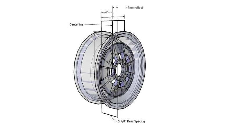

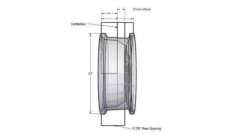

rear spacing = backspacing = distance from backside of wheel to hub mounting surface
offset = distance from centerline of wheel to hub mounting surface
when you are looking to tuck your wheels up in the fenders, the measurement you are concerned with is the distance from the hub mounting surface to front of the wheel (frontspace), but nobody sells wheels by this. they will only sell wheels by backspacing (inches) or offset (mm).
that rule i posted above keeps a frontspace of around 2.75".

got bored so i designed it up with a 3d model with a 20" x 8" with 47mm offset,
