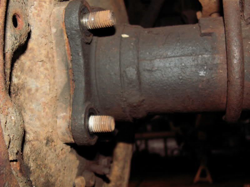

Remove the 4 axle nuts on each side:
Pull out the axles enough to disengage the differential.

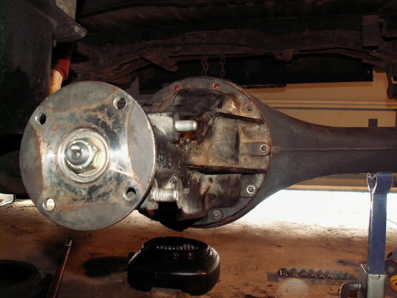

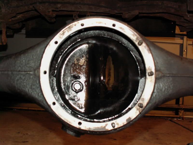

Remove all the bolts on the 3rd member case and pull out the diff. You should be left with this:

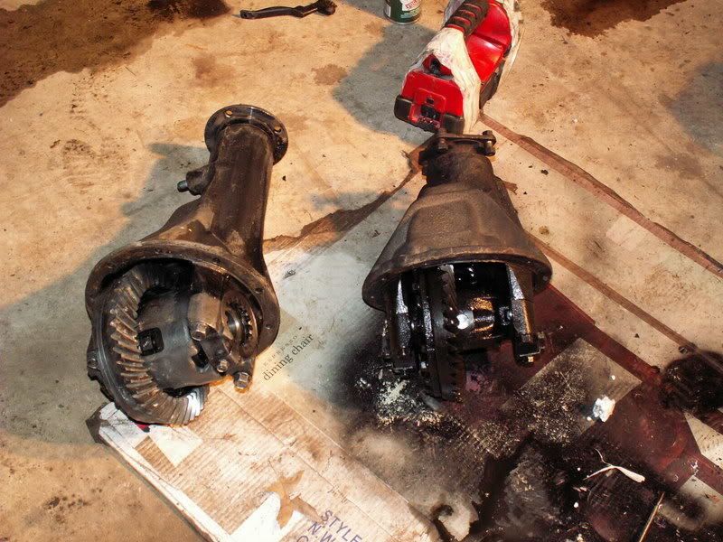

Here's my old open-diff and new Rx7 diff side by side:
Front view. Note that the long pinion will require a shortened driveshaft. I'm in the middle of a trans swap, so it doesn't matter for me:)

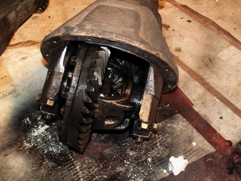

Check for broken spiders. Every Mazda rear I've seen has one broken:

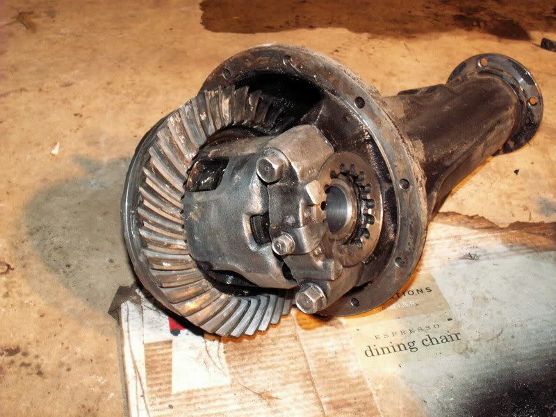

4wd trucks will require some grinding on the diff mounting flange. I took a couple mils off with a grinder at the 2:00, 4:00, 8:00, and 10:00 positions.
Here it is bolted up:
