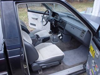

Heres my mazda w/ 94 integra buckets, just dont look at the door panels, lol

alli honestlry had to do.. was take the old seats out use those brackets... drill 2 holes per seat on the new grand prix seats. that was cause the sliders we shorter. bolt them in drill out the pass side slider area where it bolts to the floor.. so i can have more play n bolt them in.. also i loosened the seat belt bolt n moved it over sum cause it was hittin the seat when it was fully back.
thats about it.. ill make a how to? if you guys wants its not that hard...
the worst part is getting those damn seat bolts out in the first place... that hold the stock seat down.. mine looked like someone had chewed on it...

i'm plannin on getting some honda seats either some black leather gsr seats, 99-00 si seats, or some sick ass thin delsol seats. those should fit if the back 2 bolt holes on the brackets are flat and the 2 front ones are angled right? like all you need to do is drill some new holes.
miked
ya.. the 2 front bolts are angled down towards the front.
