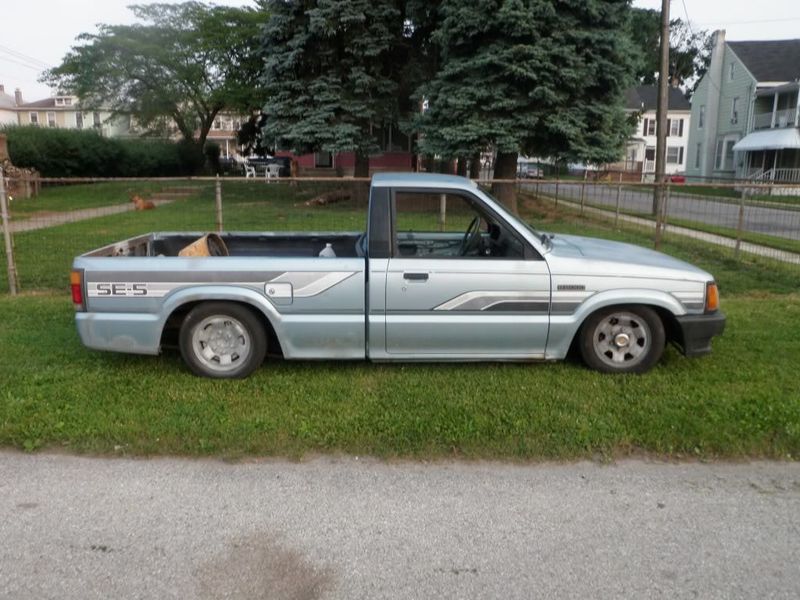

Hey, my name is John and i have been a member for some time but never posted anything until now. I have a 86 mazda b2000 and I love it. For now it has a static drop and i am working on getting the rust spots fixed. One problem that I do have is that the bed is rusted out pretty bad and I would like to fix it instead of replacing it with another one. I was wondering what you guys had to say about it. I don't want to replace it because i like how it looks with the decals on the side and would like to enjoy it how it is for now before I do anything major as far as paint goes.

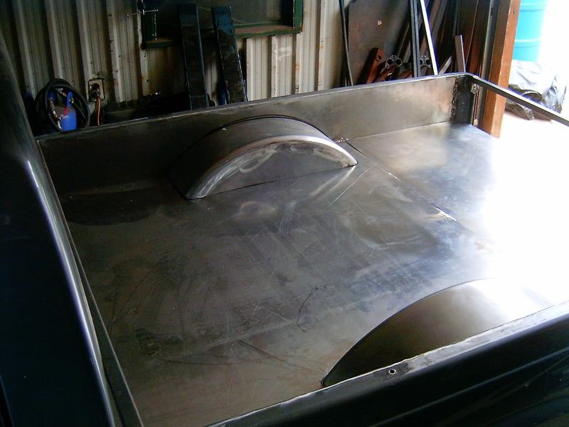

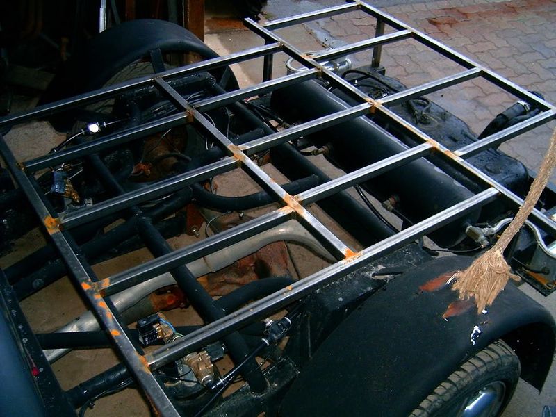

Welcome to the site and hunter has the right plan if you do not want to replace the box build a new inner box for it some thing like this
build a new floor frame maybe like this

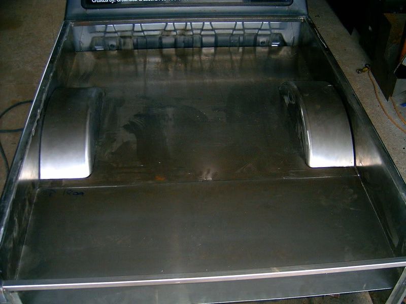

Then lay in new steel and trailer fenders for the the new inner fender wells
Here is a pic of a another friends box complete
