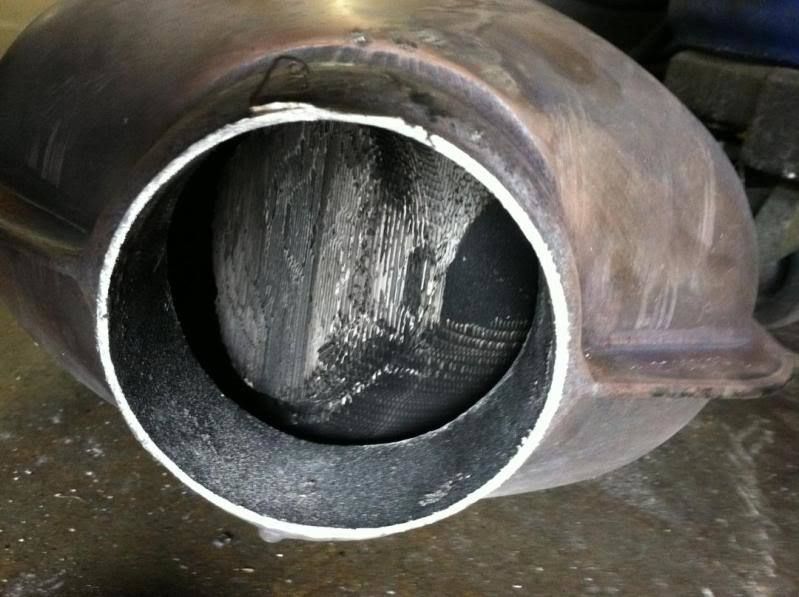

So this is what the cats looked like upon removal. Ugh...
krewzlo's avatar
krewzlo
Mine did the same thing by the looks of it. The honeycomb stuff broke in half and restricted the flow and then melted down and plugged it up so it wouldn't run for crap.
dropped fullsize's avatar
dropped fullsize
Yeup. Runs much better now, especially at cruising speeds. Off the line it still lags a bit.
