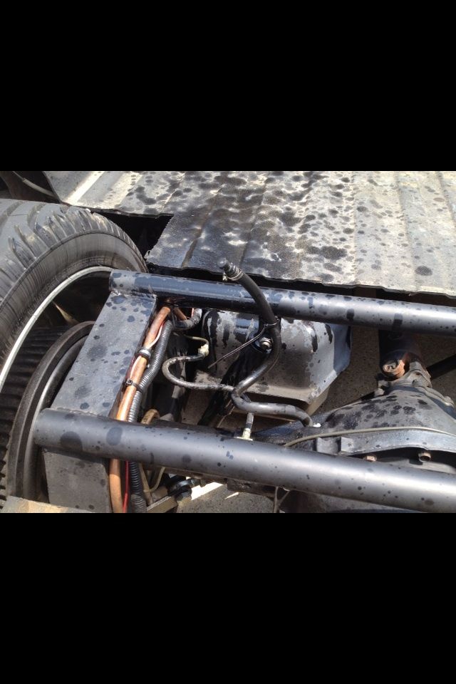

This is how the tube was at first before longer one was added.

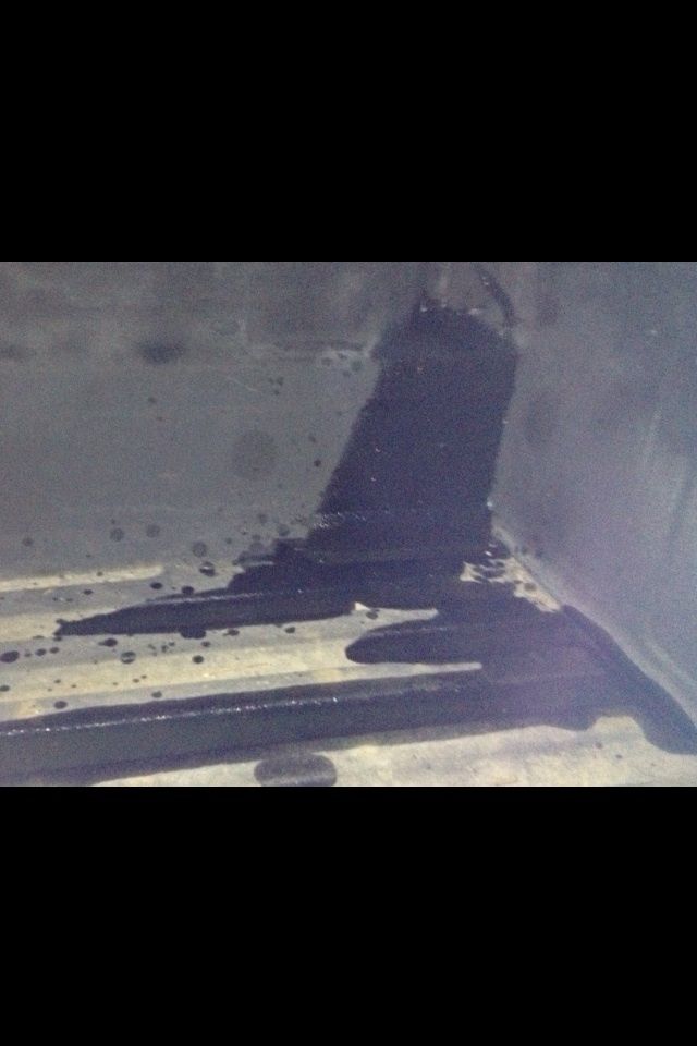

This is a pic of current location of vent and how much it leaked after less than 10 miles down highway and back.

ok so mine done the same thing when i first got it together.....with my 2 link when i ride real low the pinion angle is point down slightly and thats when mine puked out fluid....after it puked out prolly 3/4 of a quart it stopped....so i just left it 3/4 quart low and ive put atleast 10k miles on it and zero problems....not saying you should do that but i got tired of washing off fluid lol

Ya I thought about that but just confused why it went 800 miles with no puking whatsoever and then it has started every time I drive it. And I did just add 1/2 quart to it to top it off but that was just to see how low it was in case I was about empty. But have thought about taking more out to see cause it is a 2 link bar setup but barely angles forward any when down riding low but not sure if it will stop. Worth a try I guess. Thanks for the feedback for sure. And anyone else please chime in too if you know or have had similar experiences.
