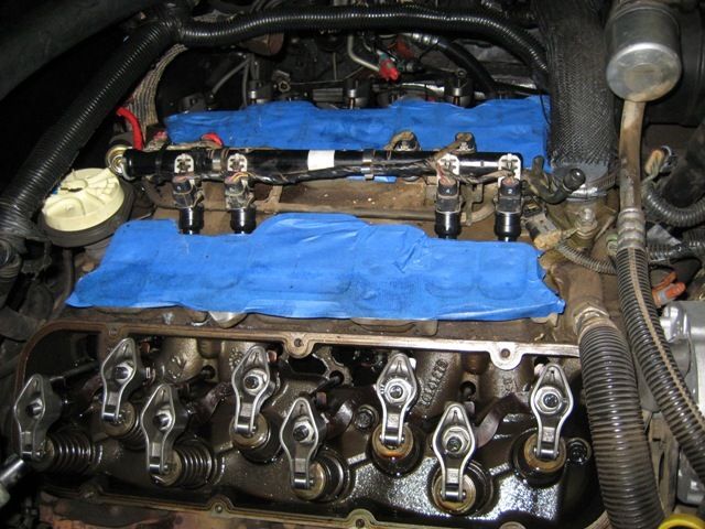

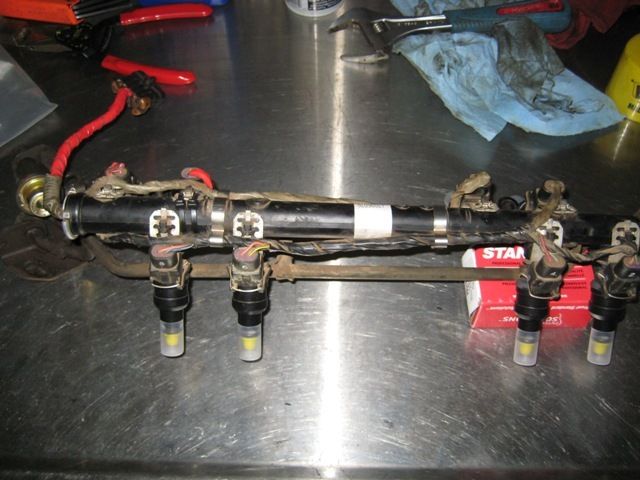

someotherguy
The hard restarts when warm is almost always leaking injectors / bad fuel pressure regulator. Very common problems on the Vortec 7.4's. There's some discussion here about upgrading to some Bosch injectors that are a better design. Best to replace the regulator while you're in there too. You'll be laying out nearly $400 in parts once you include the plenum and throttle body gaskets and crap but hey, ya want it to run right, yeah?

New Bosch injectors and FPR in place on the fuel rail
In place on the intake
Those are Comp Caps roller tip rockers used with conversion studs to make them adjustable, btw. Kind of a mixed bag and takes some dicking around to get that setup right, but if your old nonadjustables are way worn, it's an option.
