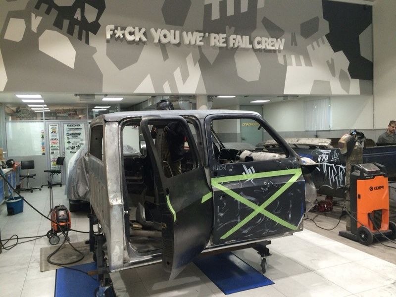

Hi everyone! Few days ago we started to wor with ma 1986 Chevy Dually Crewcab!
This truck had long and hard way from US to Hungary and finally came to Russia!
We raepainted it from cans)) ride a little bit, but not so long(

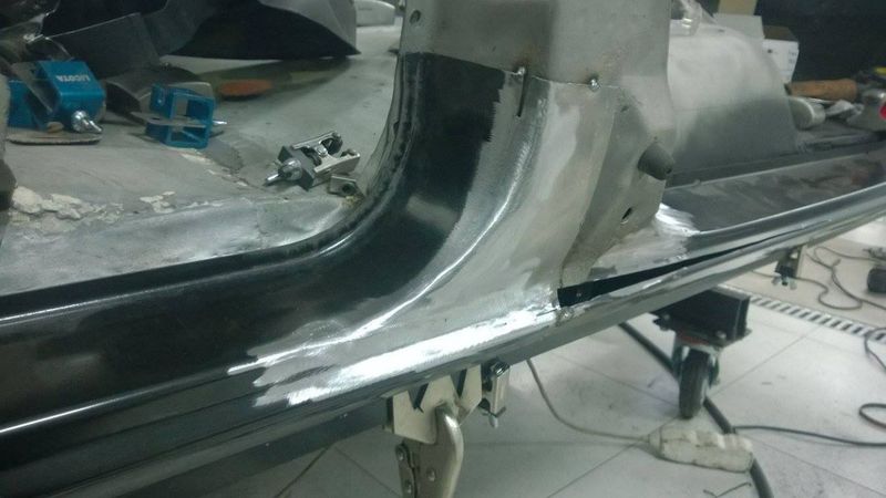

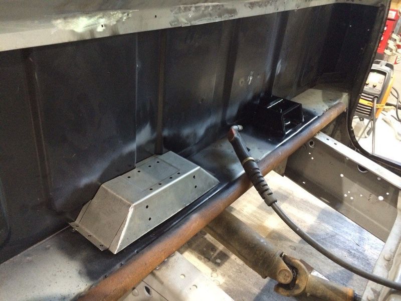

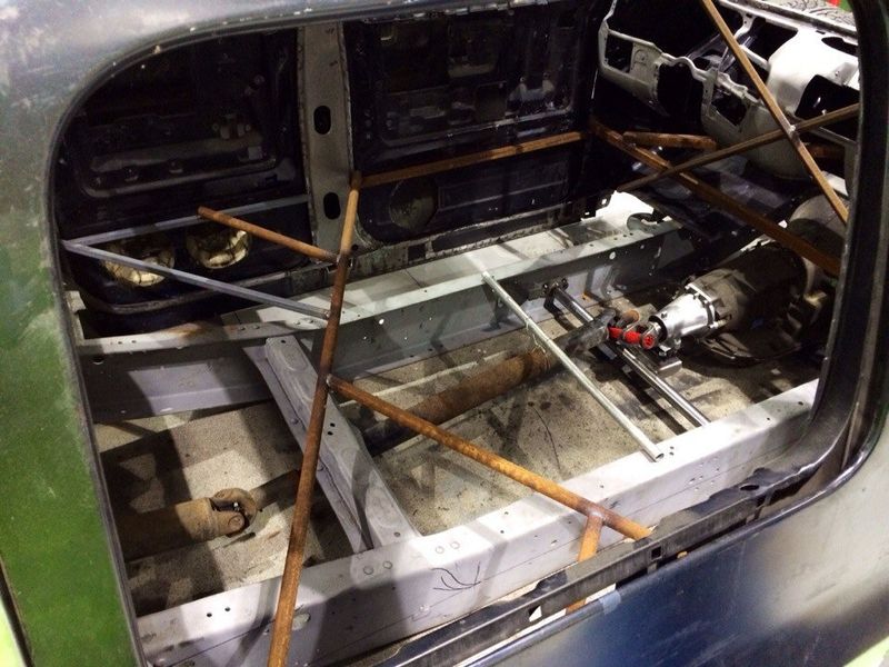

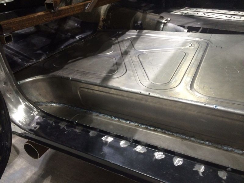

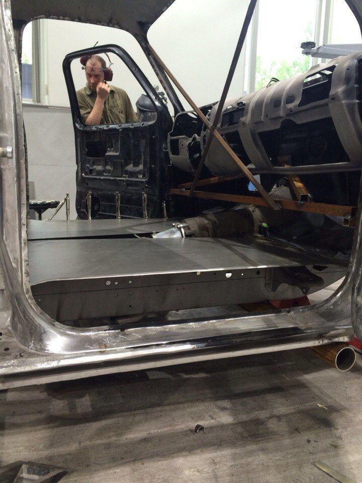

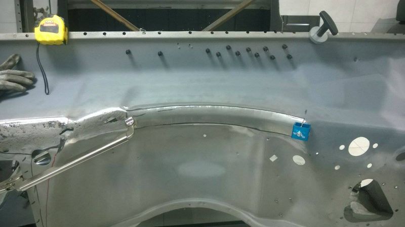

The condition was little bit terrible, but..... we have a cut and welding mashine) so let start to bang it!!!

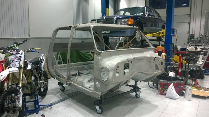

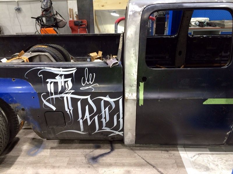

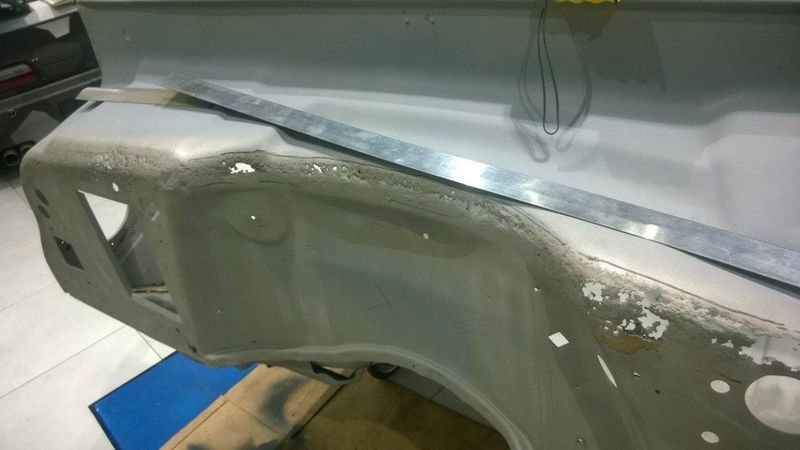

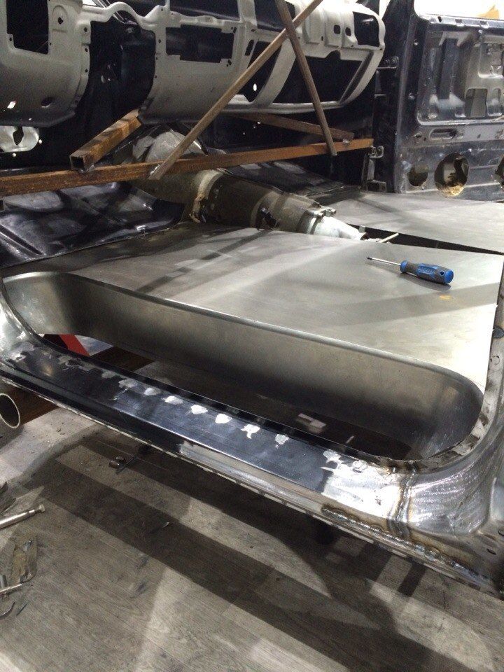

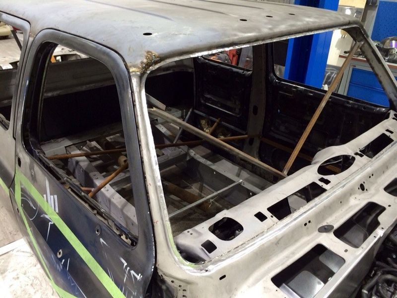

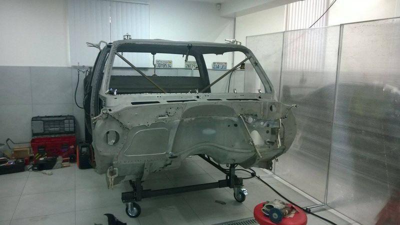

At first we need to restore the cabine!

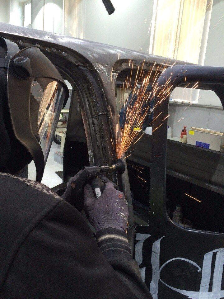

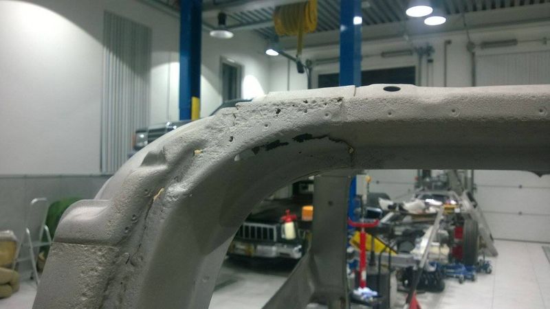

After sand blasting we found some new holes)) It was not surprise, but i was sad that it takes a lot of time to bring it to life!
and many other places was complitley destroyed((

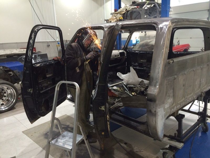

Two month ago we started to replace all shit.....

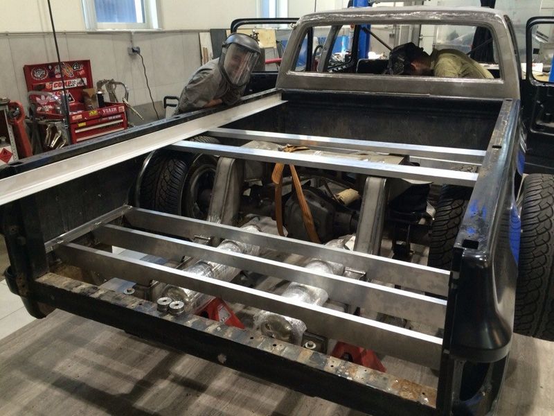

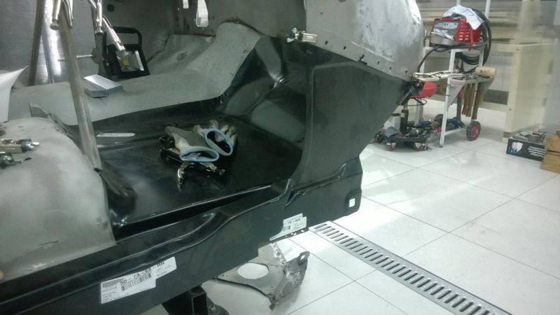

While my buddy rewelding the body we started to think about the frame!

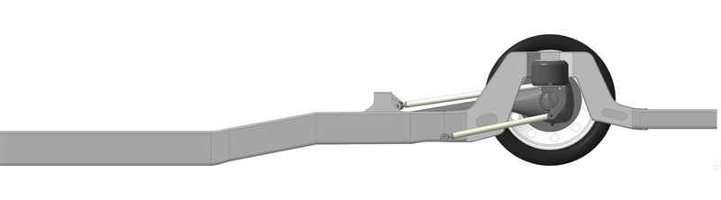

So many variations of suspension I saw in net... But i need to choose the right way! i planing to tow heavy trailer, so i decided to put susp. nearly like a truck
I think that it will work good and be very simple to service! This week we finally make a decision!

final frame configuration coming soon)
Just need to change of bootom rods angle for better stability

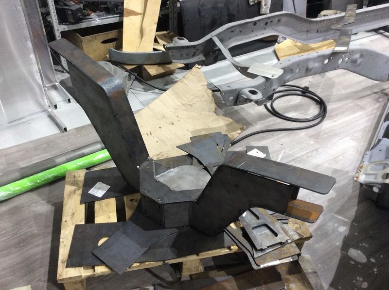

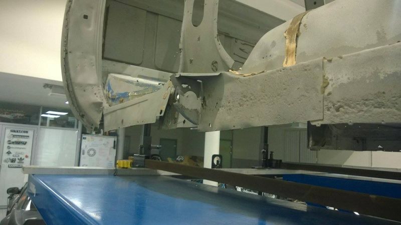

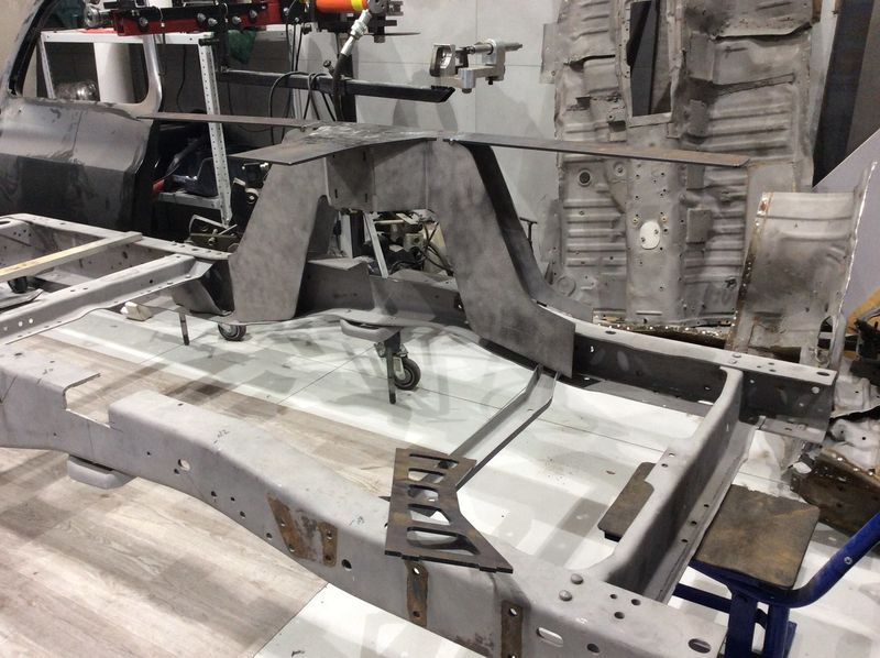

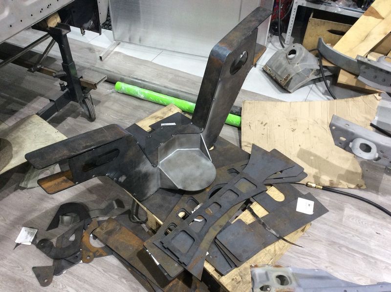

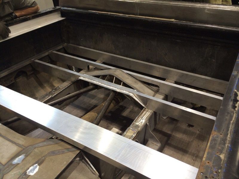

Hi everyone! Two days ago finally cane all pre cutted parts for C-noch!!
Perfect work! Huge respect to guys who did it! Yesturday we started to assemble to the frame!

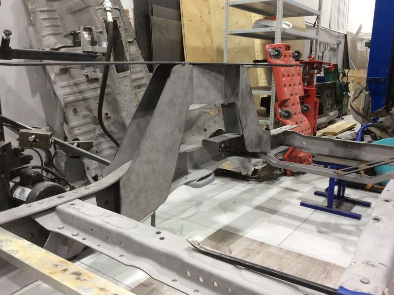

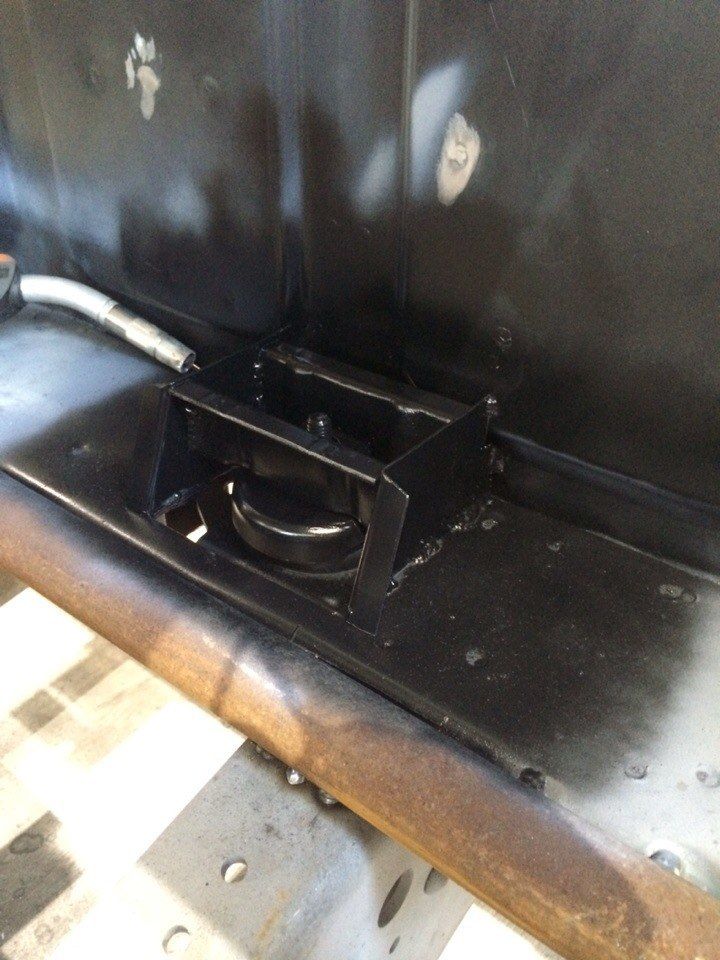

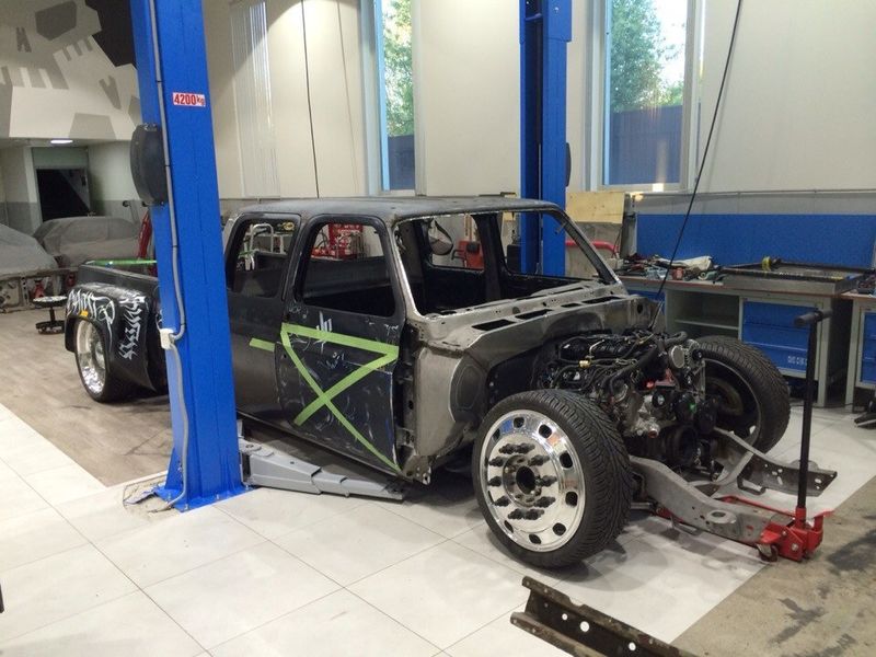

Hi everyone!

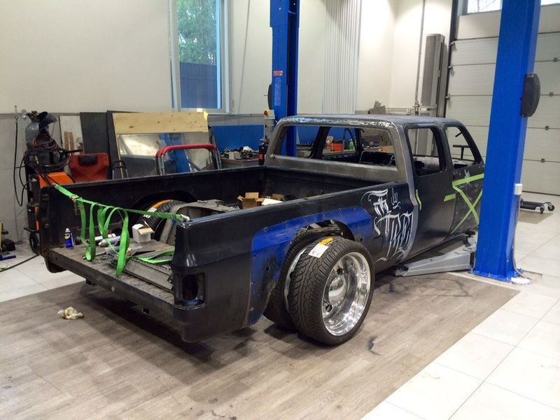

Rear c-notch is ready! All finaly welded! All stuff works perfect!

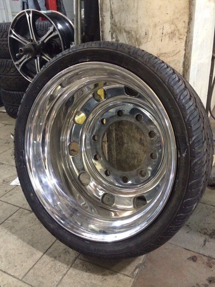

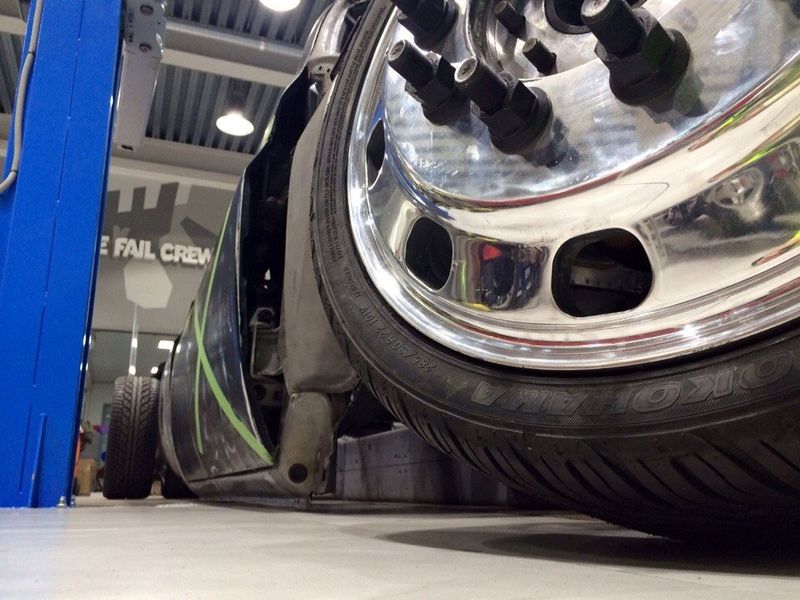

When we put on the bed we founded what tires diameter is bigger than the bed side( so we change tire from 305\45 to 285\30.. this is theonly size we found in stock! Now we can slam the frame on the floor with enough space for fenders!
But still we need to drop the body approx. on 3" for perfect laying)

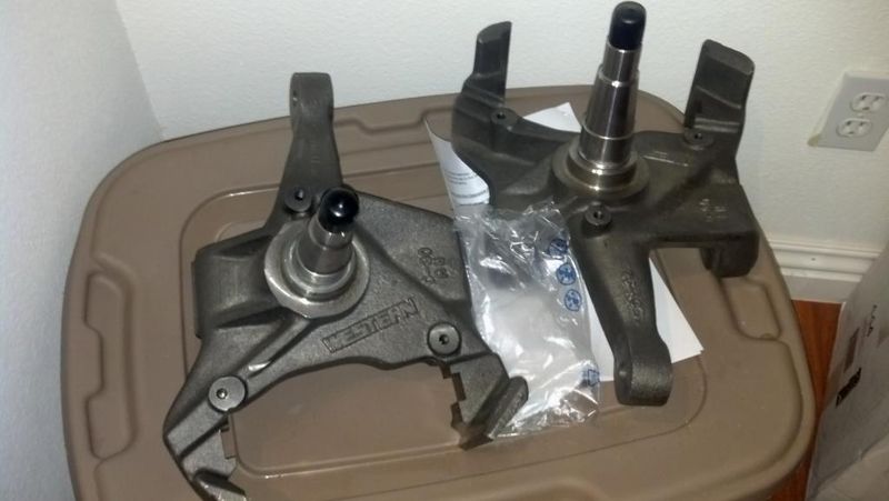

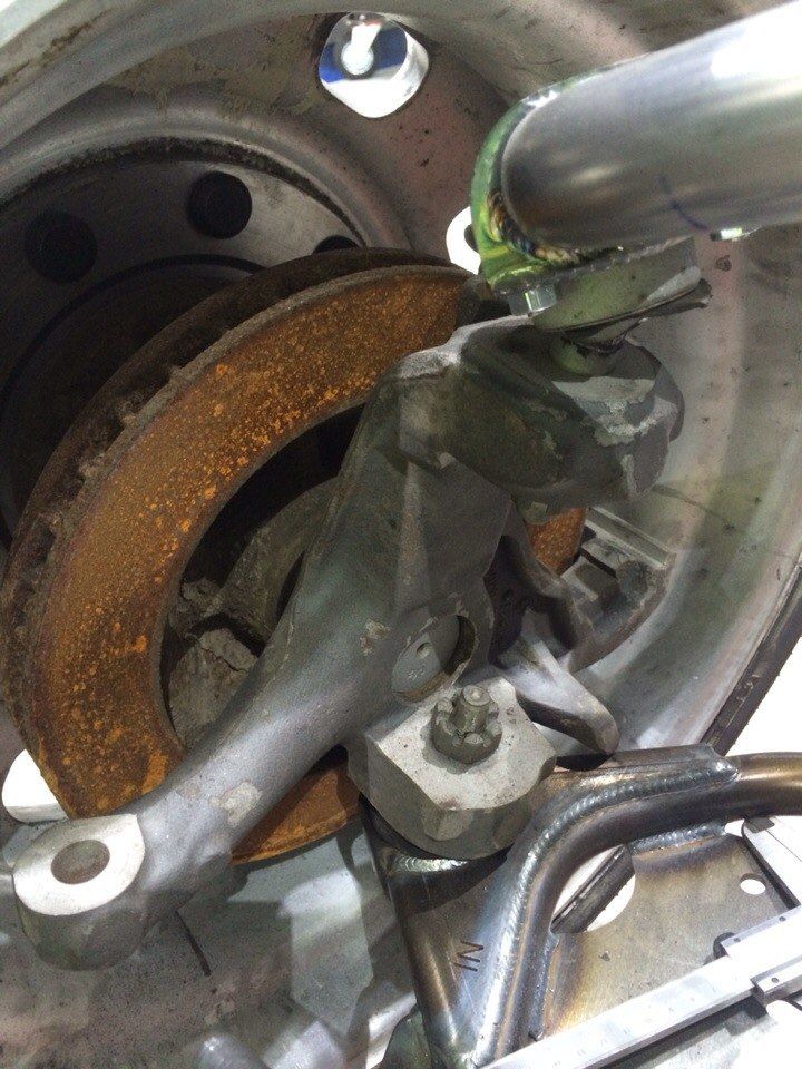

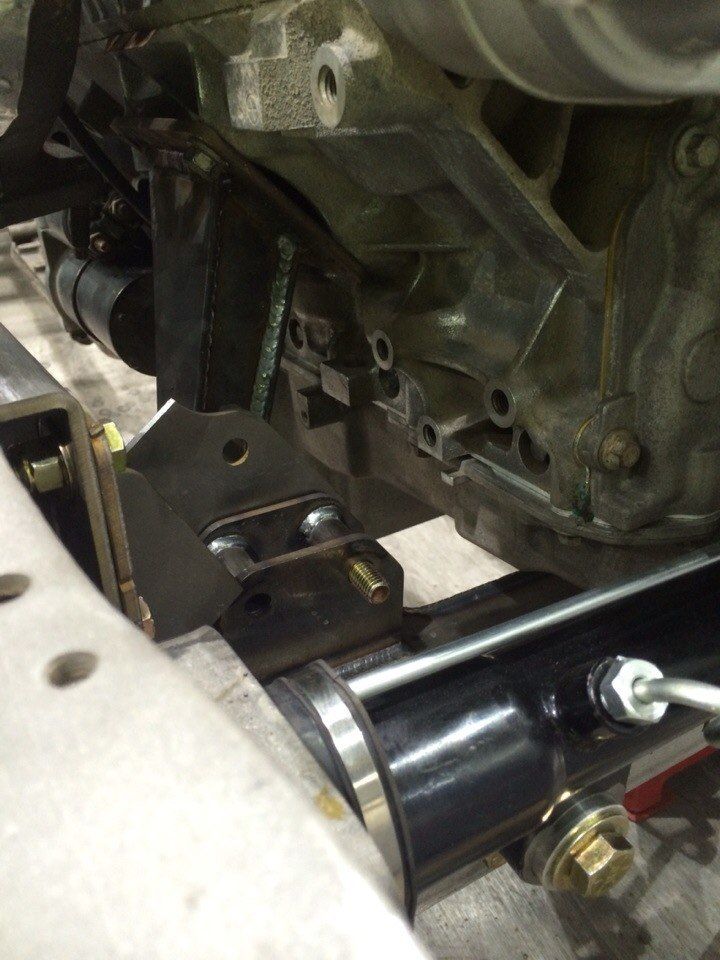

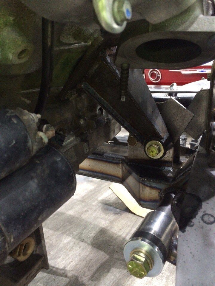

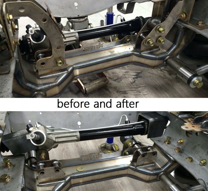

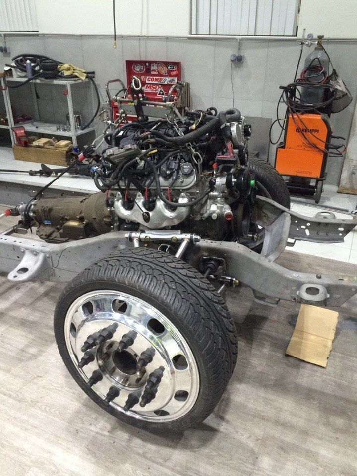

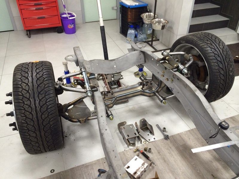

Next step we started to work with front suspension! I ordered the PB FAB dropmember kit! i recived it yesturday and installed it today! All things fit perfect except OEM ball joints! So i need the new one and also dropped spindels i forgot to order(
Tomorrow we put the engin in)!!

Are you using the PB Dropmember Extreme or Touring?

What rear kit is that? Where can I find more info about it?
Thanks
tutt
the frame looks awesome!! It looks a million times better than a frame made from box tubing.

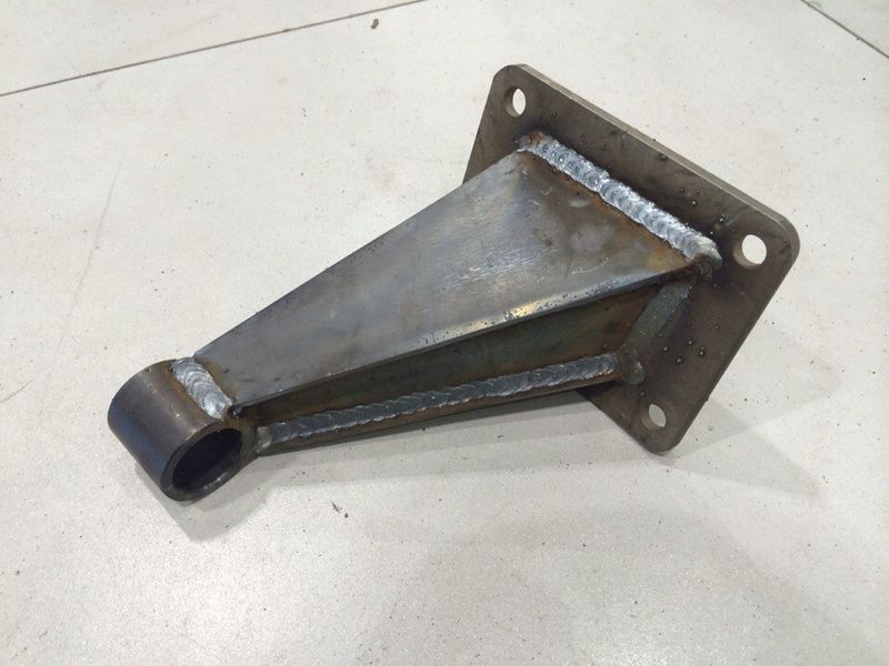

jumpduckfckup's avatar
jumpduckfckup

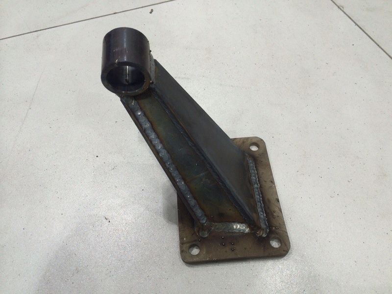

Rear kit we made ourselves, draw it in 3D and cutted with plasma cutting! I hope it wil works perfect cuz it looks really good in life.
