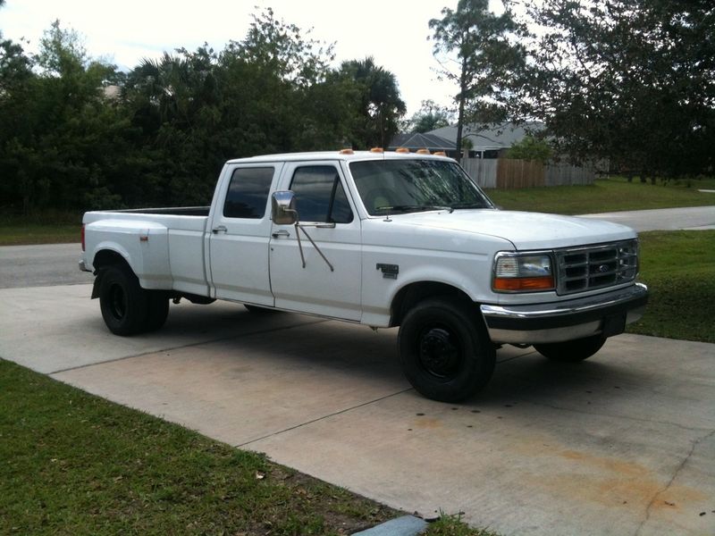

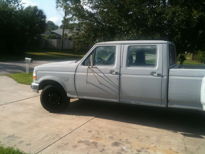

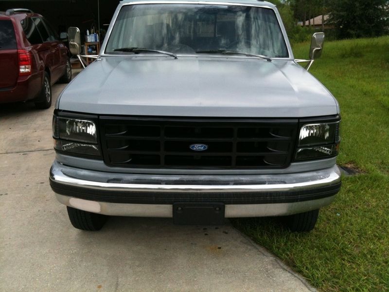

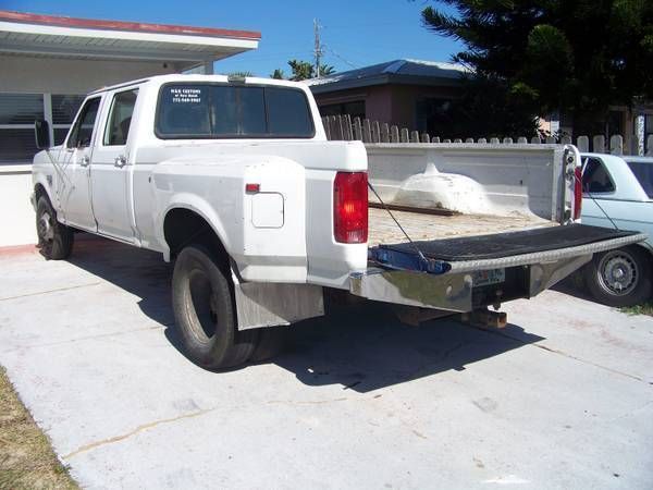

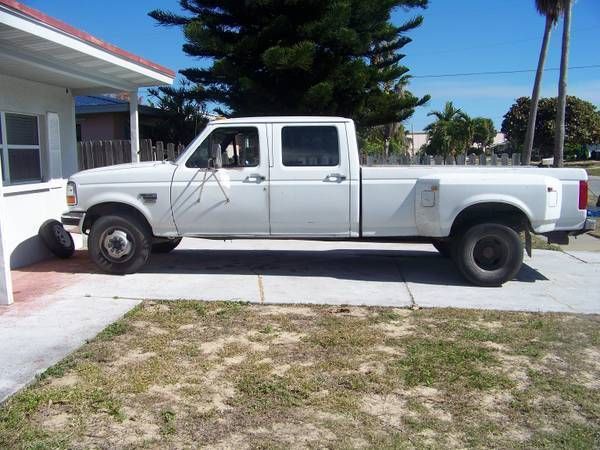

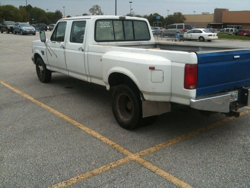

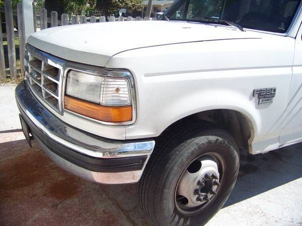

Here is the rig the day I brought it home. Simply put f@#kin ugly. The p.o. was crafty and put pictures on Craigslist with the gate down and when I get there the damn thing is blue. Oh well.
It's the 7.3 idi with 256K on the clock. The back four tires had cords showing but the p.o. gave me 6 new tires that I just needed to put on myself. Also came with a Banks sidewinder turbo and gooseneck. Not terrible for $2500.
Day 2:

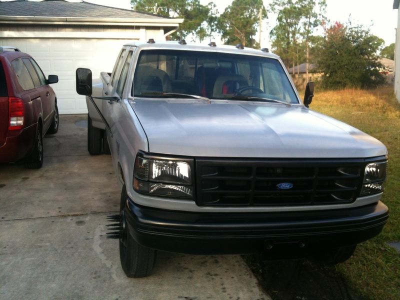

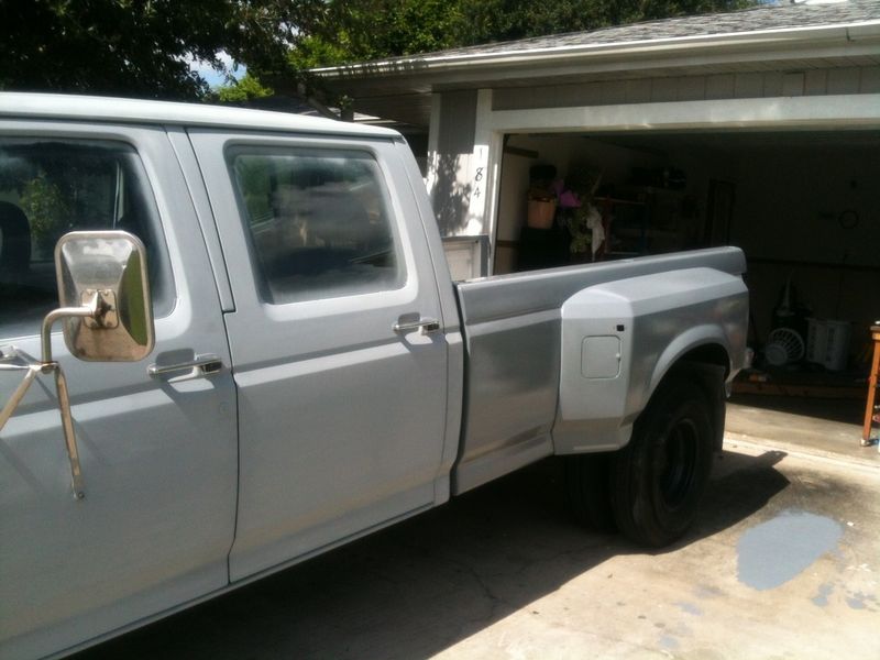

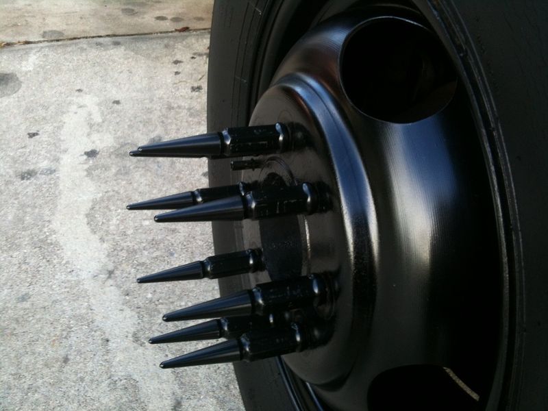

I had to paint the tailgate just to get by until I paint the whole thing and I sanded any surface rust on the rest of the truck to and rattlecanned it subdue any future rust. At the same time I sprayed those ugly wheels.
Fast forward a bit and I have thrown the new tires, two new batteries, new starter, and new glow plugs (p.o. had autolite garbage in it). She runs like a dream now.

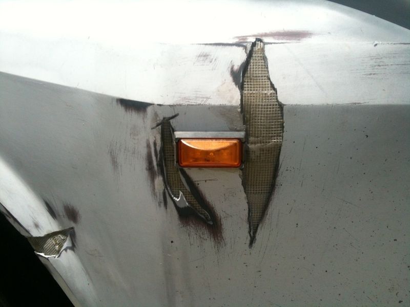

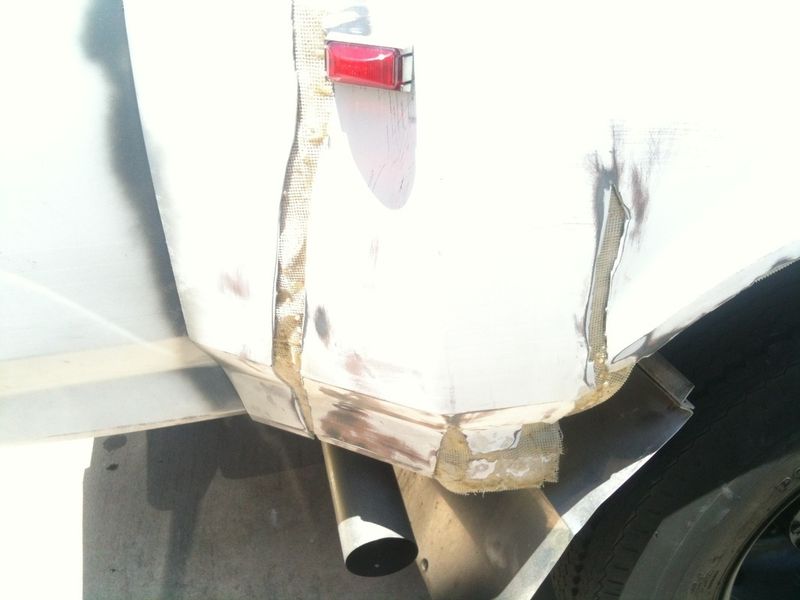

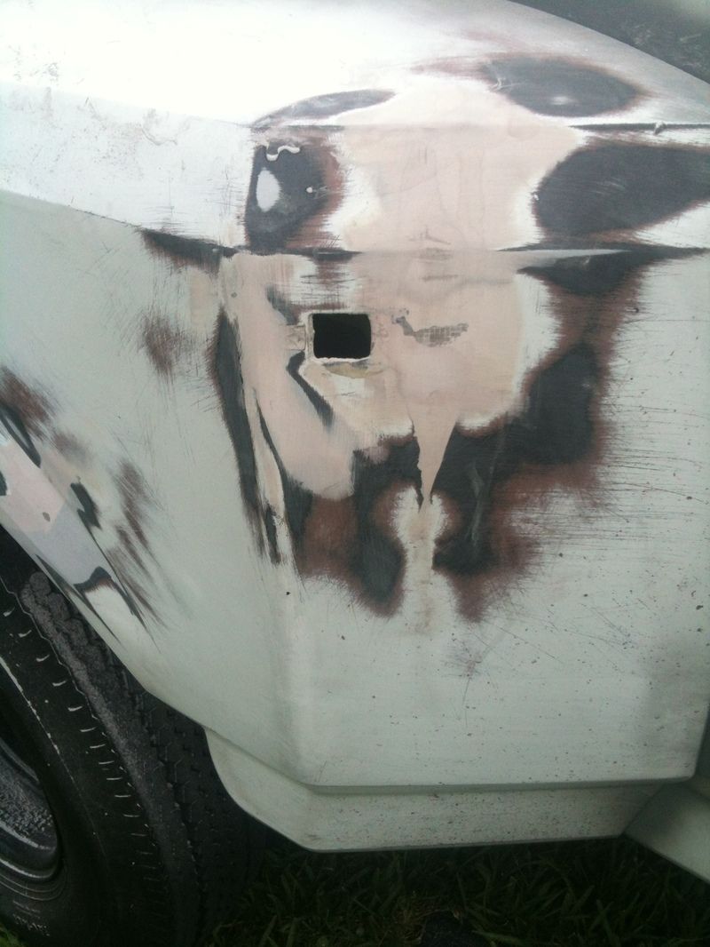

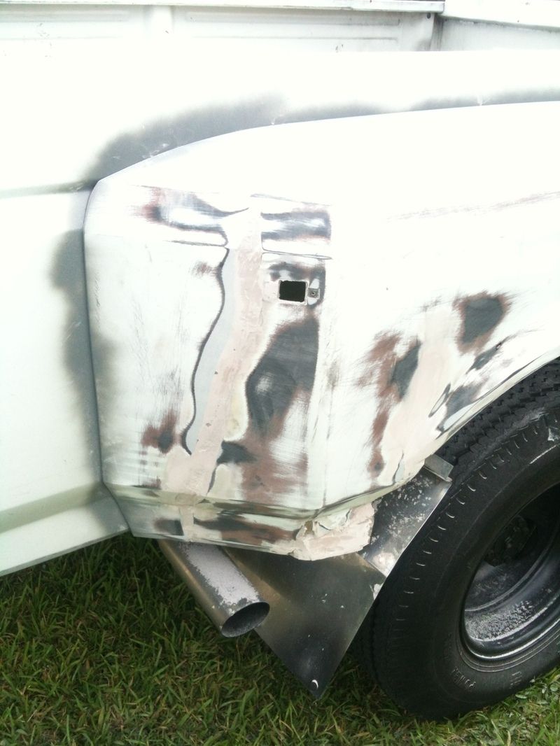

I started preping for paint with the busted right rear fender. It was cracked in 7 places and the left lower portion of the wheel arch was completely missing after some fiberglass, bondo, and a lot of sanding its starting to look pretty decent. Its only been hit with 60 grit so far so its a little rough but i'll go over it agiain when I'm ready to due the whole truck.
Fiberglass:

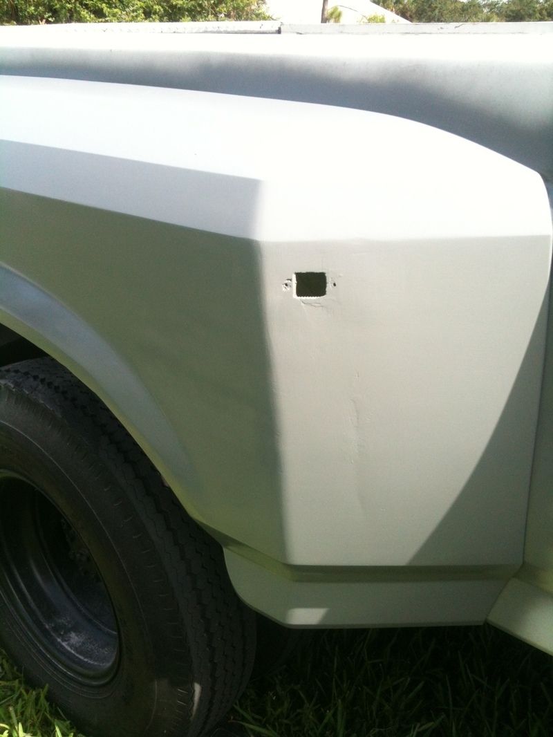

Bondo:
Presto!:
The fender still needs some love but its miles from where it used to be. And that's where I stand right now. Hopefully within the next couple weeks I'll have it painted. Stay tuned...

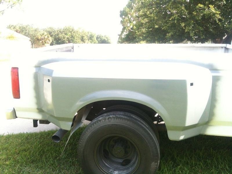

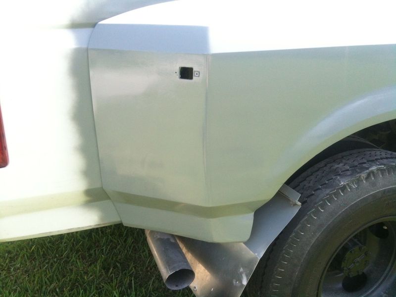

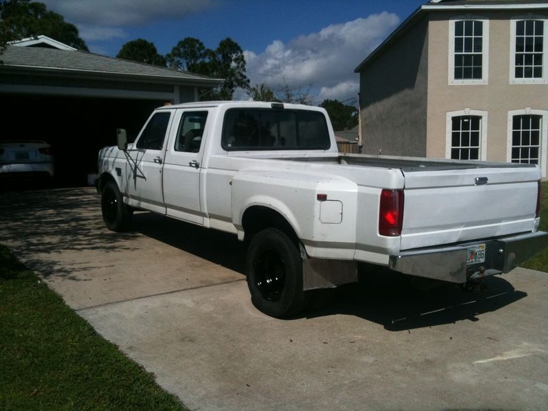

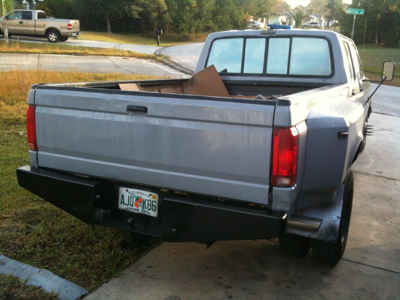

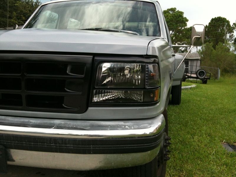

Finally started to paint the rig. Sanded the whole truck with 220 then hit it with rustoleum primer. It was so hot out when I did it that I said F it and didn't even tape the windows. I'll getting it off later with mineral spirits. Sorry for the shitty iphone photos.
Sanded the primer with 400 and started painting. The "instructions" for the roll on paint say to thin the paint 50/50 with mineral spirits but that was too thin for the heat and humidity of Florida. I did like 75 paint 25 spirits.
I've only done the bed so far with 3 coats and honestly it hasn't turned out too bad. Tomorrow I plan on wet sanding with 600 and do the last 3 or so coats and then it will need cut and buffed. Next week I'll do the cab.

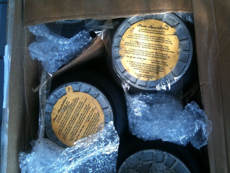

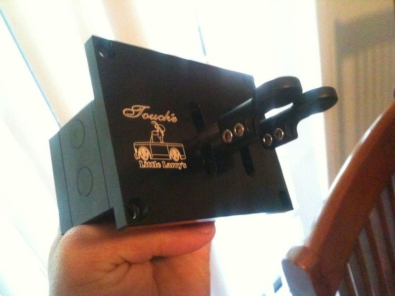

Decided to skip the static drop. I feel it's a waste of time for something I won't be satisfied with. I started collecting my airbag setup but it will take several months. I purchased a little Larry's touch
sadistic636's avatar
sadistic636

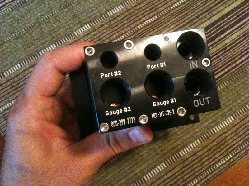

Heres the valve. Pretty sturdy construction and plenty of travel in the lever to adjust the fill/deflate speed. Paid like $150 for it. Only complaint is that the labels on the back are wrong the small 1/8 holes are for the gauges and the 3/8 are for the ports but being a smart guy I figured it out.
