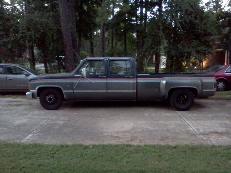

Here is my truck with 3" spindles, 2" shackles, 2" hangers, removed top overload spring, removed bottom thick leaf, removed 2 additional bottom leaves.
I planned on doing helper bags, but I ended up putting the two regular bottom leaves back in. It raised the back up about an inch from this picture. It has a little rake, but it still looks good. it tows pretty good too, but I haven't towed real heavy. I just towed a 5000 lb jeep on a 2000 lb 18' car hauler.
