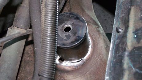

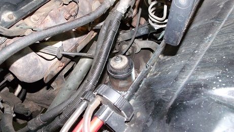

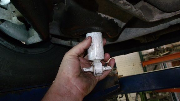

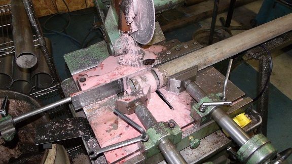

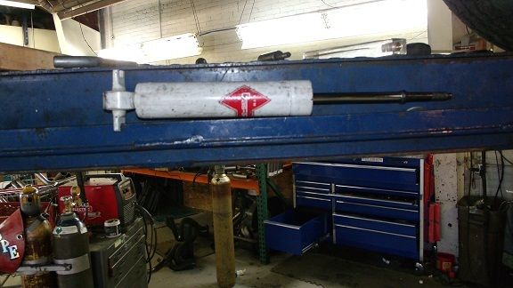

Picked this truck up about 1 month ago. Looks like the slam job is a kit and a cheap one at that. Front shocks were blown because they were too long. I wanted to run OE length KYBs because they are a good gas shock and I have a bunch of them kicking around brand new.
Here is what I did:

I suppose i could've gotten some "lowered shocks" but the ones I found were just old oil types for way too much money. The gas shocks work soo much better and I already have them. And I can run down to NAPA and get more.

Truck rides 10 times better. don't bottom out now After further investigation one spring was out of the pocket on top and wiped out one of the old shocks, so that side was shot. The other side had OE shock in it with about 1.5" of travel. It wasn't blown just wore out.

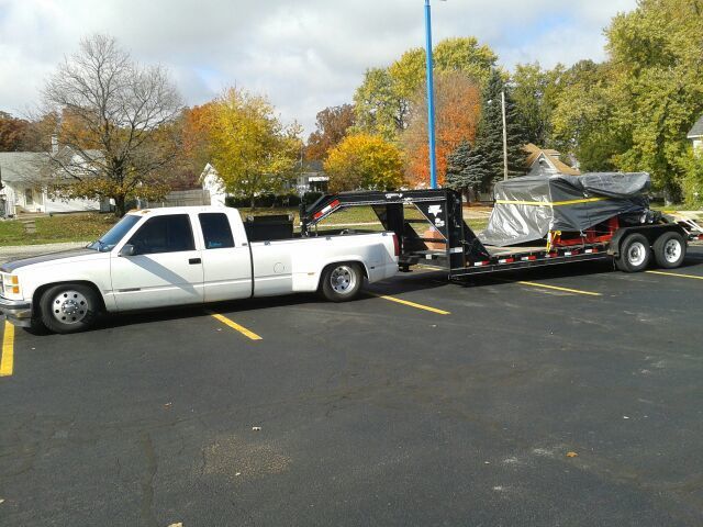

Took her to Indiana to pick up our new dyno last week. About 2800 miles round trip. I forgot how nice and comfy these old trucks are to drive. I drove straight through on the way down because I was late getting outa here. I coulda never done that in my '06. I'm ready to get outa that thing after about 500 miles. The dyno weighs 10k another 2k of steel cover plates and the trailer about 3k. Needless to say them Iowa concrete interstate was rough and made for a long haul. Gotta get the ass end lined out.
