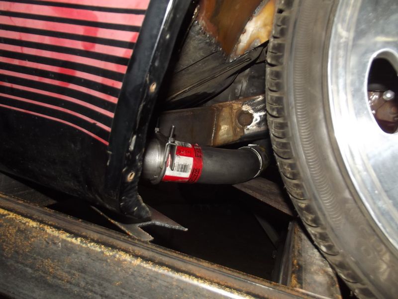

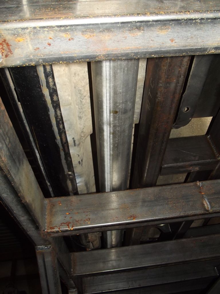

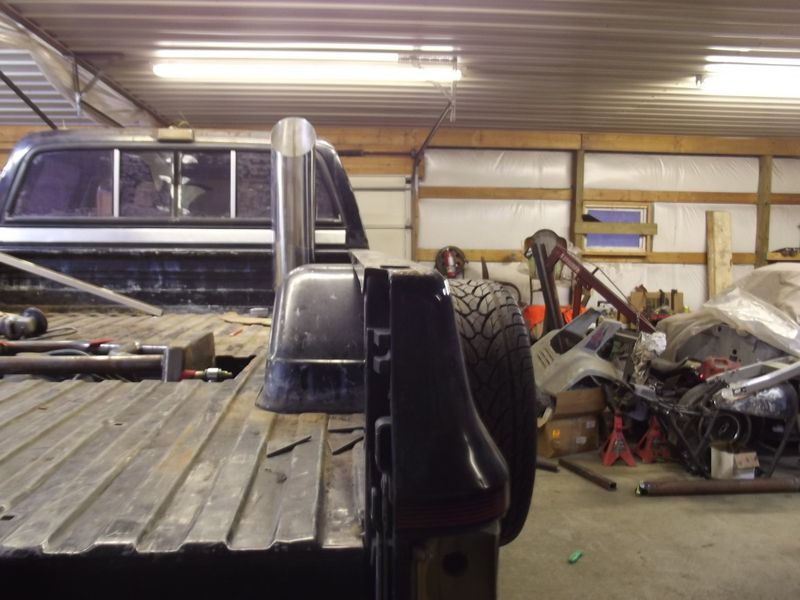

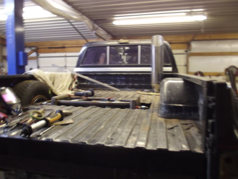

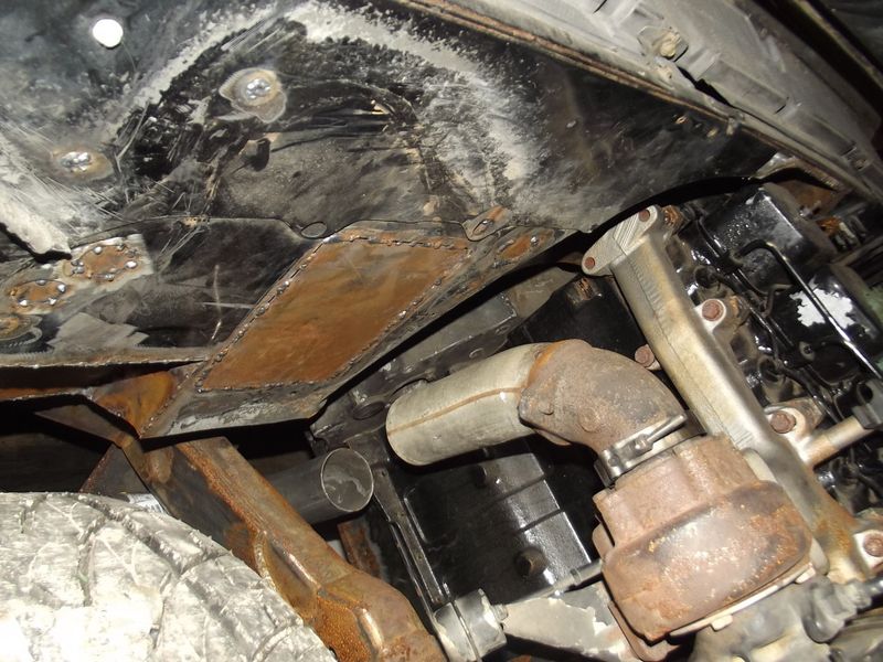

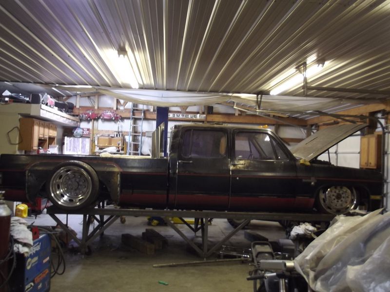

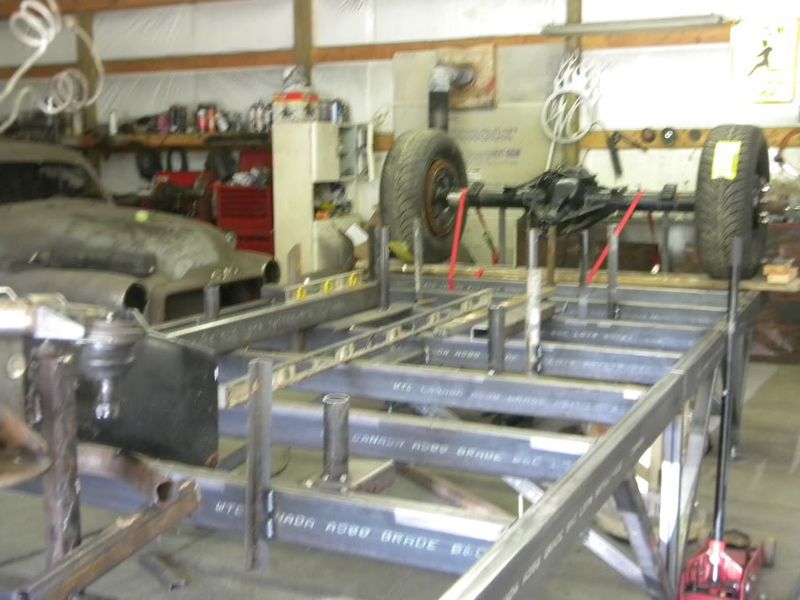

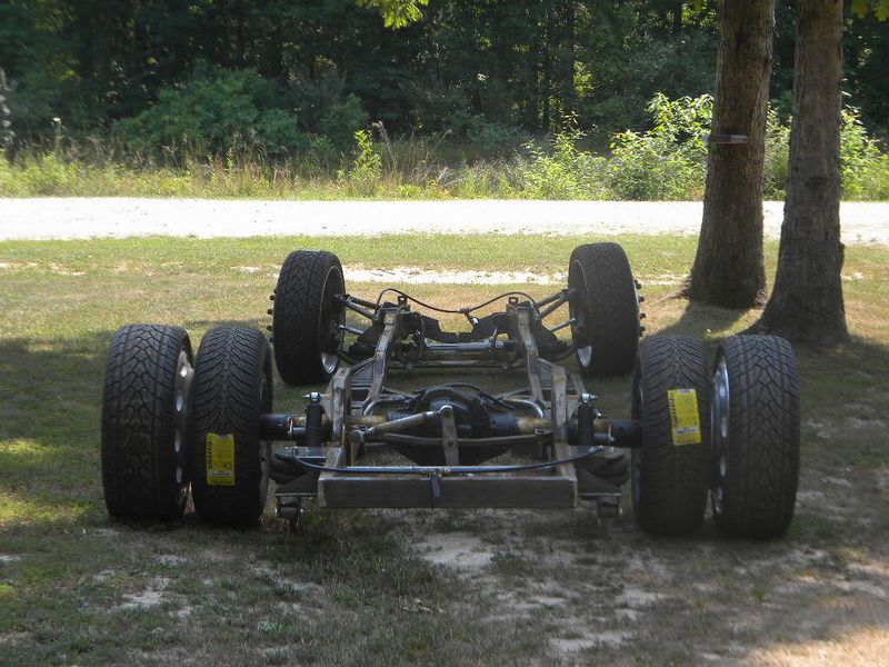

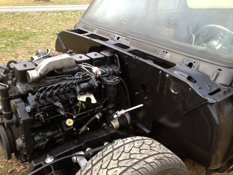

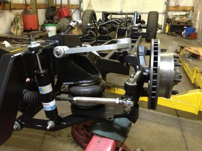

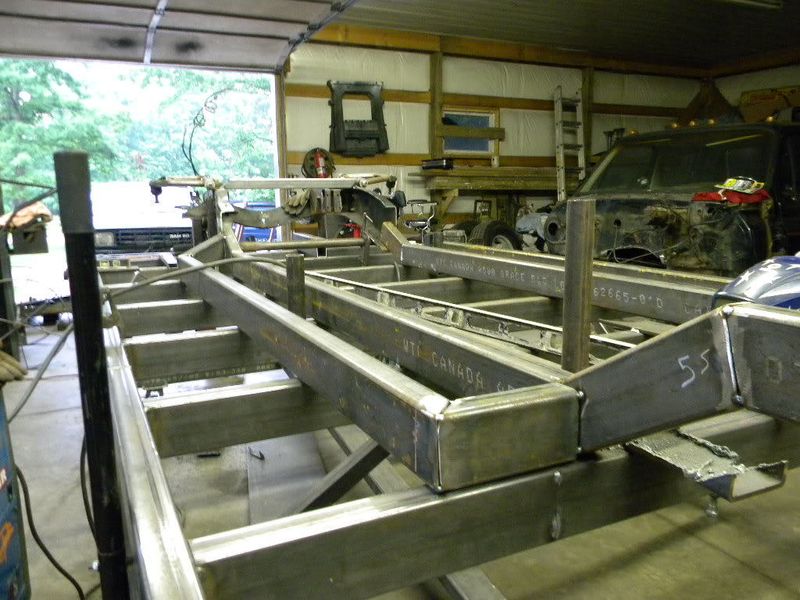

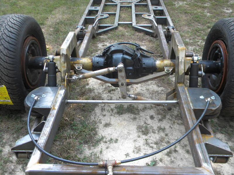

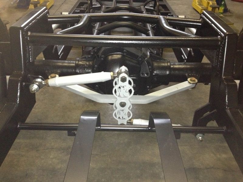

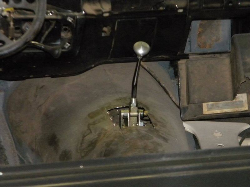

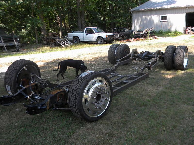

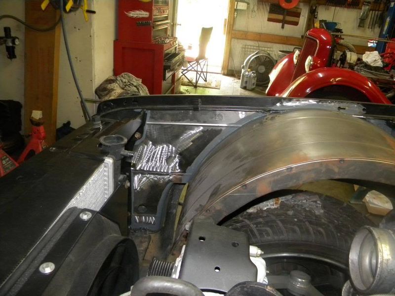

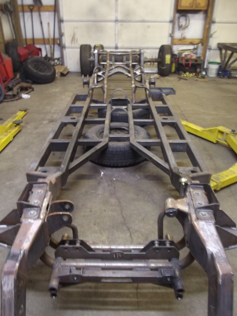

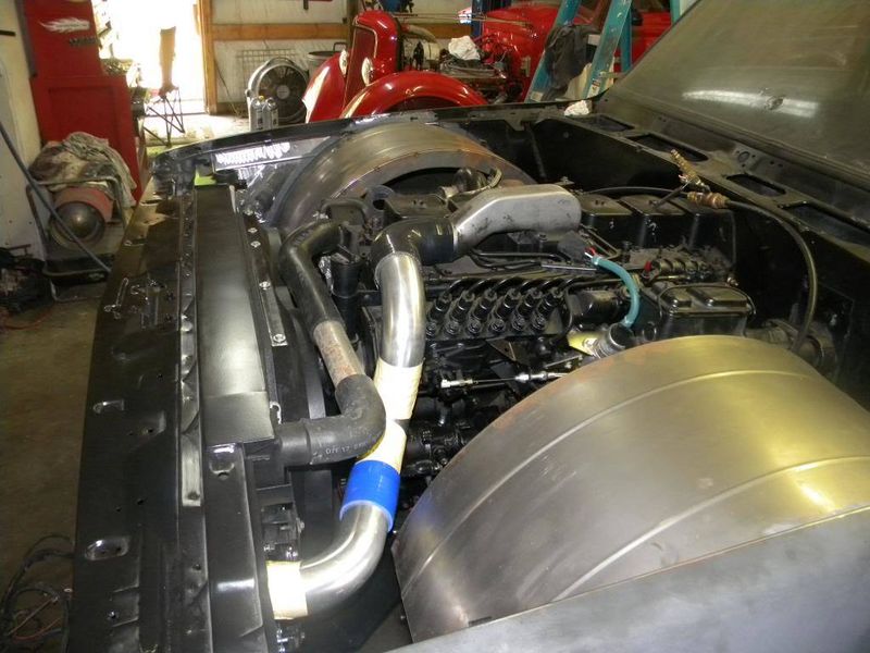

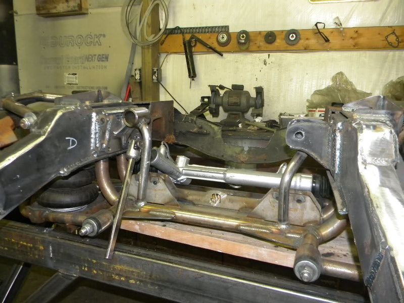

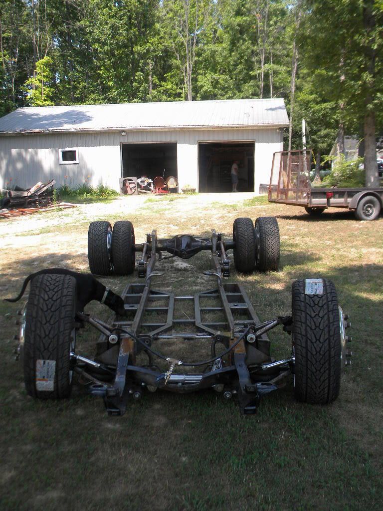

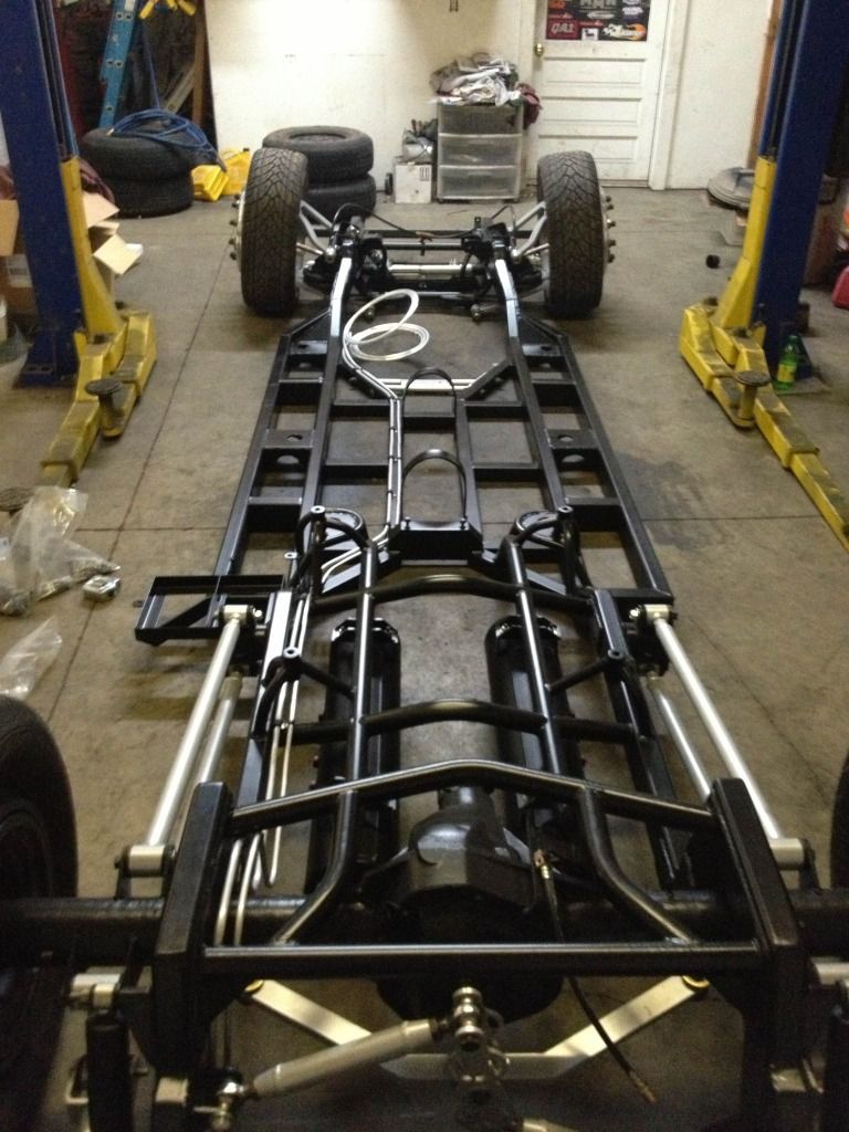

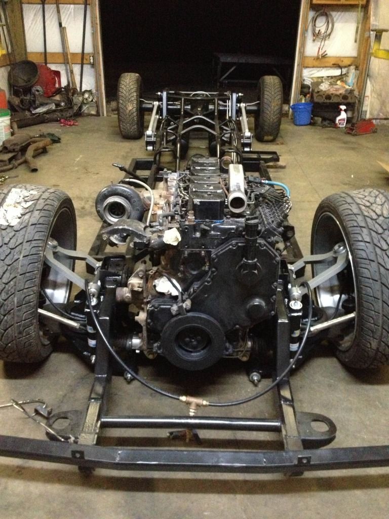

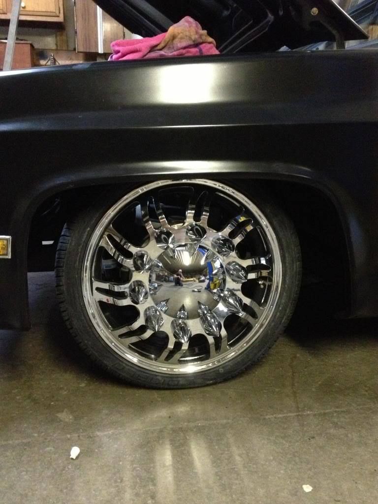

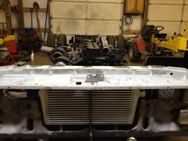

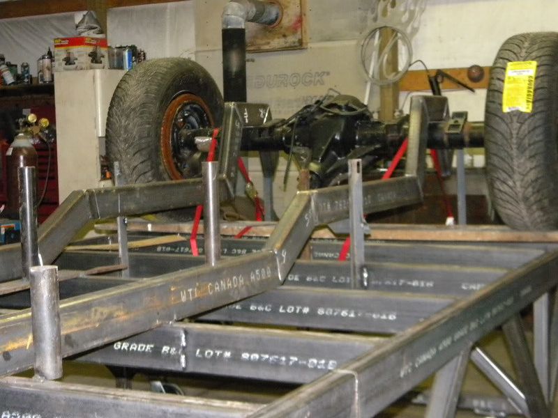

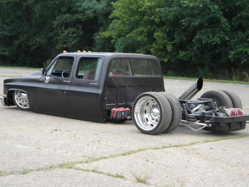

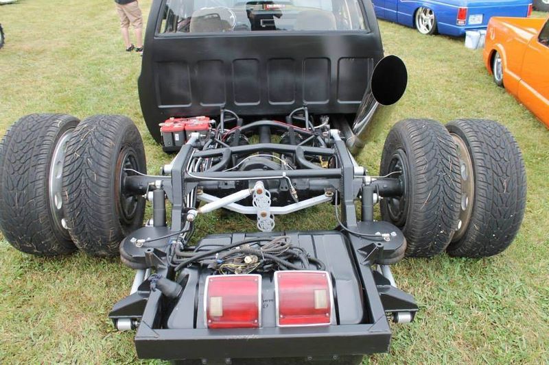

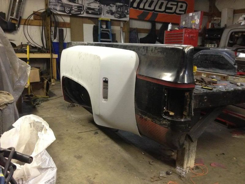

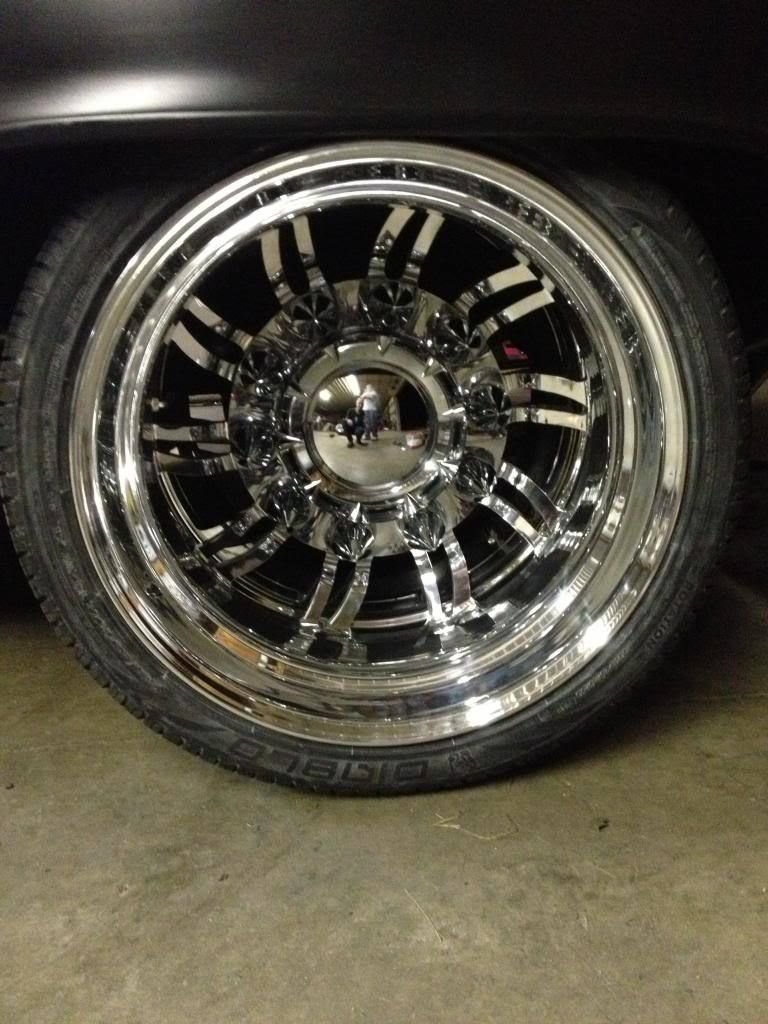

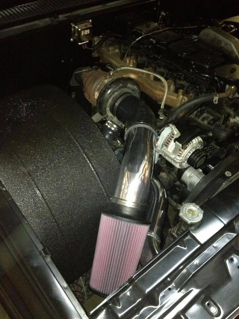

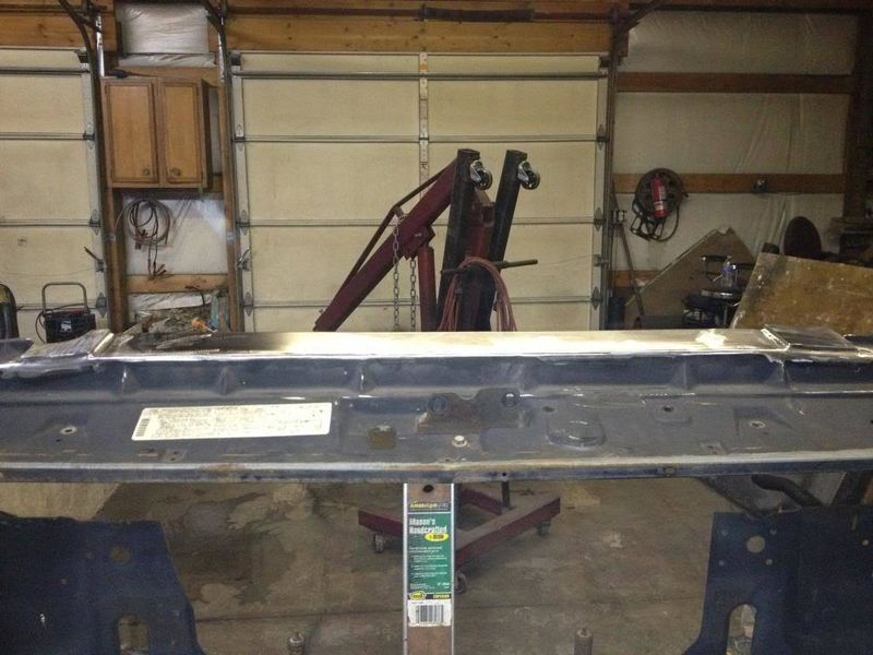

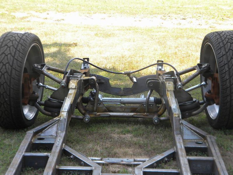

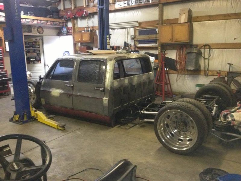

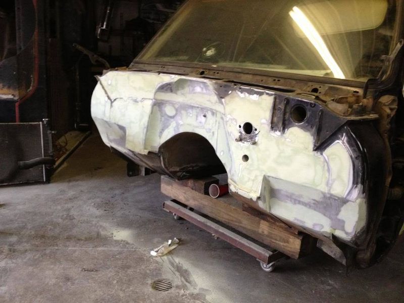

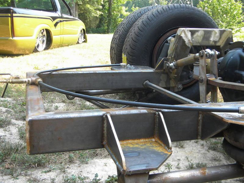

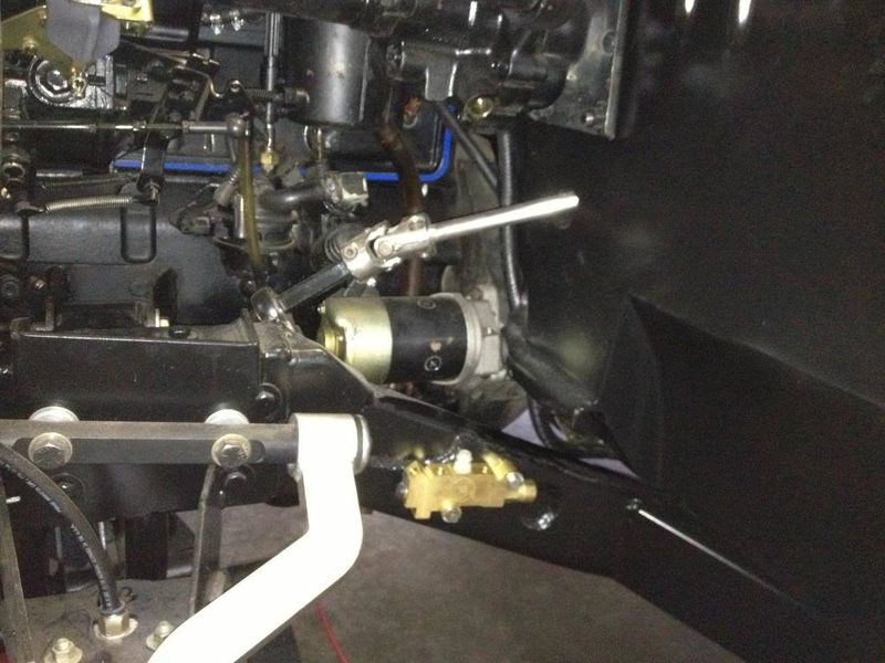

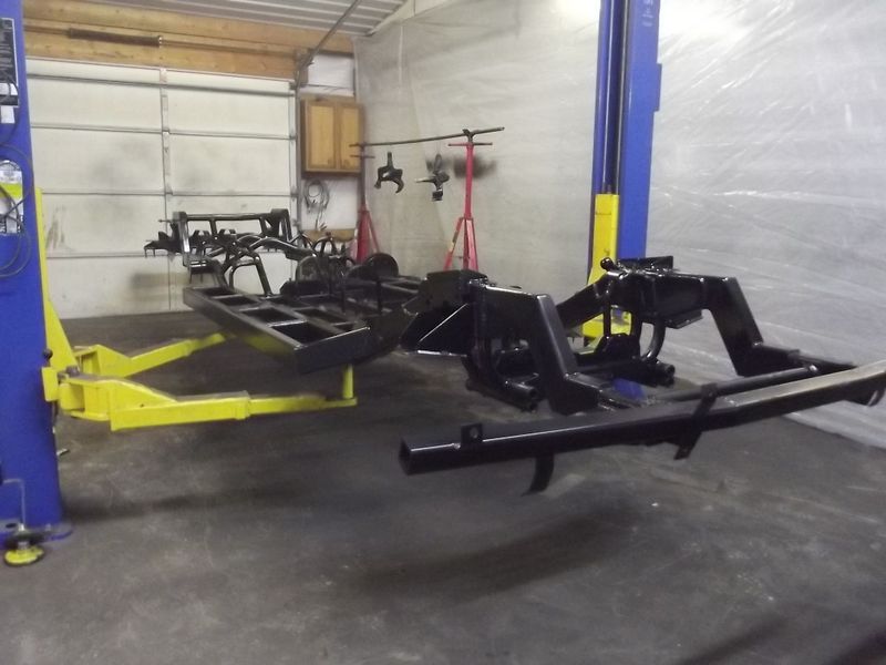

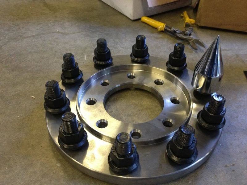

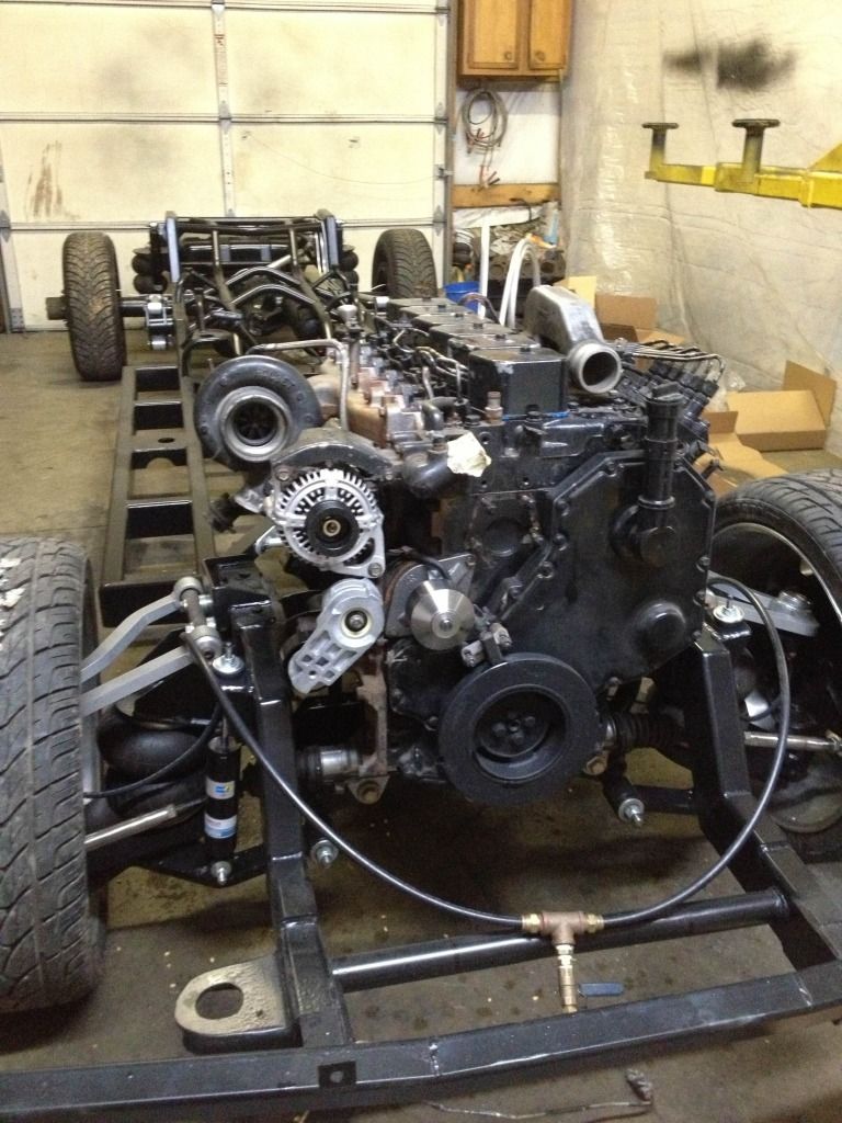

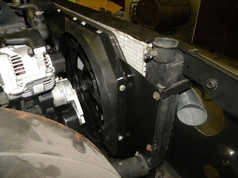

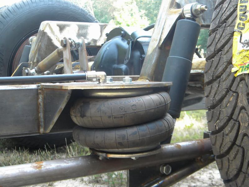

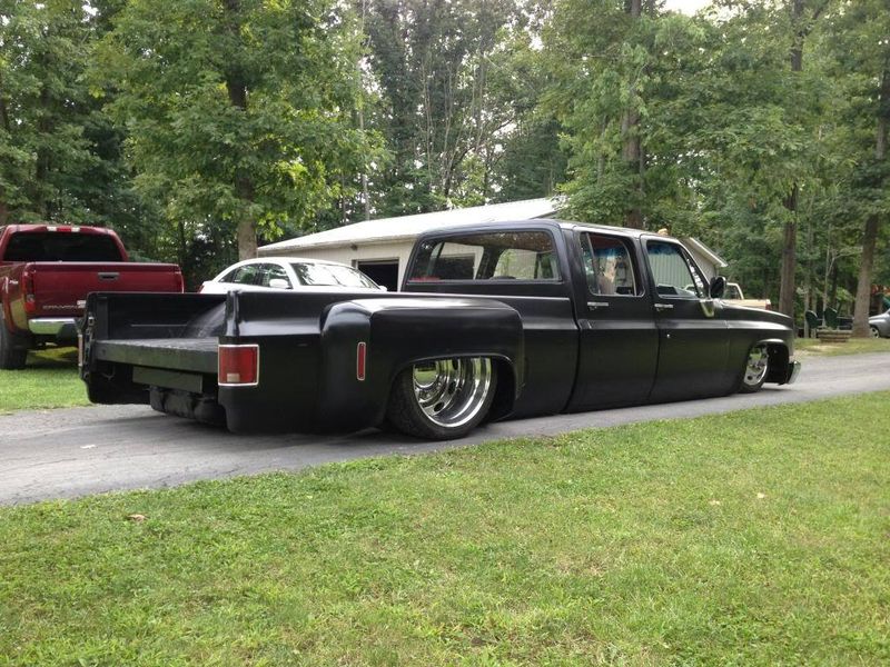

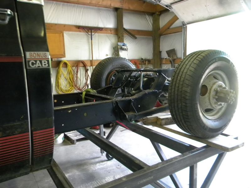

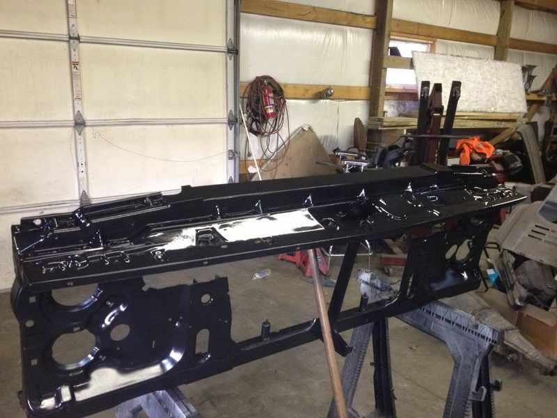

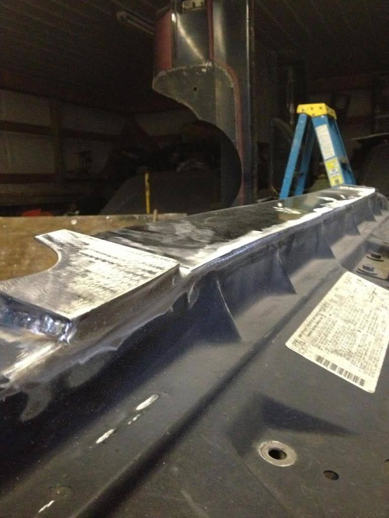

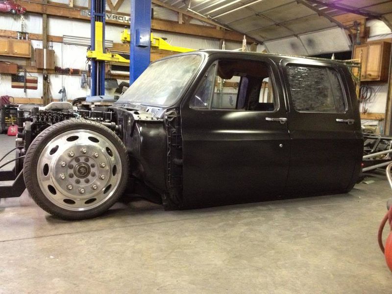

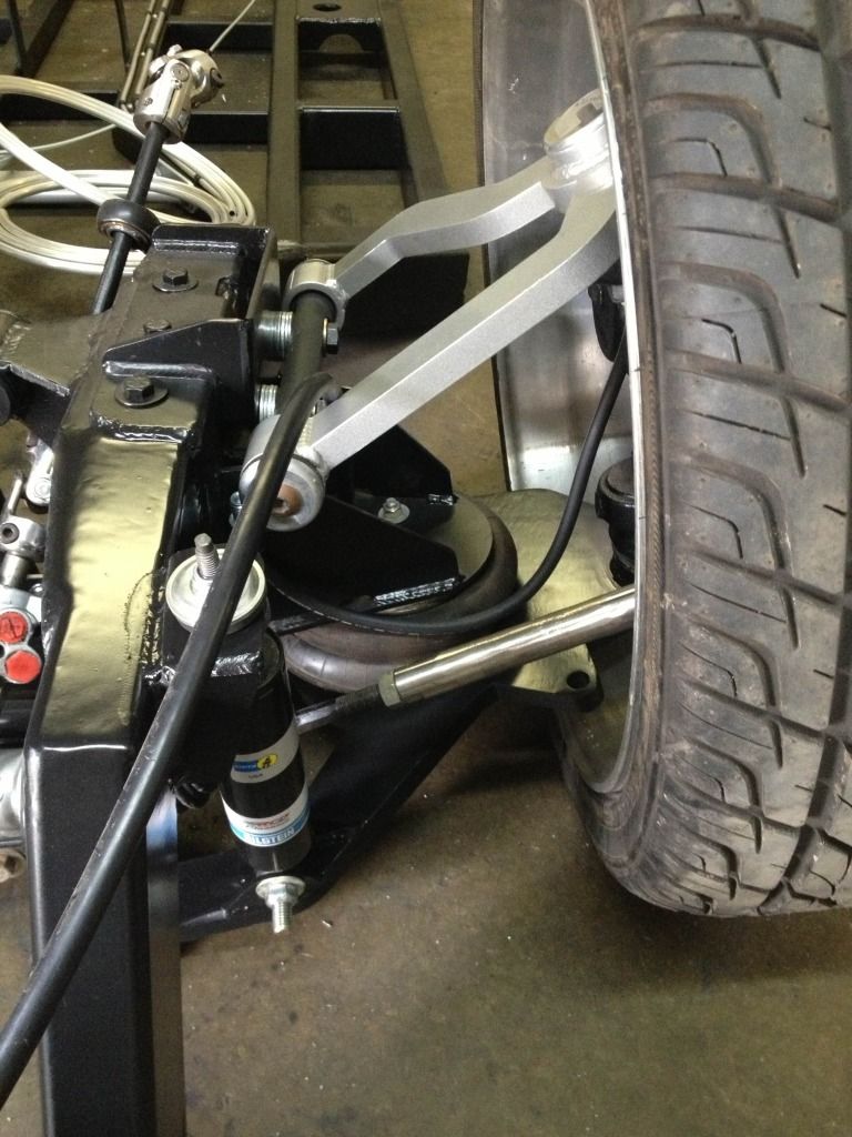

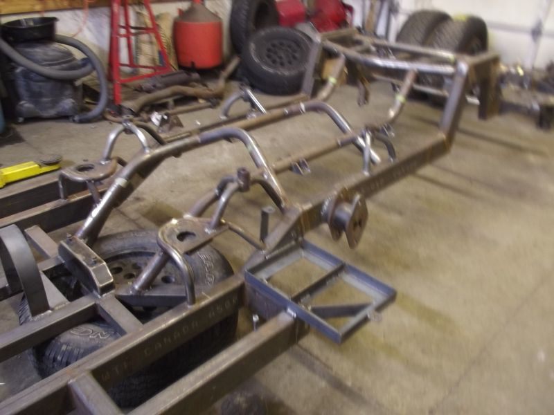

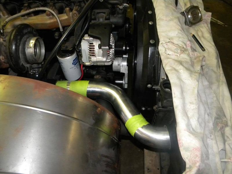

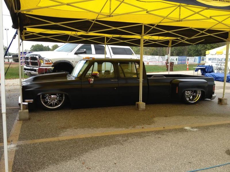

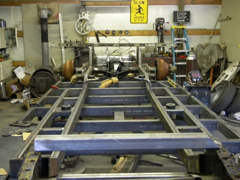

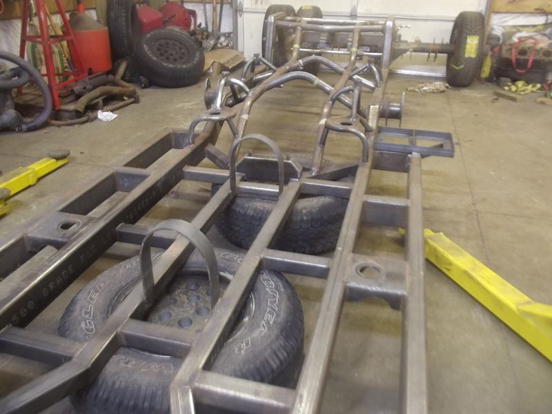

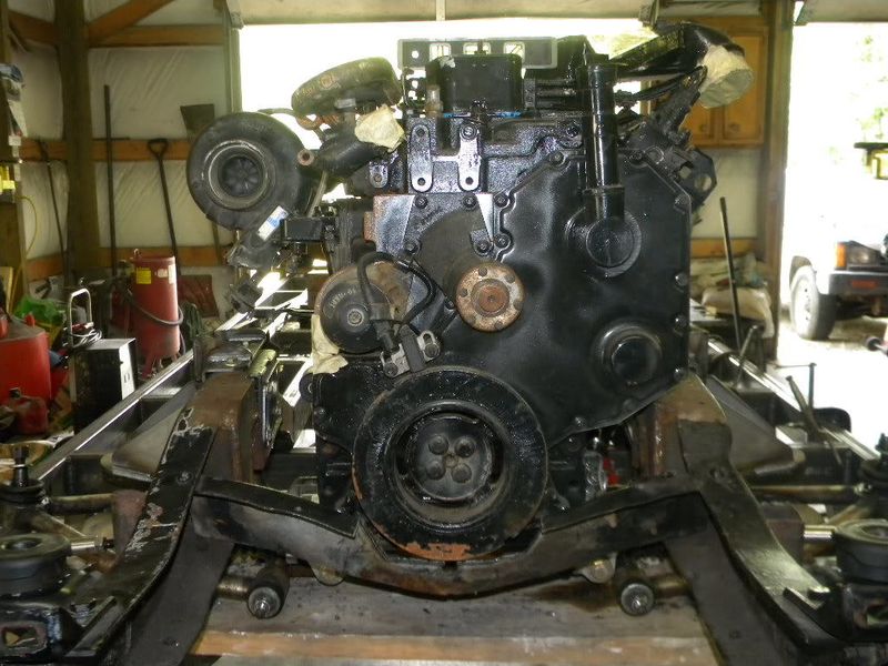

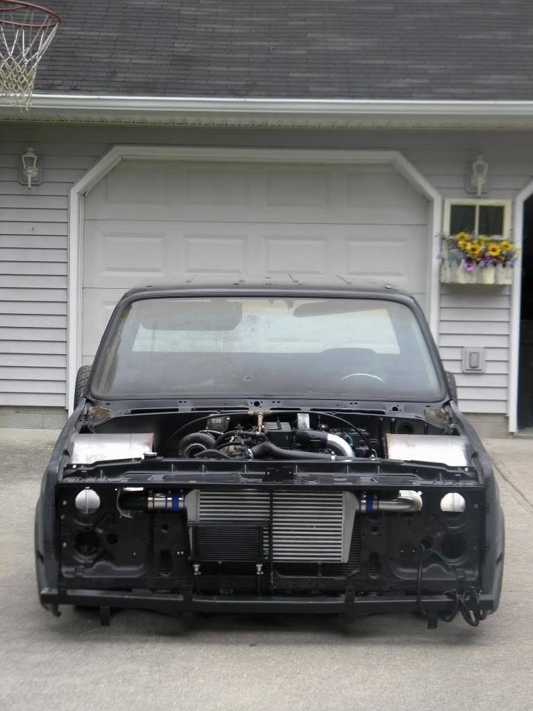

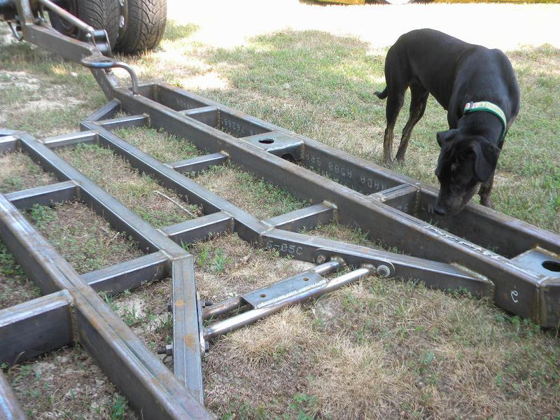

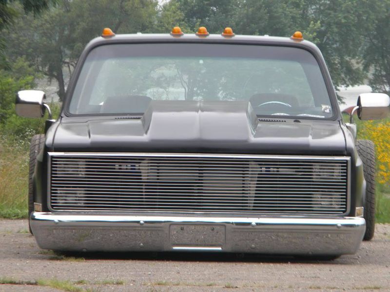

this is a truck i been working on for 2 months now i got brought to me from texas. im not good at explaining so i will just post pics of what i have done so far and i will answer any questions or critiques. this is my first dually build

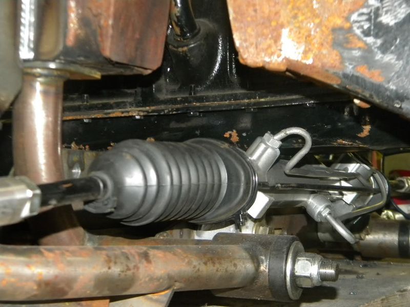

Damn that's a lotta nice work, rack & pinion and all. More pics/details!

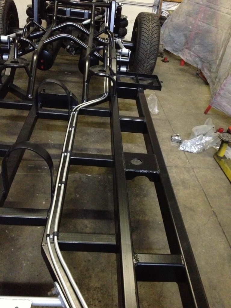

How heavy you figure that frame is and what wall thickness did you go on the box tube?

Badass build...where in ohio are you ?
BD
bagged dually

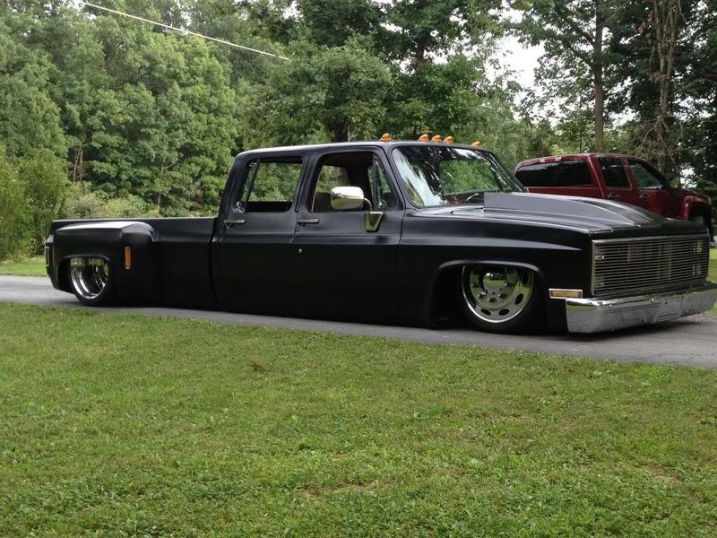

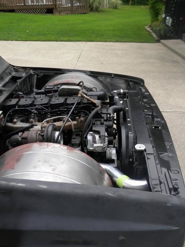

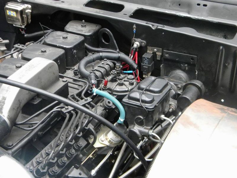

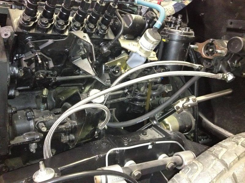

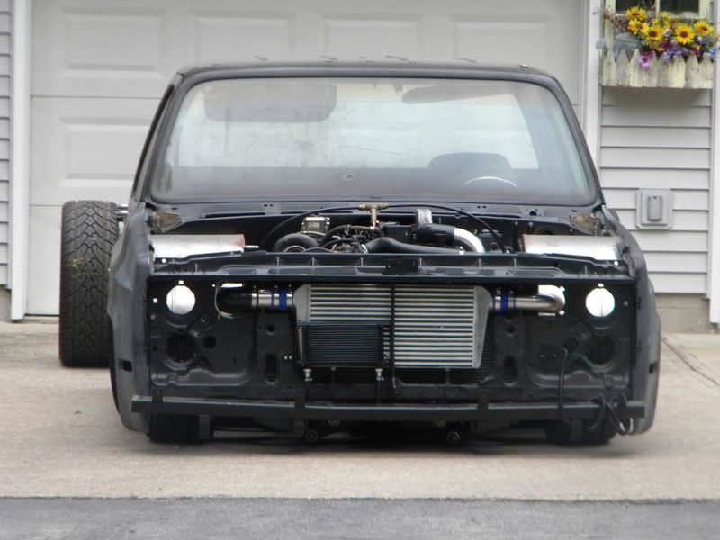

Damn man that thing is sick!! What year cummins??

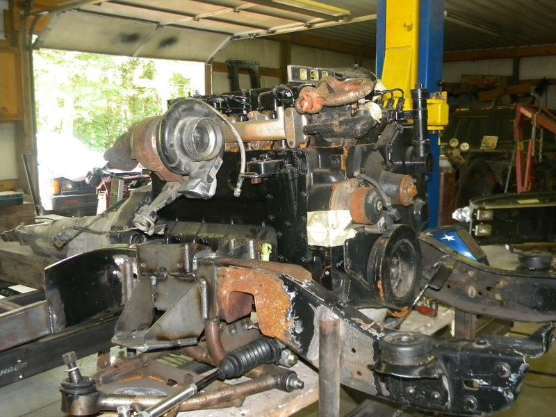

What engine mounts are you using on the cummins?? Did you retain the stock dodge mounts or fab some??
I'm in the process of doing the same thing and have been scratching my head as to what piece to use to fab the mounts.

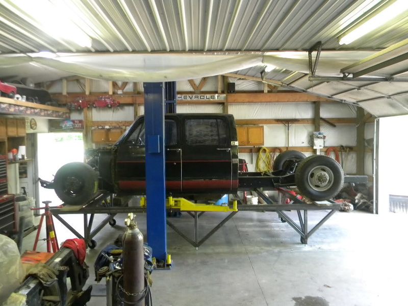

Some nice work there and I love the shop man just a regular joe in the home garage showing some skilz!
