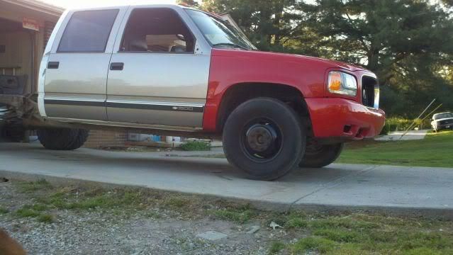

so from the bed side to the outside of the fender is 13", and the length of the front of the fender is 26" to the wheel well opening and the rear is 22" to the wheel well opening.
I have a question, does anyone know how much wider semi wheels are actually the regular wheels? because right now both tires on one side of my dually run 19" wide and since i dont have my wheels on my truck im kinda worried i didnt stretch them enough hahahah :O
