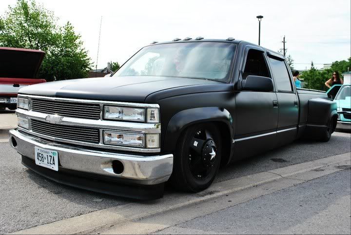

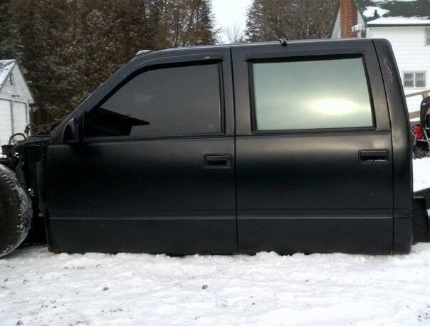

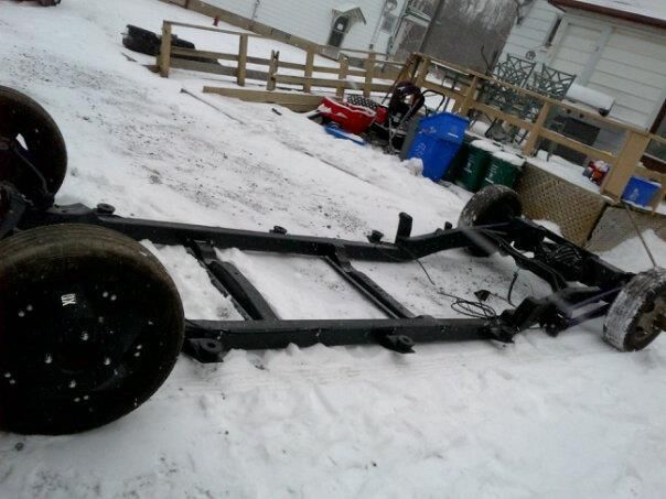

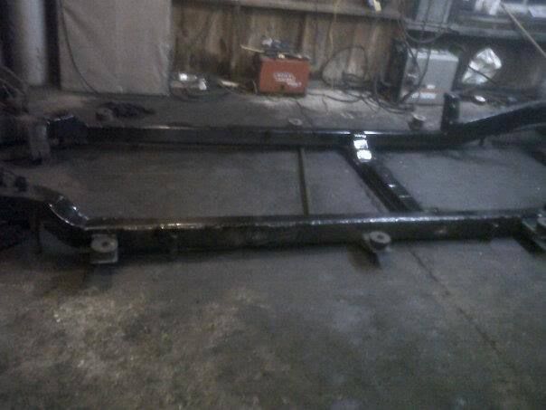

hey guys i have been lurking on this forum for a while but finaly decided to post

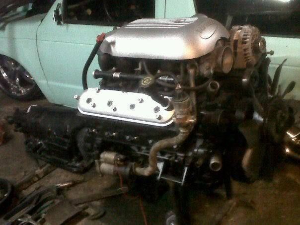

I have a 93 shev dually that is currently laying fame. I did just pull the motor to install a 6.0 liter and in the midst of all this i am going to start a stfbd. I do have a few questions tho
1 what size tube is everyone using for new frame rails?
2 what is the actual number i need to drop it...3.5"?
heres a few pics of it and my other toys

I used 2x4 1/4 wall tubing on my truck....but mine is a different bodystyle...just measure how far your rockers are off the ground....I went 4 inches with mine cause I wanted it past the pinch

I am thinking of doing 3x3x1/4...nmaybe even 3/8

have u had any concerns of flex?
comegetsome's avatar
comegetsome
mine hasn't flexed any....the 2x4 is stronger than the stock frame cause its boxed and thicker than the stock framerails....just add your crossmembers back in
