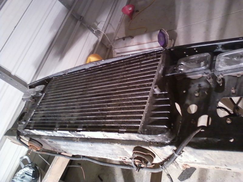

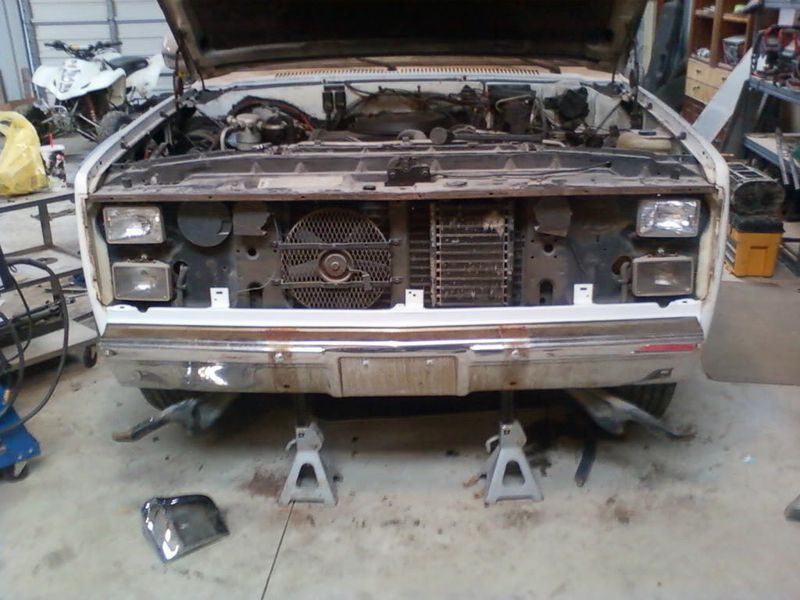

Update ......working on modifing the new quad lamp core support for the intercooler(cummins swap) Wanted to run it on the out side of the support, not enuff room it interferes with the turn sgnal housing. So now im gonna start the cutting to get it on the inside.

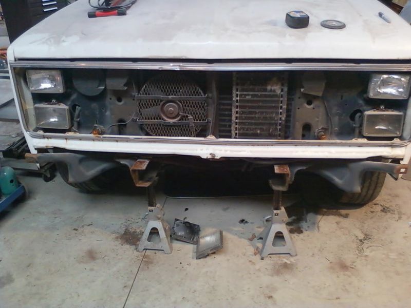

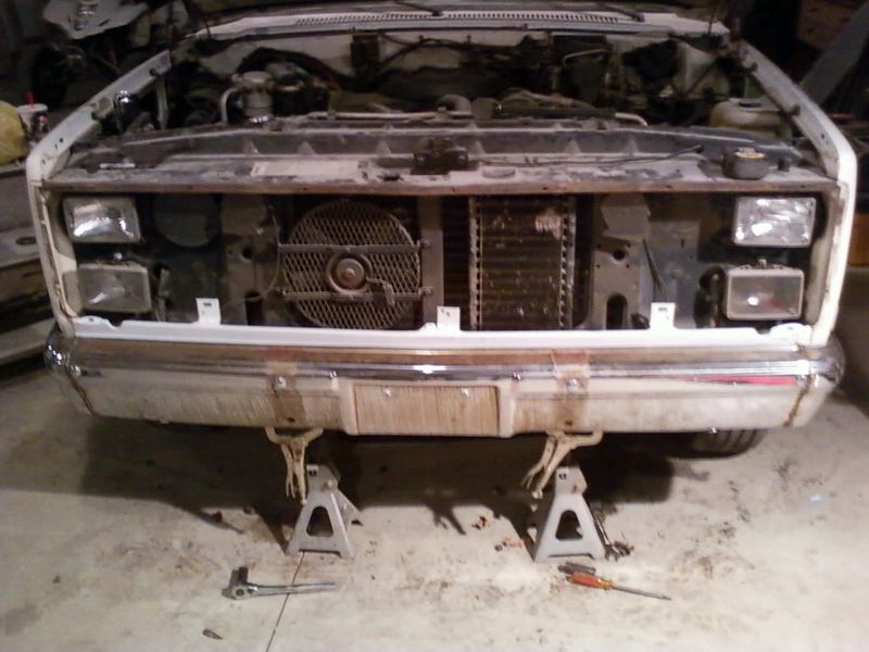

Ok guys .....finally got some time to do some work on her for a couple hours to night been busy with work.

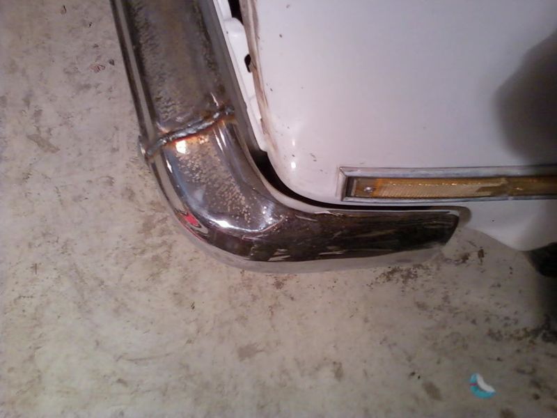

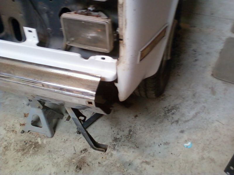

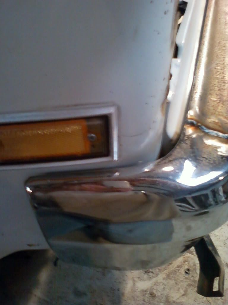

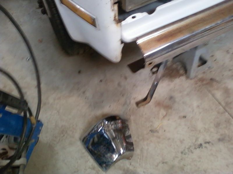

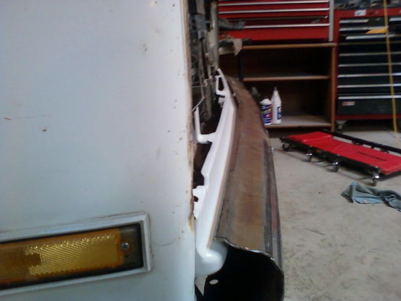

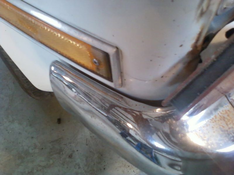

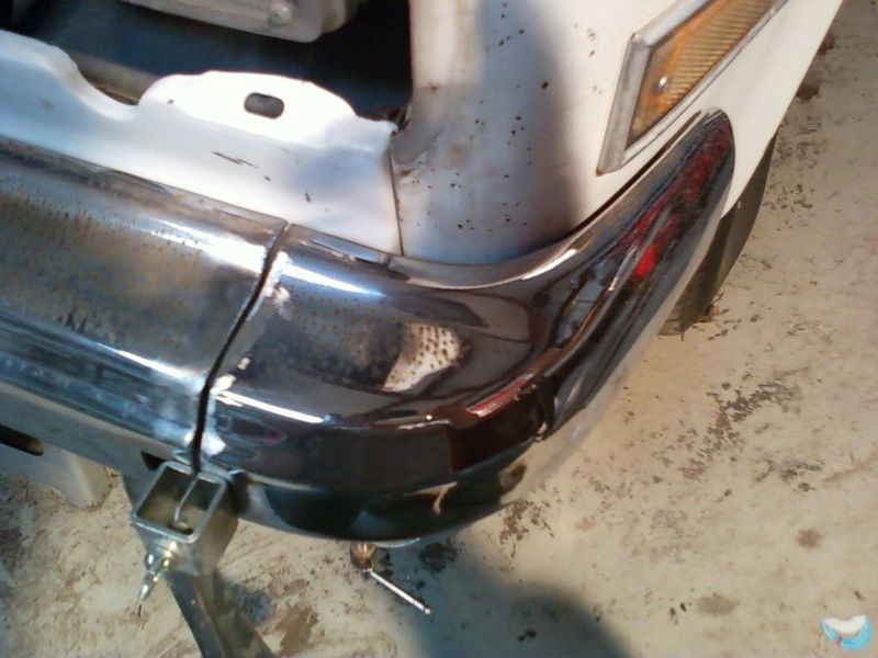

the break down, ai am waiting on my core suport to get back from the blaster to finish the suburban front end install. So while waiting on that i decided to section the bumper and move it tighter to the body.
stock bumper gap (maybe its alittle wide bumpers not bolted to the frame)
new gap

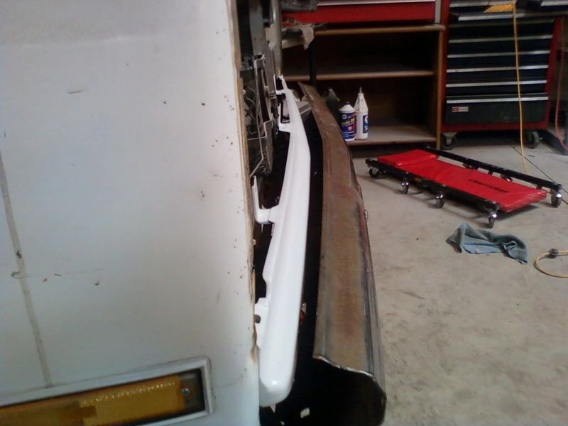

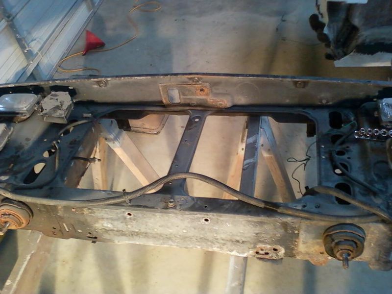

Also removed the inner fender wells in preparation of pocketing the lower control arms
heres a shot of the brackets all bolted up to the bumper and clamped to the frame

Thanks guys the bumper was a spur of the moment thing lol........

i need the 89-91 suburban/blazer quad head light core suport
like this one minus the innercooler lmao
