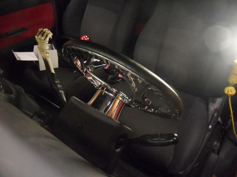

did my pic not show up of what wheel I will be using?
someotherguy's avatar
someotherguy
That is a Billet Specialties wheel, and it sure looks like their hub, too.

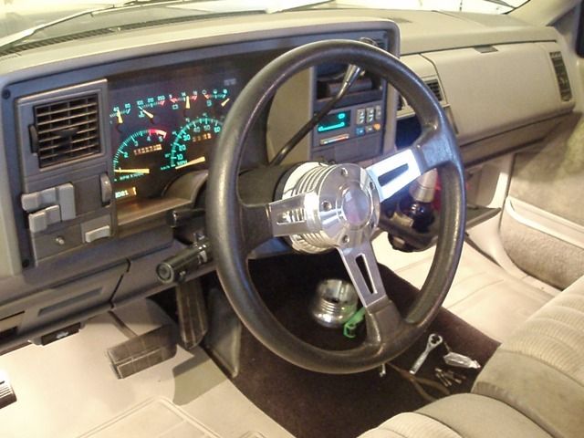

Here's a Grant billet hub - completely different.
Richard

I dont think its a billet specialties wheel that I have, its a no name I think.
