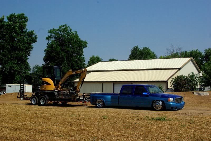

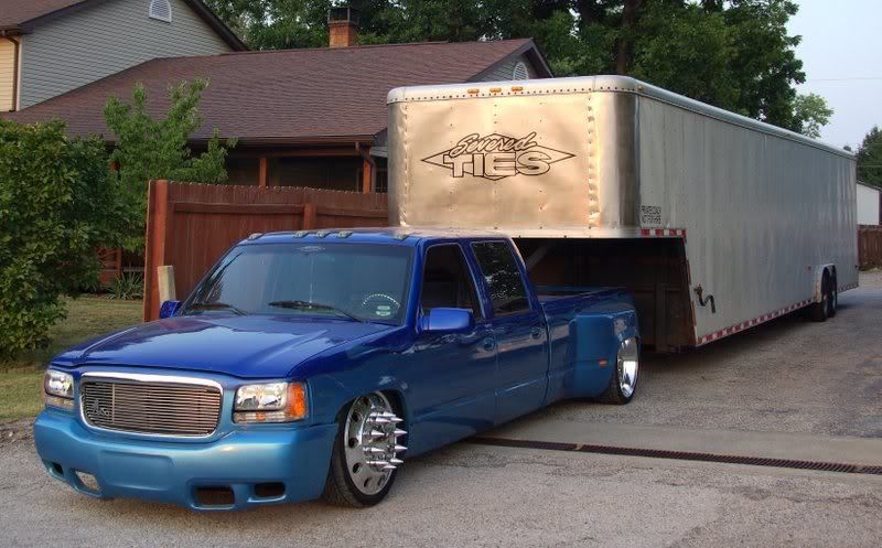

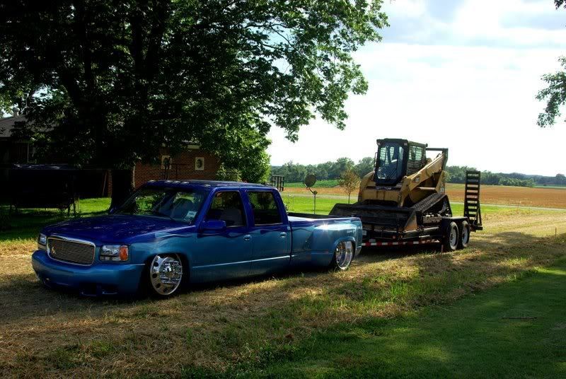

here are a few pics of how i work my tow pig and the susp. setup work flawlessly! DO IT SAFE AND HAPPY HAULING!

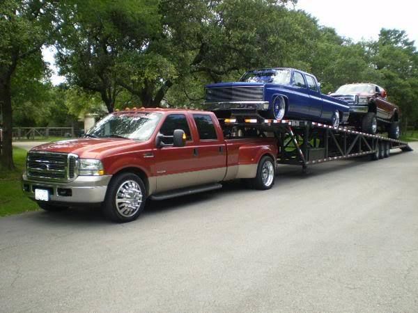

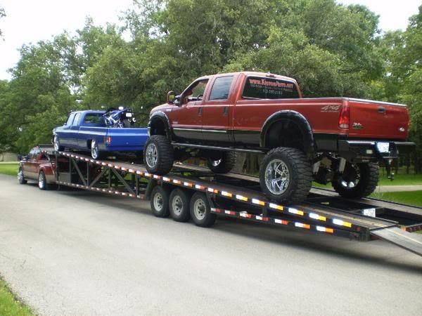

Here is my .02 If your going to do any kind of heavy hauling put the bags over the axle, I have seen those two link bars bend and even brake. As far as the ride quality I like the way mine rides. I used to run a steel inner but was wearing thru tires too fast. Your not ever going to get exact but real close as far as the same tire size as the 22. I used to haul with the steel inner and never had a problem. IMO if you want to do it right run the same size wheels and tires all the way around and put the bags over the axle. Here is a picture of when I hauled my other truck around, I hadn't c-nothed the frame yet but my bags were over the axle.

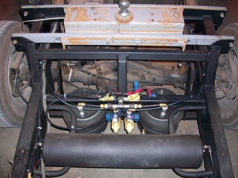

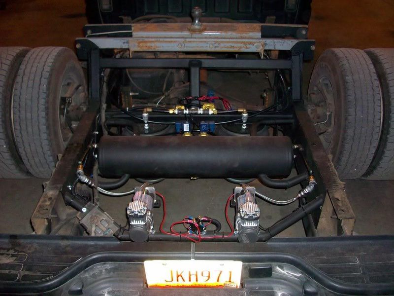

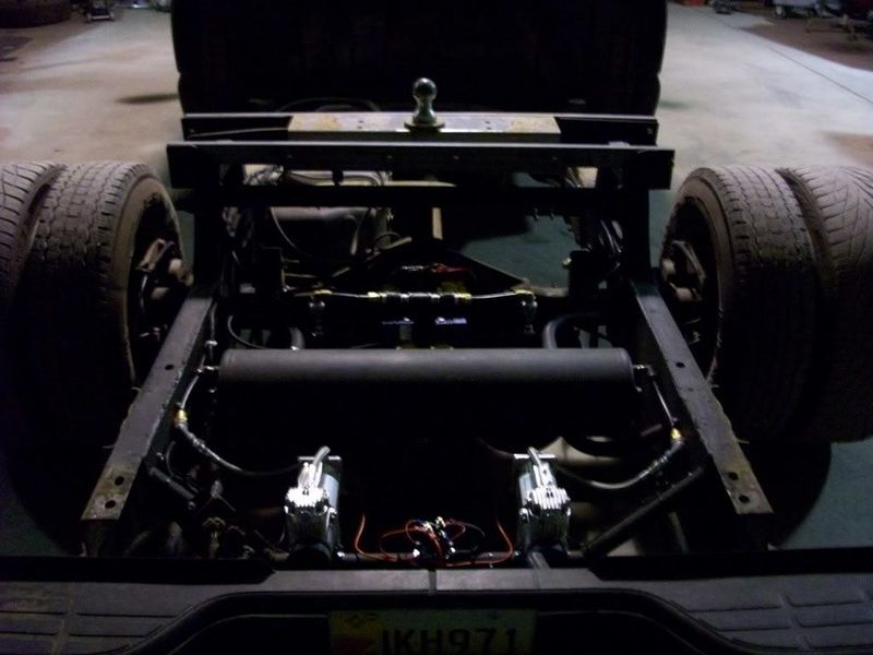

here is my rear setup to tow. just no chicks.........................
i have goodyear 2b12_406 semi bags in the rear. 2 linked and a bar that ties the 2 links together and extra brackets that go to the axel to destribute the weight from the 2 link to the axel. everything is 1/4 thick. mines a 07. frames are a tad different.
