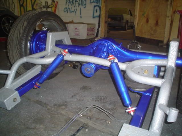

here a a quick sketch I drew as well as a pic of a 2 link I did on a Taco I built.
maz89
a it's so pretty! Nice work Nasty!!

low95xlt
damn drag thats tight

I realize I'm going to sound like a tool, but on a two link, how do you keep your rear end from shifting side to side? Panhard bar? Or would that make it a three link?
dragnasty's avatar
dragnasty
Most people run panhard bars but the new way of doing it is the run a cross link from the front of one of the two link bars the the rear of the other two link bar. Kind of like a Z link. I fully weld the rear end to the link bars making the rear end housing the actual cross brace.
