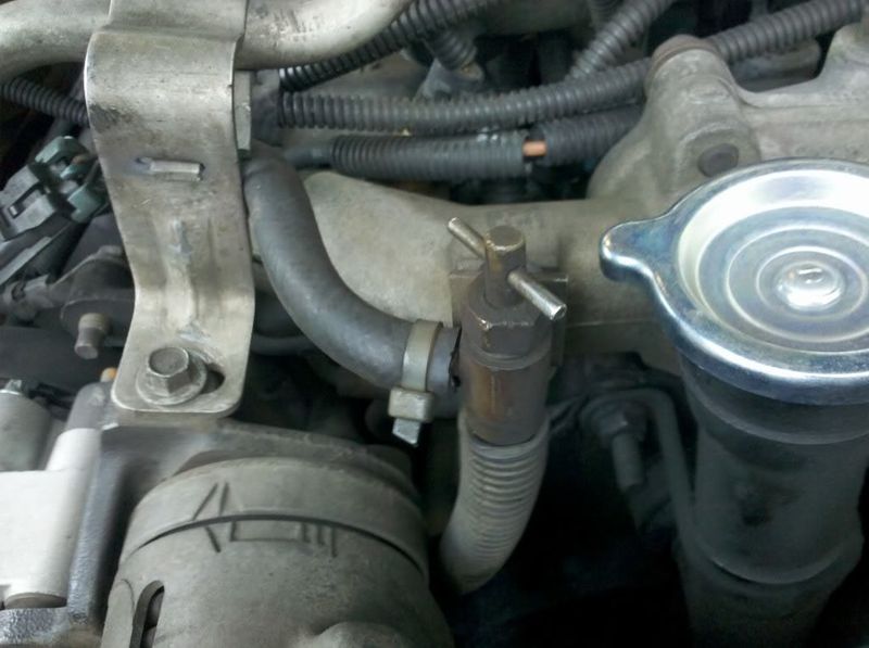

Total noob to diesels, what does this goto/do?
someotherguy's avatar
someotherguy
That is probably the bleeder valve for the fuel system. Not much of a diesel guy so I'm taking a wild-ass guess here.
You would use it to bleed off pressure before replacing the filter, or for getting air out after replacing the filter or running out of fuel.

comegetsome's avatar
comegetsome
looks like a valve we run on our tractors....plumbed into coolant hoses to turn water flow off to heater core in the summer months when its not needed....but without seeing where the other end of the hoses go i cant tell ya for sure....so just a guess also
someotherguy
I'm betting that hose off to the passenger side is just sitting there, right? If you turn that valve have a container over the end of the hose, betcha diesel comes out.

Apparently it's a water-drain off petcock
you can see if there's any water collected in your fuel. It also serves a purpose in checking your lift pump, with engine running open petcock all the way making sure you have something to drain fuel into(like a 1 gallon or bigger jug), if the engine changes idle speed or goes dead it means your lift pump(fuel pump) is going out.
