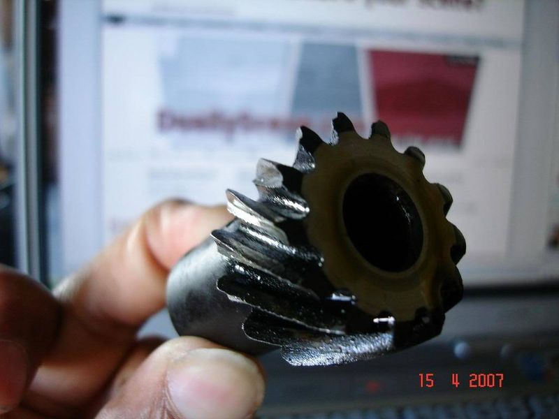

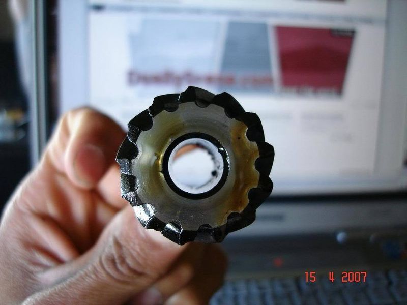

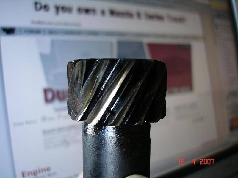

well this is how it goes I got drunk and had a wild hair in my A$$ about tha CEL so I popped the hood and started takin sh!t apart and when I got the distributor out right away <-(2 beers later) notice that the gear looked like this
V V V V V V V V -----------------------------------------------V V V V V V V V V
I think that after about 2-3 more 30packs I will get to the bottom of the P1345
btw from what I can tell the cam is ok........

I replaced one of those gears years ago on my 74 fleetside, (back in the 80s.)
I made a mistake and put the dam gear upside down
i think the beers did it.
well to make a long story short, the dist wouldnt drop back in all the way,was about 1/2 inch from flush...found it after looking at another dist..
