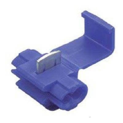

mazdatweaker_2
Is there a chance you are using "scotchlock" connectors to tie into the truck wiring harness? I have had really iffy performance out of them anytime I have tried to use them. If you have a test light, you should be able to ground it and stick the pointy end into the wires to see if they are getting electricity from the truck harness.
Cusser's avatar
Cusser
I would never use those, even for a stereo connection; I've seen those in some kits. I always solder trailer or stereo wires.
