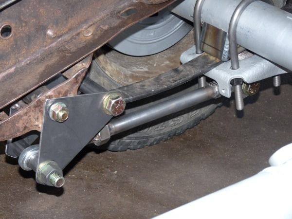

I'm going to use 4" lowering blocks and starting thinking about a cure for axle wrap. Would it be possible to use parts from a 4 link kit to weld from the axle to a point on the frame to help cure axle wrap. I don't know if that's even possible. I'm just throwing this out there for answers. The reason I'm using 4" blocks is because I use my truck to haul things and don't want to mono leaf it because of that and didn't really want to use air shocks for the rear when using mono leaf. I just want to keep it really simple. Thanks for the input
