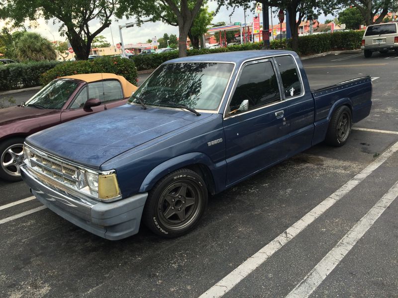

Papo The B2200's avatar
Papo The B2200
Here's a pic of the truck before I left the parking lot.

Then your first step is to look. Nobody can help without knowing how it was dropped.
Papo The B2200
Looked, there's no blocks.. But I noticed welds on my leaf springs, & the brackets they're on.
Looked at a service manual I found online, looks I'm supposed to have 5 leaf springs on each side whereas I only have 2.
Looks like I'm on the stock shocks, so I might use the hijackers shocks so I can adjust the height whenever it's necessary.
