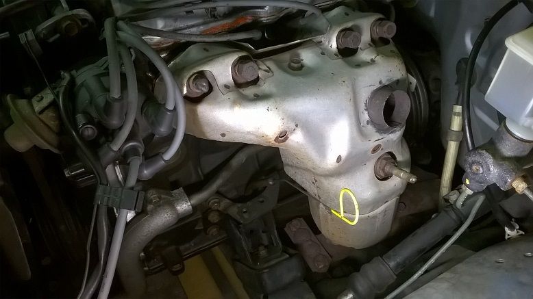

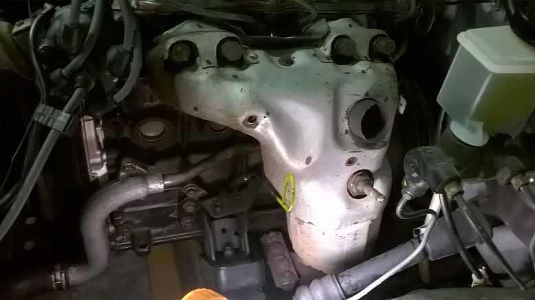

here's a few older pics of mine before i put my header on.. might help you out??
Dogfather's avatar
Dogfather
Thanks, customkev89! It's reverse setup from what I have (81 B2000) but I've got a similar layout. I have removed the line off exhaust manifold (that sucker was on tight!) and will block off for now. Now to get my hands on a saws-all and take that exhaust off! What kind of exhaust are you running? I'm looking into a cherry bomb or other glass pack.
customkev89's avatar
customkev89
honestly its a stock replacement type (quiet muffler) nothing special really,.. im going to bag it soon and all i was worried about was raising the exhaust above the frame to keep it from dragging.... i did install a small hotrod catalytic converter on it also, to keep that dang EPA! off my back lol but if you want more of that rumble sounding exhaust cherry bomb or glass packs should do just that
