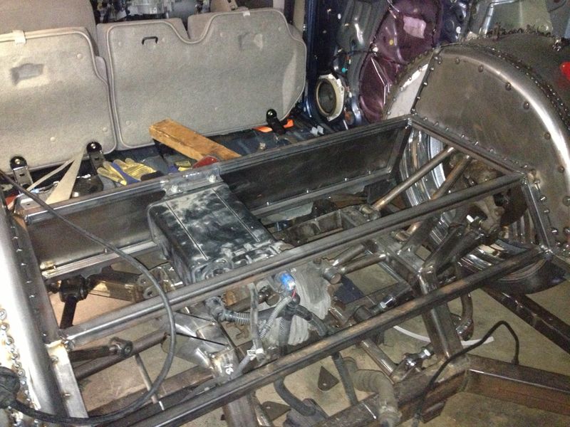

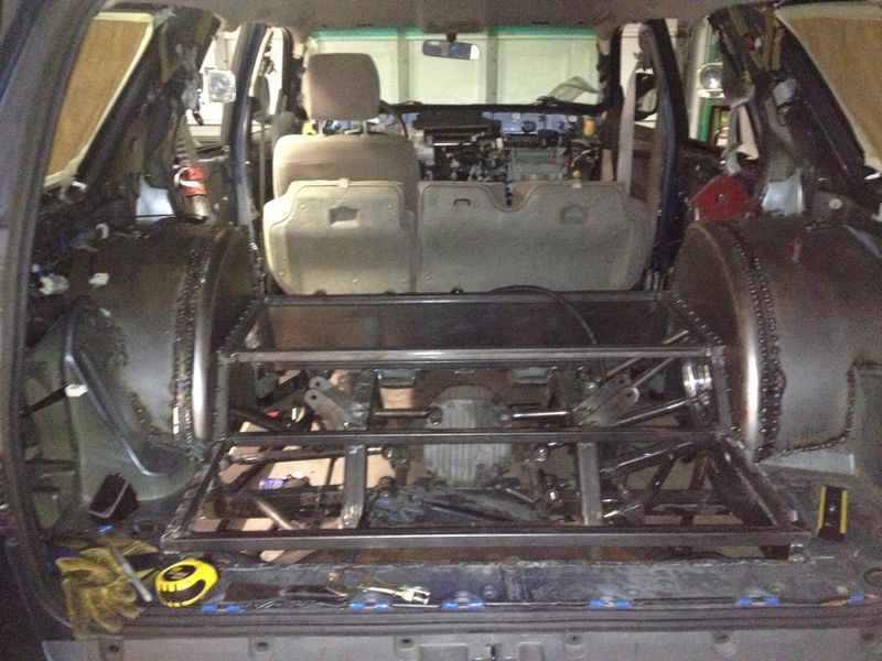

Originally posted by STATUSPITS
Thats gonna look sick when its done.

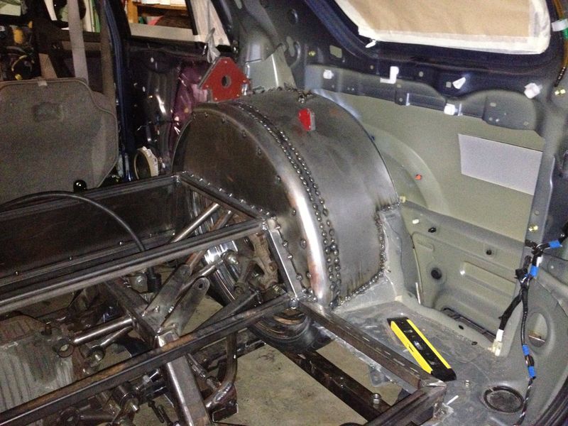

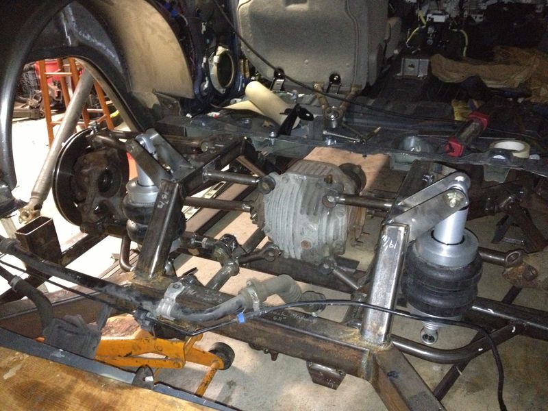

Arent the rear upper arms supposed to be triangulated?
nope stock arms are a single arm.....no need for is if the bottom takes care of the triangulation...also the rear wheels dont steer so there is no need for triangulation.
bmini94
well actually that is kind of a false statement. Due the the material that the stock arms are made out of they dont need to be triangulated and wont twist. But round bars are horrible agianst twisting force. Many people who use the tbird or mark8 rears do not triangle the uppers when the really should be
STATUSPITS's avatar
STATUSPITS
Yea it looks like the spindle would want to rotate during heavy acceleration or breaking.
bmini94
thats why mine is getting built triangulated and with antidive
e10pvmt's avatar
e10pvmt
the arms are a direct copy (just shorter) of a company here in orlando that builds bolt in kits for high horsepower camaros and mustangs....they dont triangulate theirs and there isnt any need to do it to mine....it wont rotate except for slight twisting in the bushing at most.....numerous people have done it this way...its a stock 4runner engine and i wont be running anything remotley close to being able to twist that tubing....as for the anit dive....after discussing it with max and this being a minitruck we agreed it wasnt necessary to have the stock anti dive built into the rear suspension....so i built the arms perpendicular to the frame....IMO it wasnt necessary in my application to do what i though would be overbuilding my frame

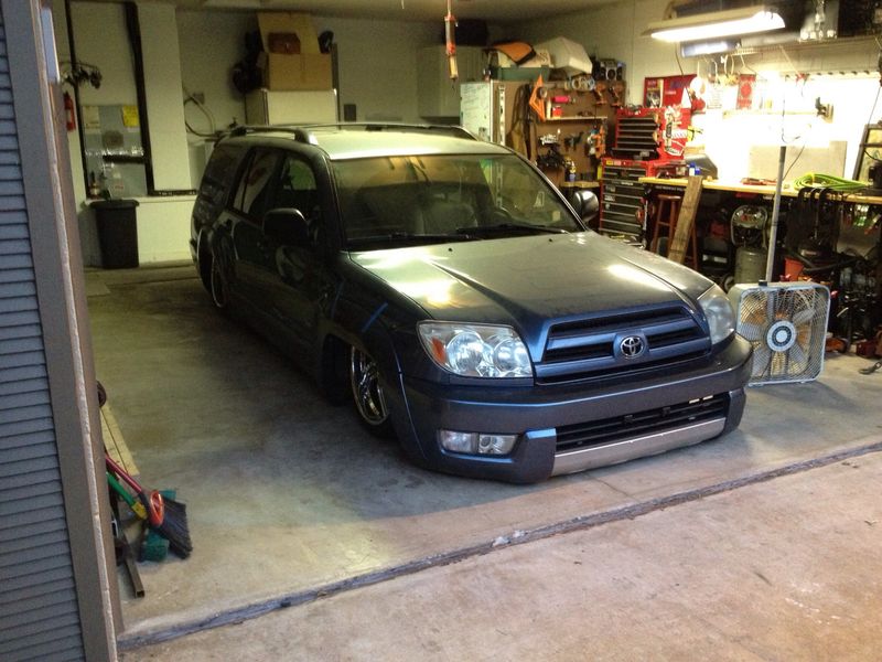

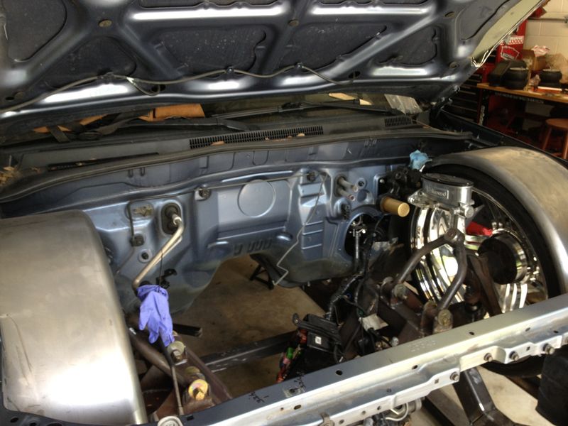

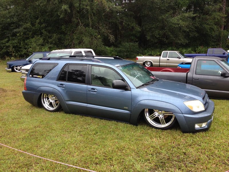

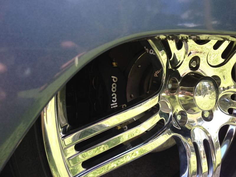

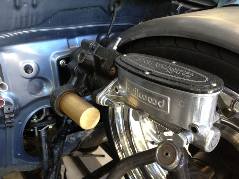

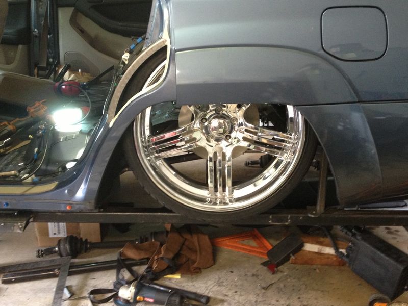

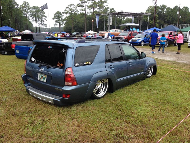

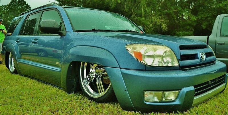

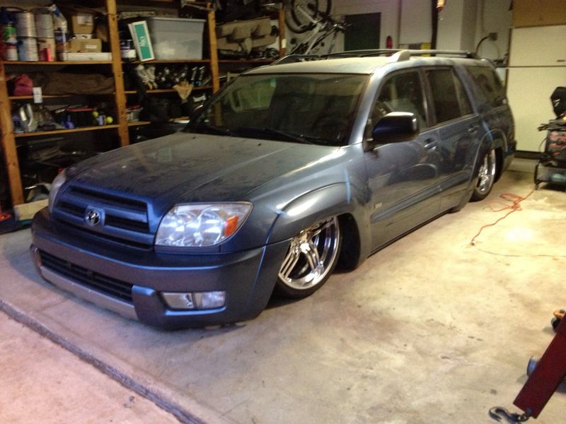

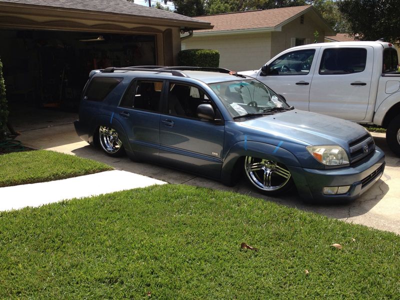

After 5 years of building and taking a break i finally was able to trailer this bitch to a show....i moved back to Orlando with nothing but a mostly finished chassis late last year....teardown began in january and after cutting the 4th version of my IFS off and attaching a new one custom built by Jimmy's Rod & Custom in Edgewater, FL i was finally able to have it at slamfest this past september. Still have a ton more to do but i hope to be driving it sometime next year after my wedding in March.
new specs are:
Full 2x3 chassis
Custom IFS on pretaco spindles
91 Supra IRS narrowed 2"
Wilwood brakes at all 4 corners
Shockwaves in the rear and slam re-7 up front
Still needs:
Drive shaft, fuel cell, axles, and a custom intake manifold to clear the hood
