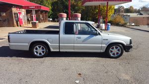

I just bought a mazda b 2200 and bleed the clutch. The clutch was hard to mash before and after bleeding it when i mash the clutc in i can put it in gear and nothing happens still rolls free even with truck turned on and in gear. Any ideas what might be causing this

I have had a few mazda trucks before never had one with a clutch pedal this hard to push i know its not right i bought a new slave cylinder to put on. The truck is like its outta gear cranked or off

I changed the slave cylinder and the truck started going into gear i guess the cylinder had it stuck
