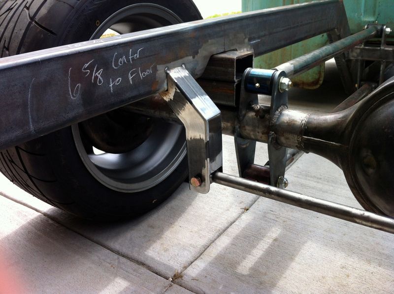

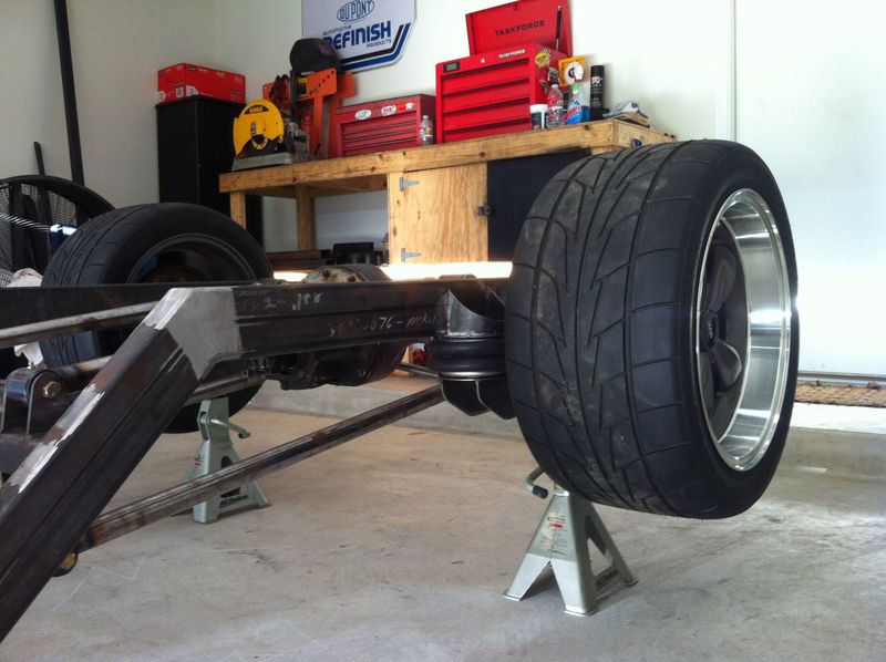

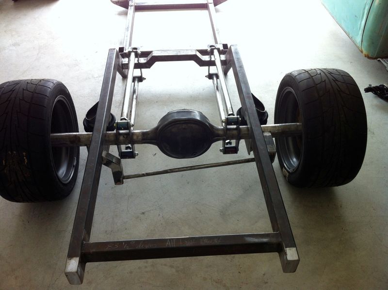

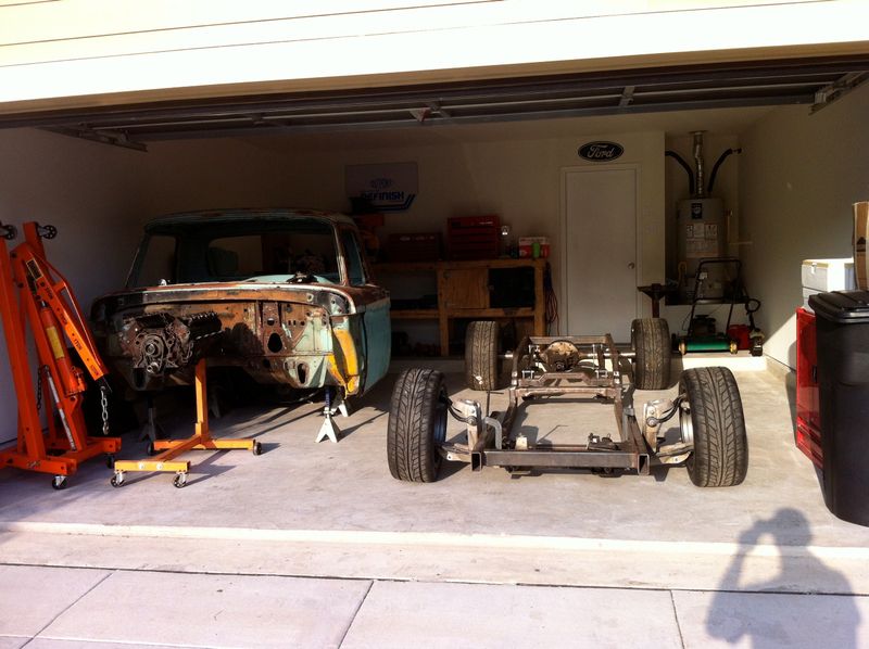

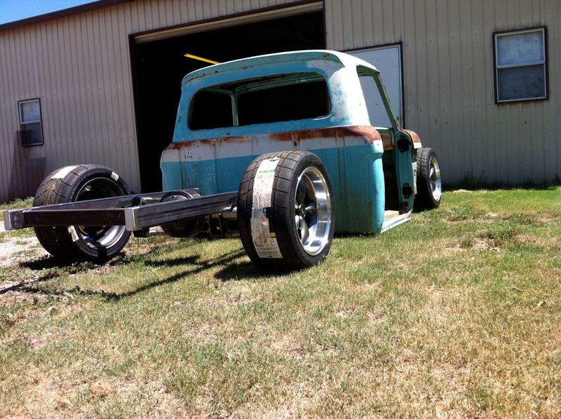

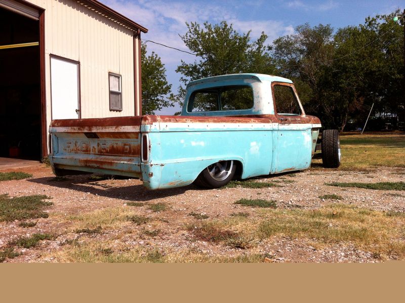

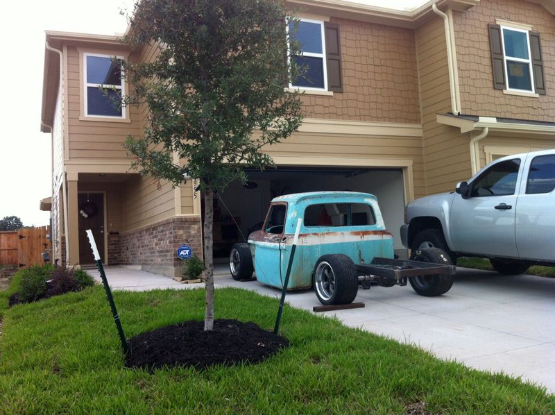

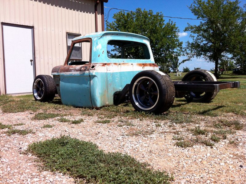

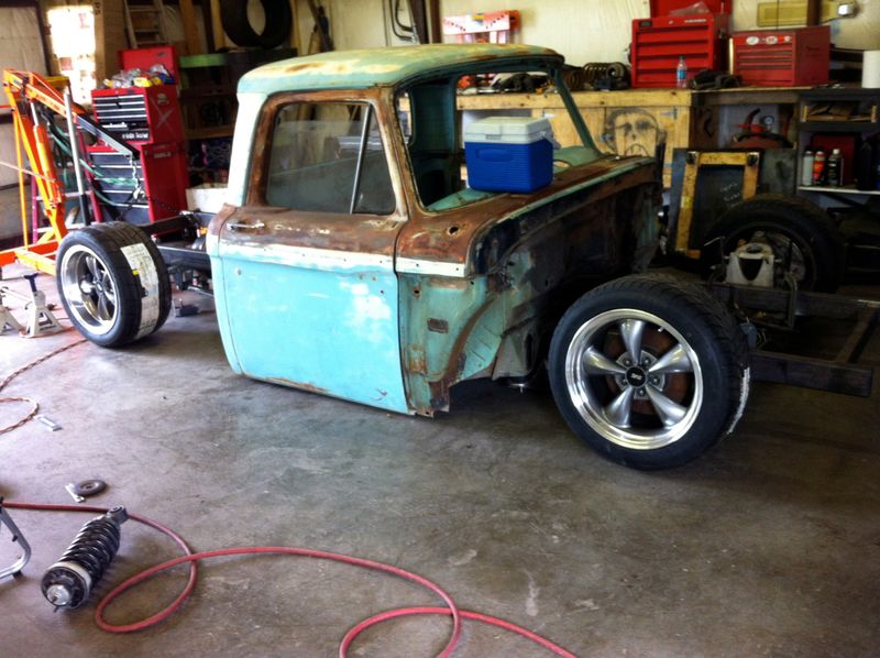

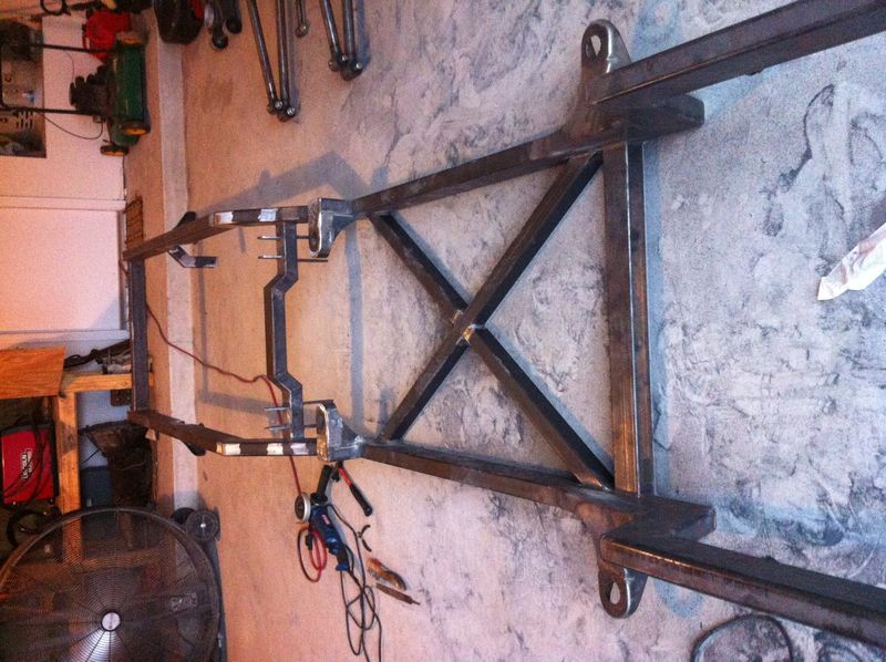

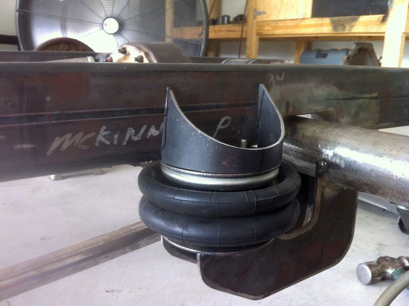

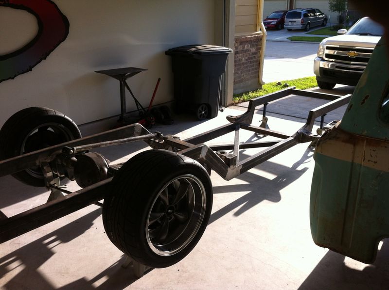

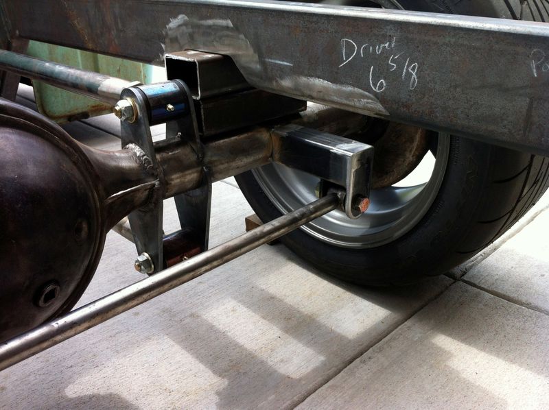

Looks good bud.. Snap some pics of the front and rear suspension for us...
Handbuiltf100
Handbuiltf100
Handbuiltf100
Handbuiltf100
Handbuiltf100

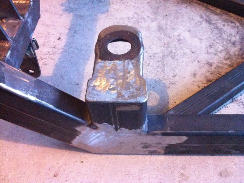

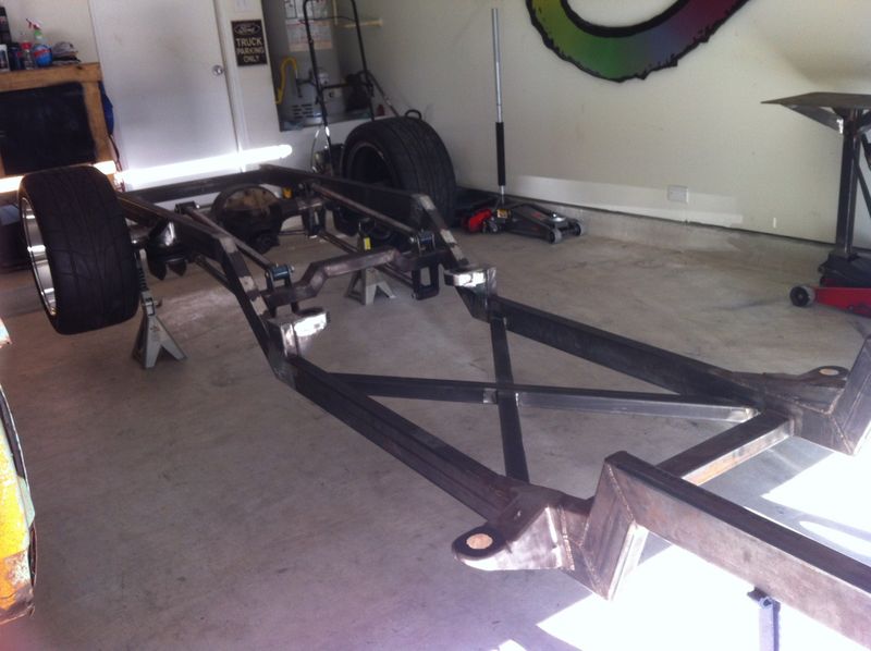

Front end is a 03 crown vic front crossmember, that i was gonna use but, the control arms arent gonna work to well with my frame and the track width is way to wide. Tryin to decide on a Mustang 2 crossmember for it, The goal is to have a narrow track width so i dont have to lift to turn as much, This is kinda a low budget build, I just moved into a new house so things are tight, im open to suggestions on the front end, and anything else for that matter

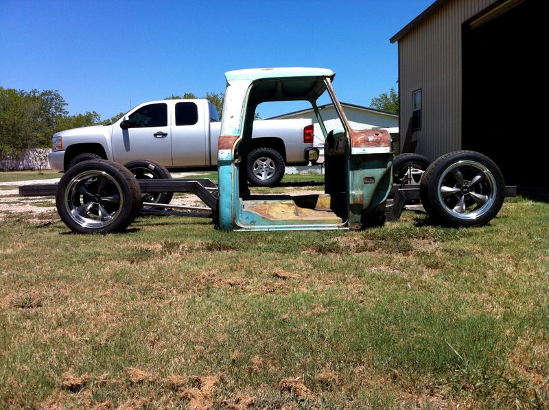

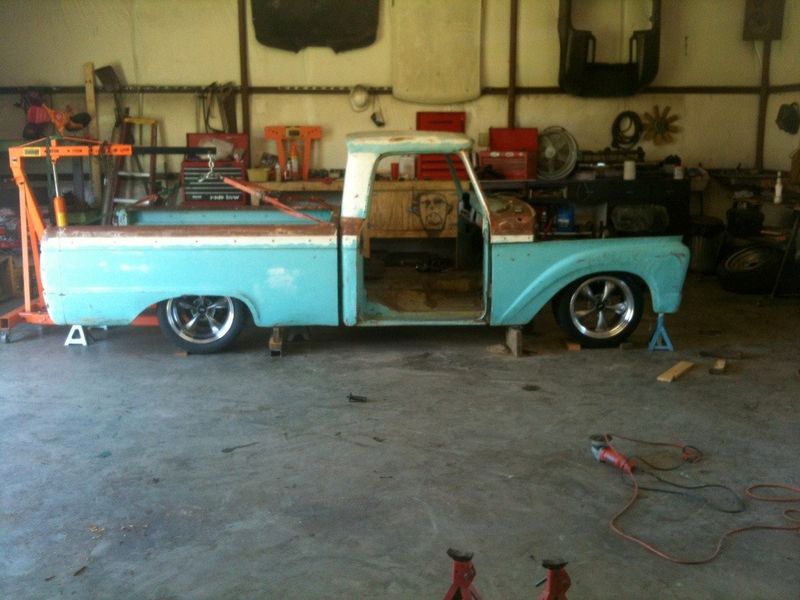

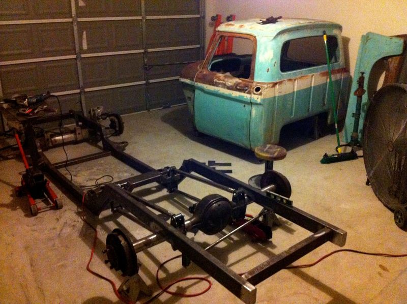

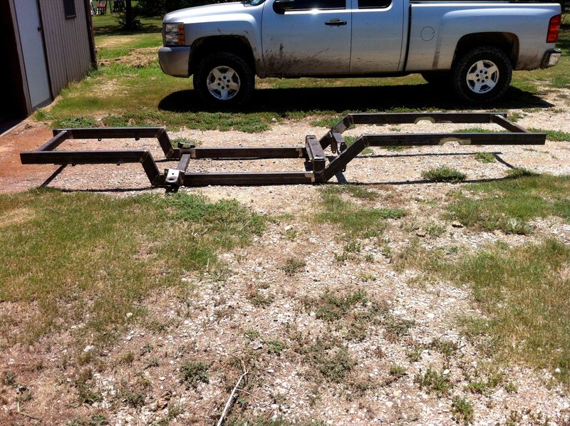

thanks alot guys, (BAGGED 68 FORD) ive been following your truck for along time, your truck made me buy my 65, Which company did you go with on your mustang 2 front end?? ive been lookin at a few but not sure which one to go with, Also to everyone else i found a few more pics ill try and post
