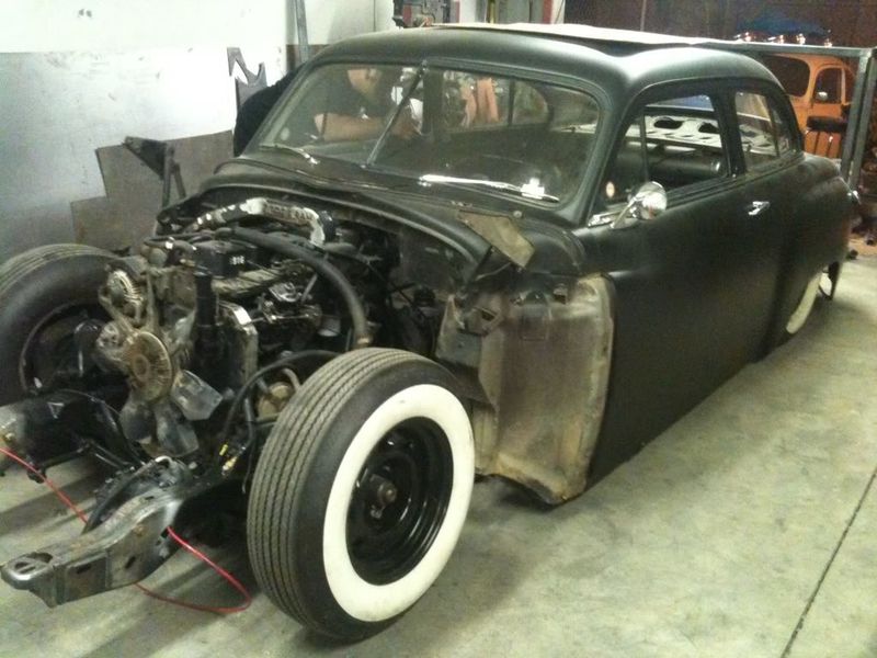

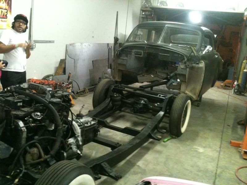

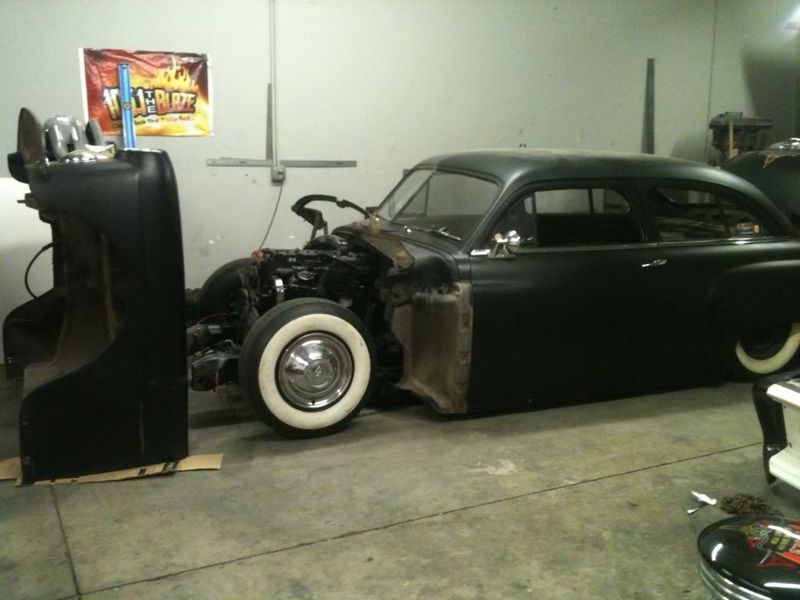

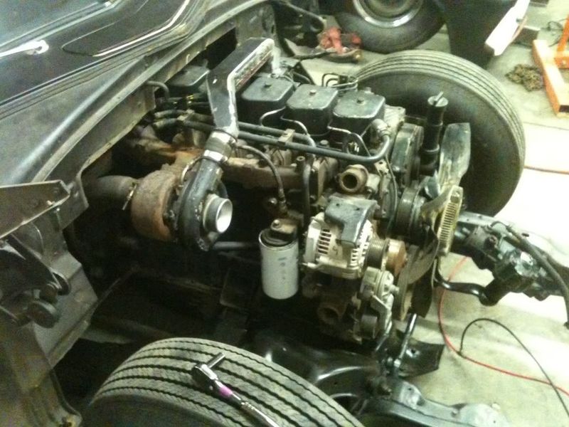

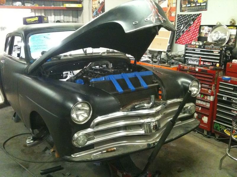

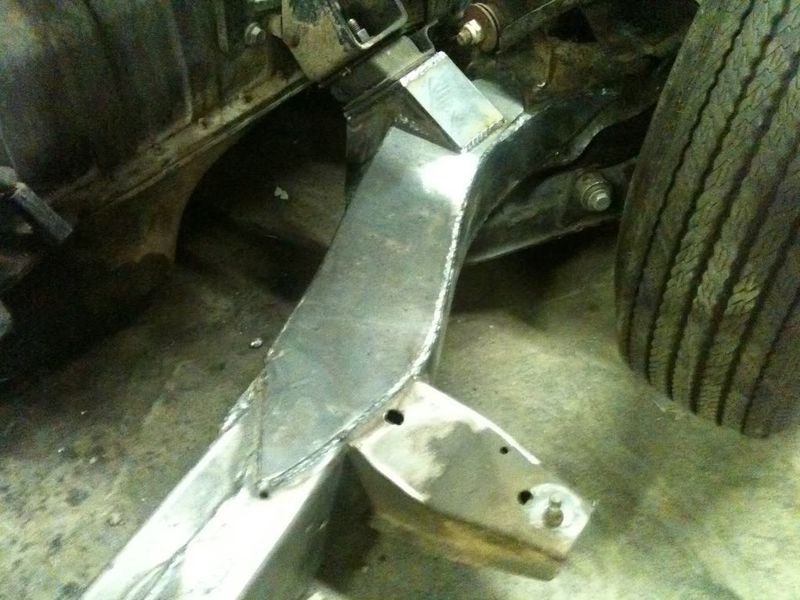

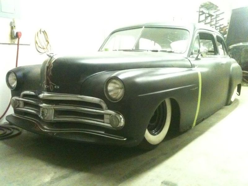

Been a while since I posted any progress on the 50 dodge diesel so here's the update... Haven't worked on it since the last updates been busy with customers projects.. But the 50 is gettin close to done here's the pics..
Here's the newest YouTube vid of it so much torque watch the car dip over when it fires up..
http://www.youtube.com/watch?v=-_af6mgaNZw&feature=youtube_gdata_player

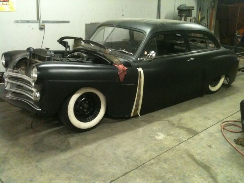

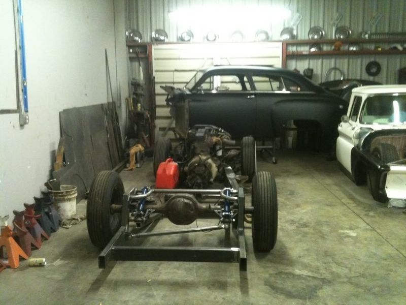

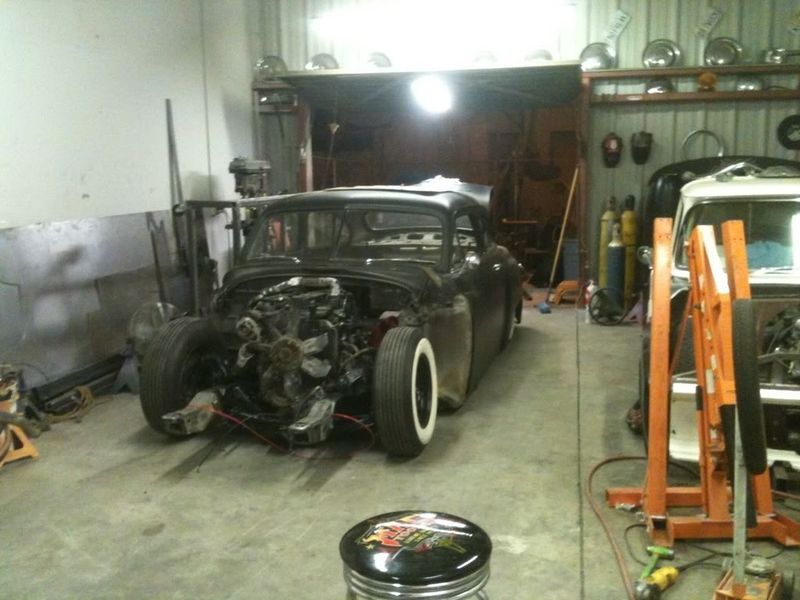

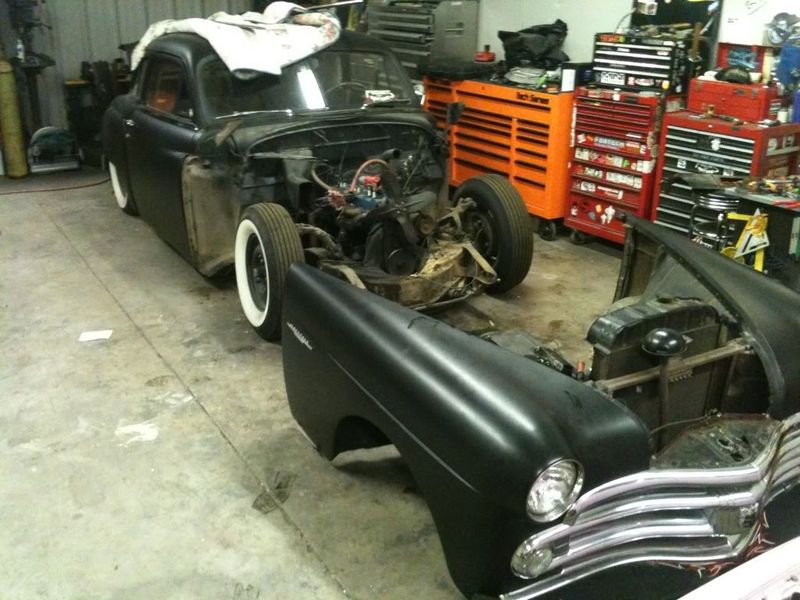

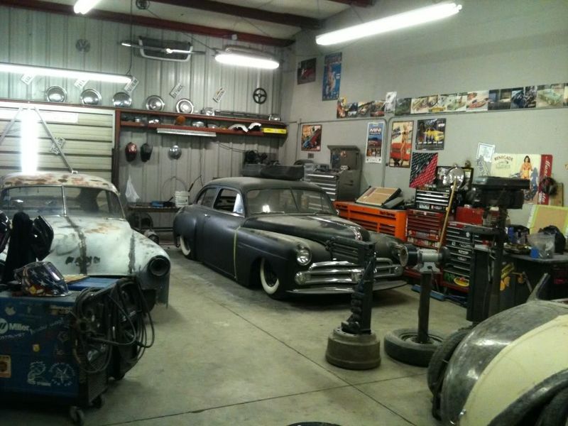

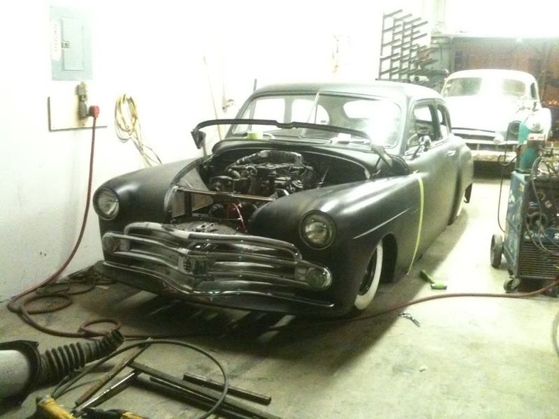

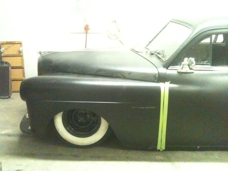

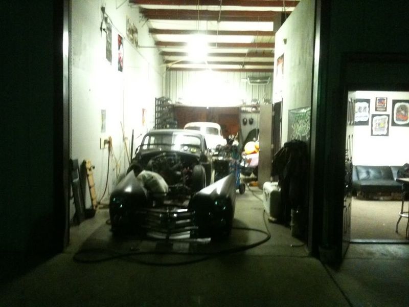

Rolled outside to clean the shop & get an idea of how it lays out now about 3" lower over all

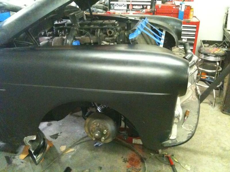

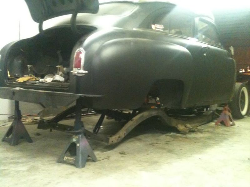

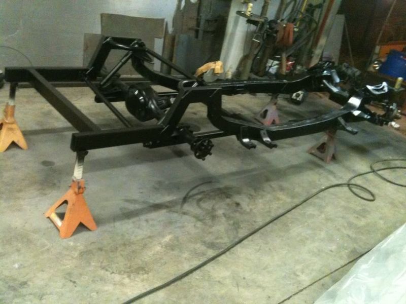

Up on stands back in the mix to get finished up

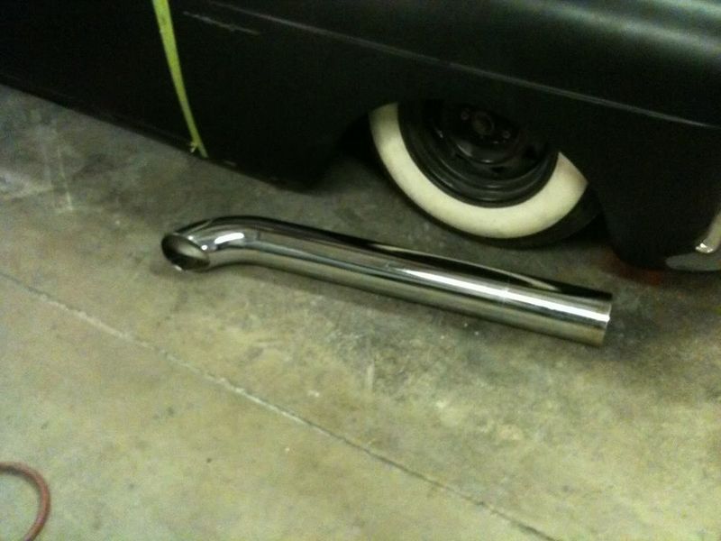

The start of the new exhaust 5" semi stack

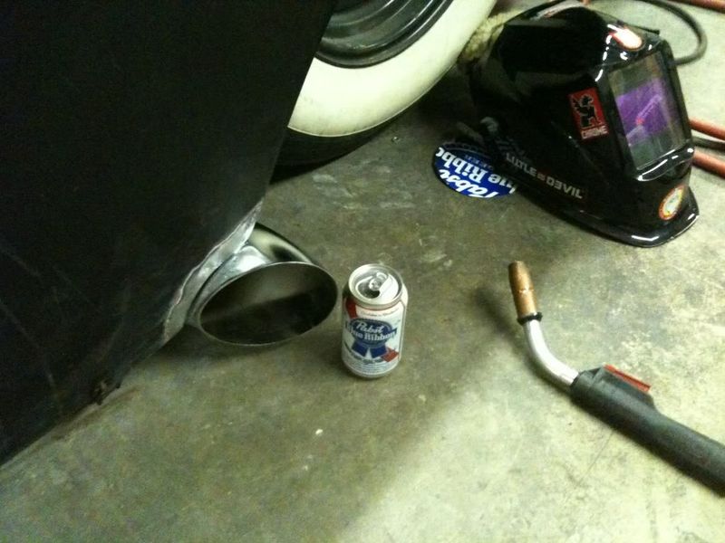

Exhaust tip installed

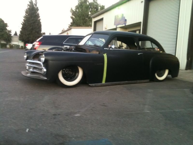

Side shot.. Gonna suck for whoever is at the light next to me..

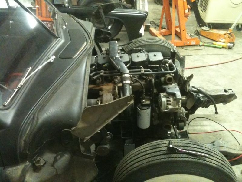

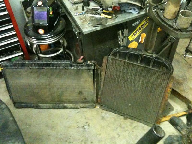

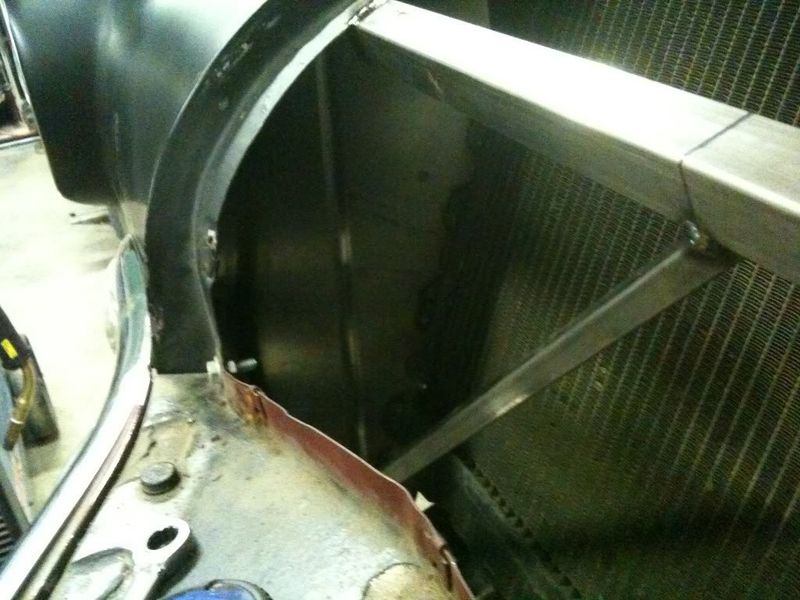

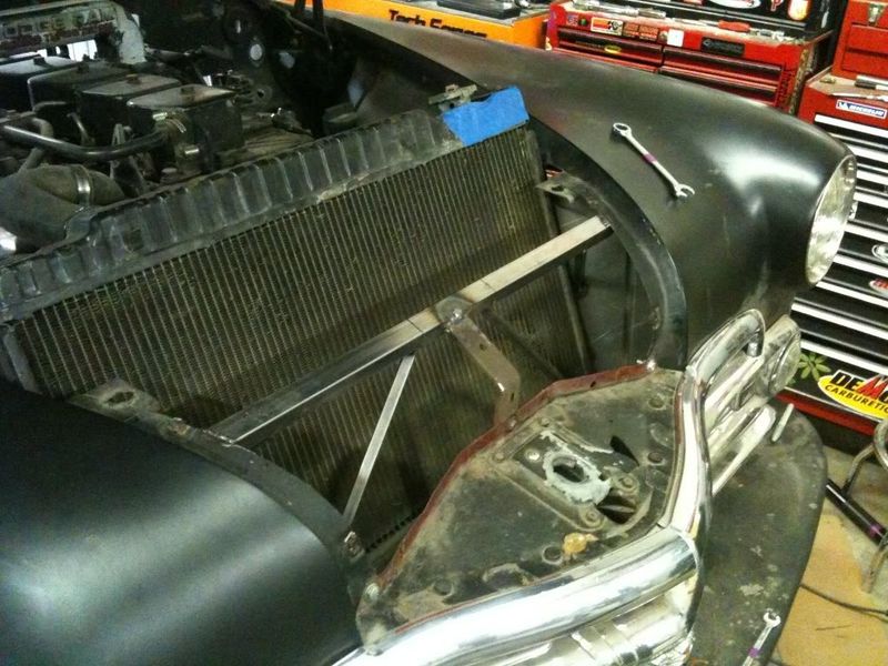

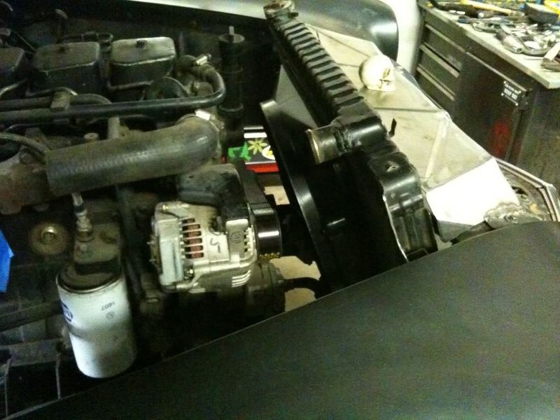

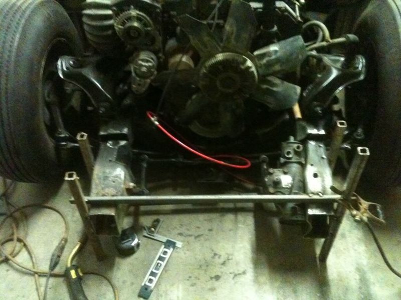

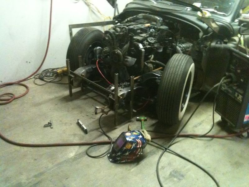

Time for a radiator.. Stock 50 one on right cummins truck left

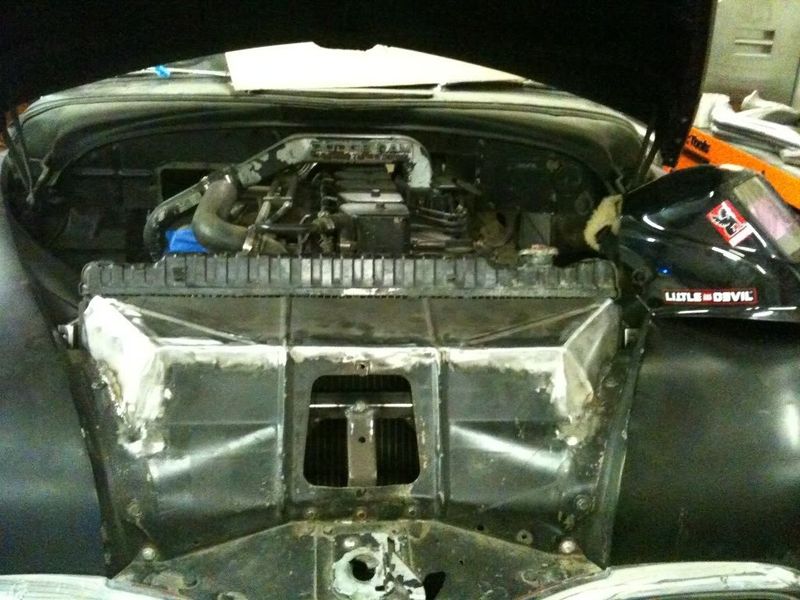

Tryin to figure out where to set the radiator

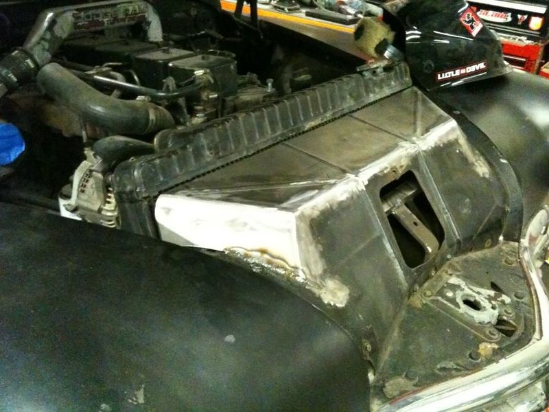

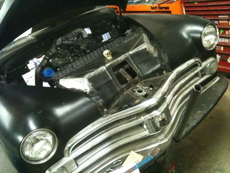

Had to lean it back to clear the hood..
Makin sure that air gets directed into te radiator
Modified stock shroud
Electric fan

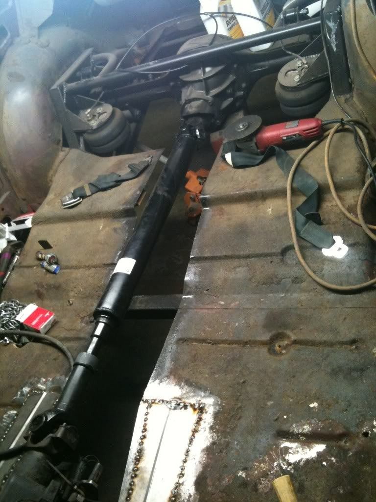

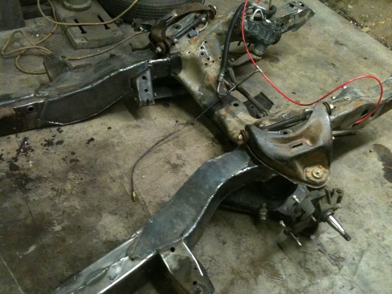

Dirive line with slip yoke Installed now just to fill all these holes back in.... Yay...
