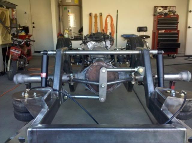

mjavy7's avatar
mjavy7
Here are some pics from another thread...Tre5's work.
Marcos_65's avatar
Marcos_65
Then I agree with everyone about adding a watts link, I had a panhard bar and it sucks, switched to a watts, night and day difference.

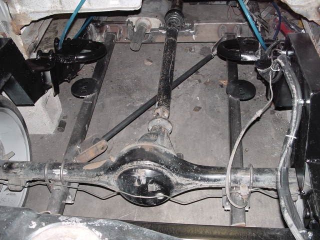

dragginbottom
Run a diagonal, it's the easiest and very effective!
darkstar06's avatar
darkstar06
what do you mean by a diagonal
