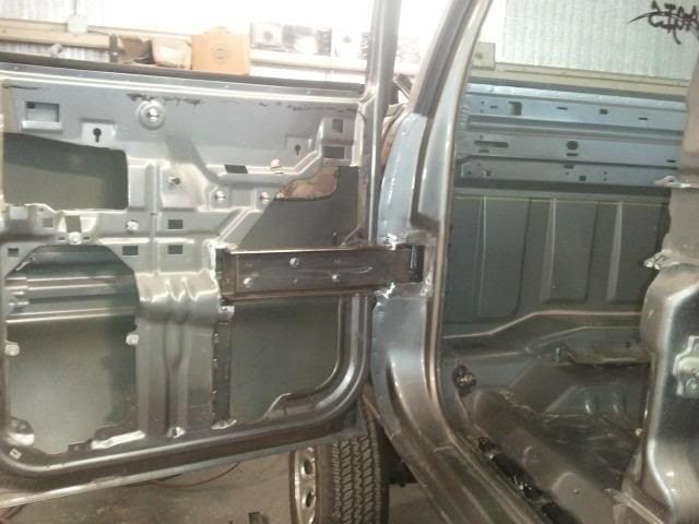

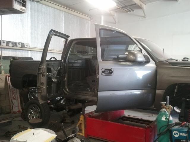

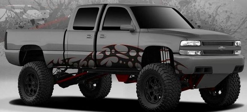

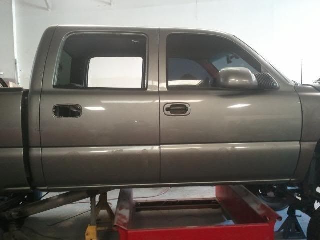

Havent updated in awhile. I changed up the suspension with a Full Throttle Suspension 16" 2wd kit with my 4" spindles, so the truck now has a 20" lift. The truck body has now gone under the knife for suicide rear doors and a handle flip. Every piece of suspension will be powdercoated red and black.
Rendering:
Sadistic Iron Werks hinges:

cajuntaco

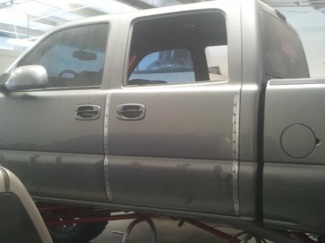

Damn. Whats your plans for the door handles?
BOYETT
Doors are being reskinned and handles will be relocated toward the b-pillar.

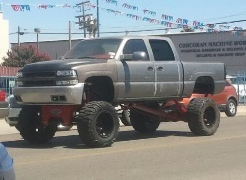

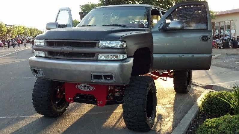

The truck is finally out of the shop! Still have alittle bit of work to do on the doors, but theyr 90% done. Suspension is done except the coilovers need to be cranked some more since the coils settled. Heres some pics.

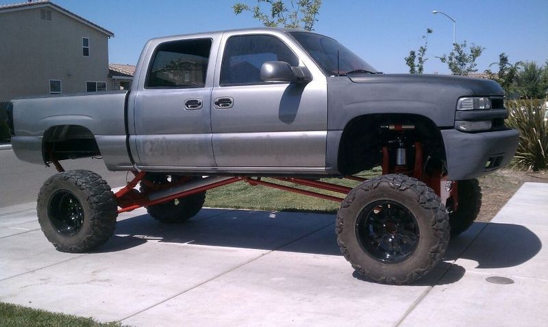

More updated pics!

BOYETT
Specs: 16" Full Throttle Suspension lift kit, 4" CST lift spindles, 18" Full Throttle Suspension leaf springs, swapped in 14 bolt rearend, 38x15.50 Nitto Mud Grapplers on 20x12 Ion wheels. Used Sadistic Iron Werks suicide hinges and Sisco's Fabrication swapped door skins and made the handles work with stock latches.
