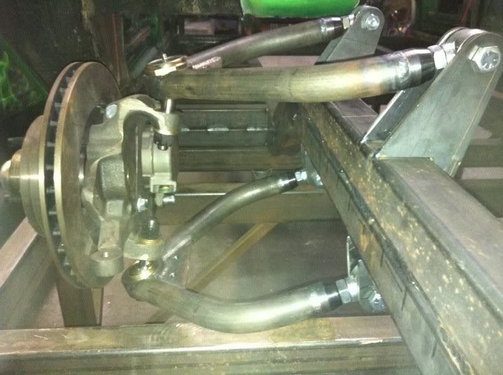

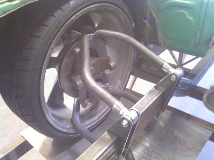

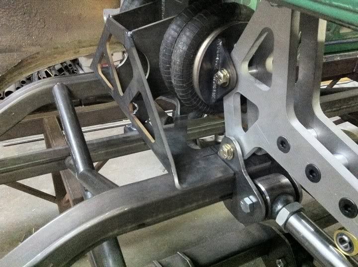

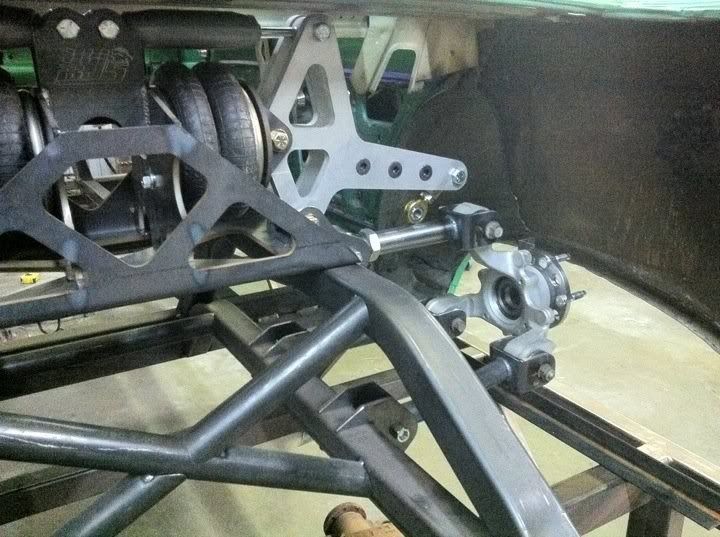

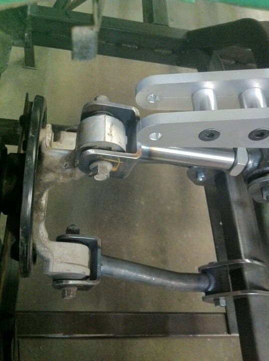

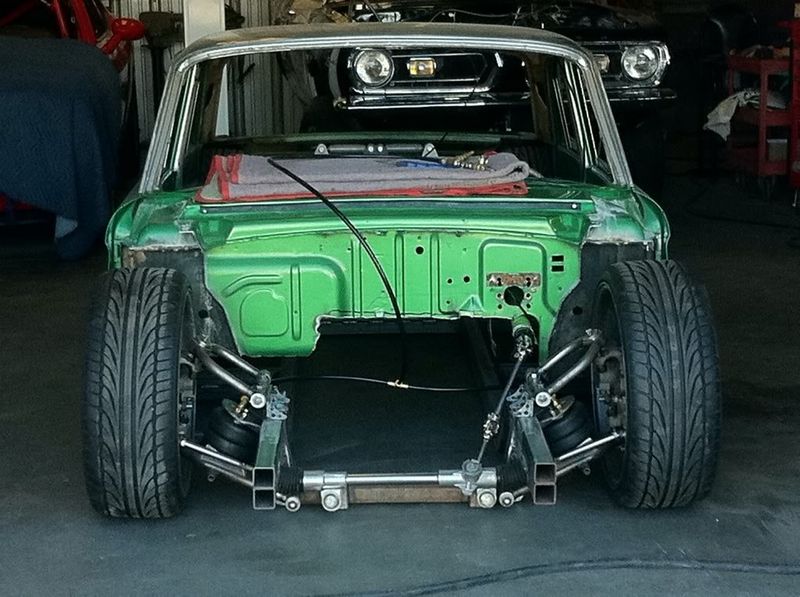

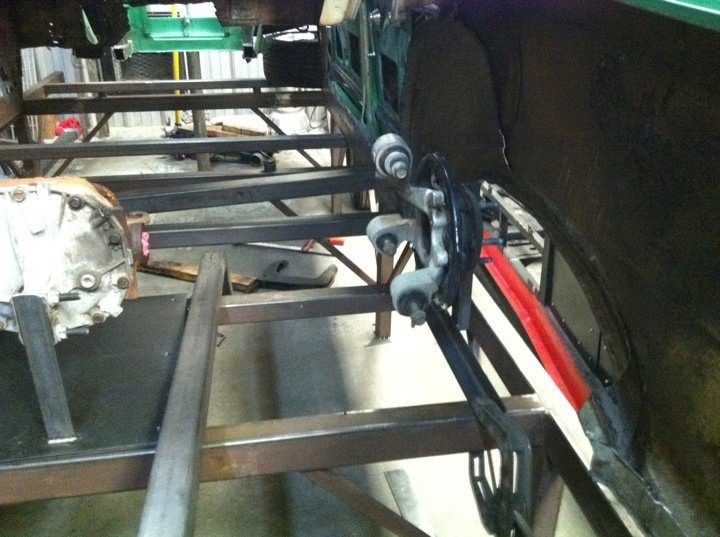

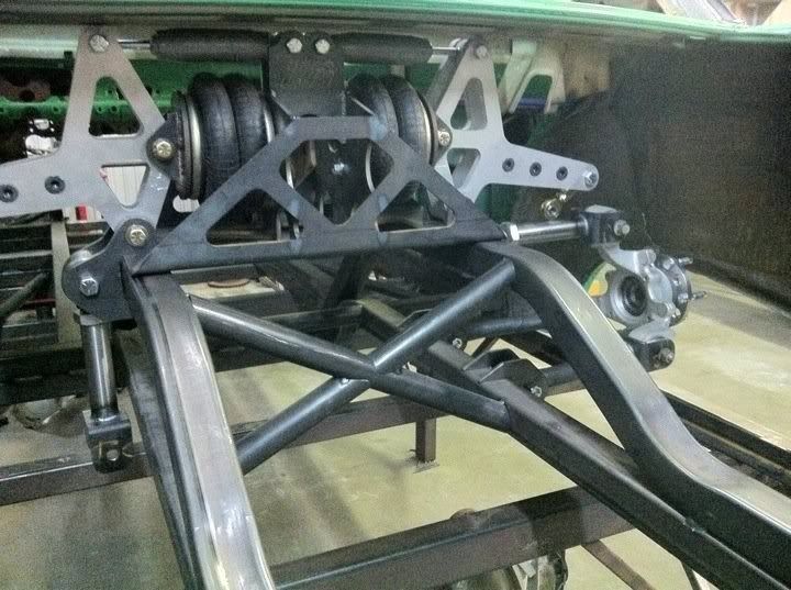

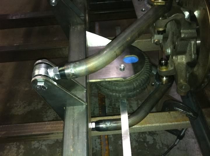

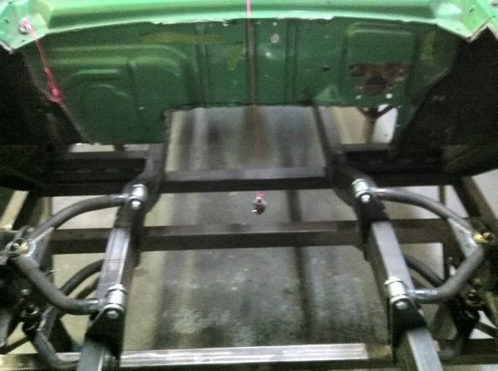

That will actually create more camber. The lower arm should ways be longer. Everything but that looks good though.
danclarisjunior's avatar
danclarisjunior
I'm talking about the front suspension, it seems that the lower balljoint is locked before the upper.

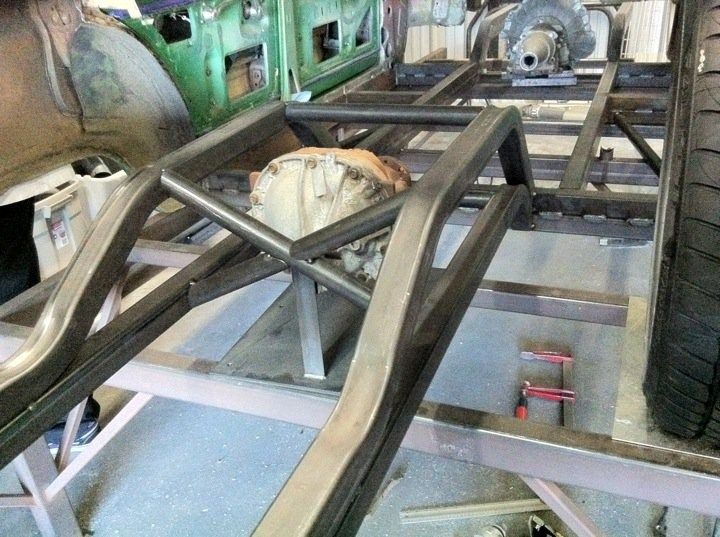

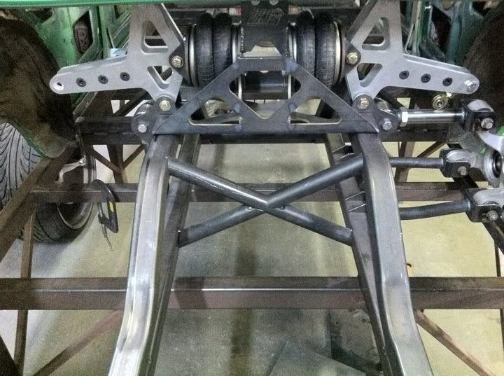

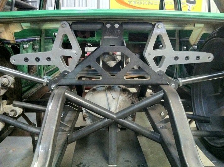

the cantilever back setup is totaly sick.....keep going.....nice work...
flaked62merc's avatar
flaked62merc
its a optical illusion , the lower arm is 1 inch longer then the lower, car maintains 12 inches of lift with .75 camber change , also at full drop with ball joint locked up car will be 10 inches off the ground , ride height put ball joint at optimal roll center
thacru78's avatar
thacru78
With the arms so close to the same length...what's that do to tire scrub. Seems as if you will have a significant amount of tire scrub...specially with the shorter arms.
flaked62merc
i was wrong and all of you were right , i misunderstood my fabricator . he built the arms on a flat plain and has a jig/ die to adjust the ball joint to a 10 degree angle using his 60 ton press. my bad guys , . asked him about it today and he informed me that i missed that part . also as for the arms length uppers are actually more then a inch shorter and there has been no adjustment done everything is only tacked into place,

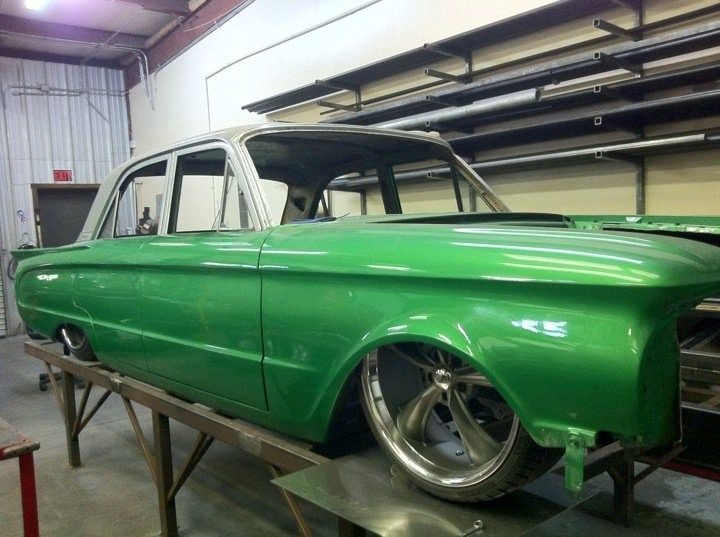

So its been a year since i posted pictures and 2011 has sucked , its a slow build but im hoping i have tis thing done in 2013 ,, oh and i joined FREAKS of NATURE

perfection is never rushed. this is a beautiful car glad to see you still have it and are still working on it.

and everyone was right the front suspension sucked , so i went to the original plan and im running a mustang 2 front end . mostly now im just trying to collect and stock pile the parts i still need . ......
