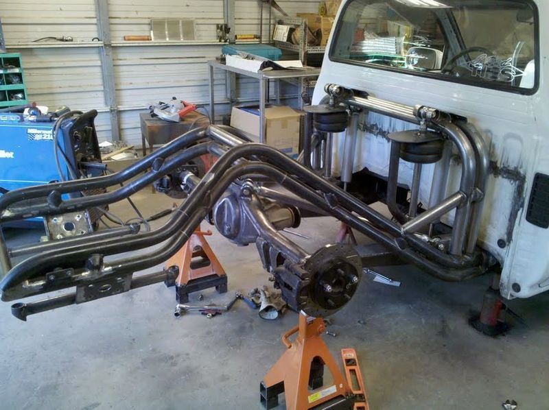

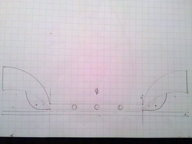

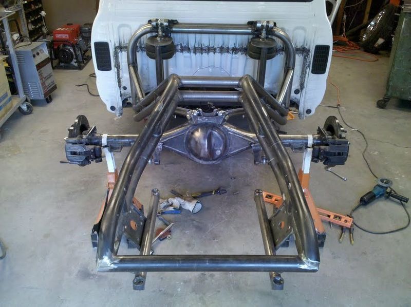

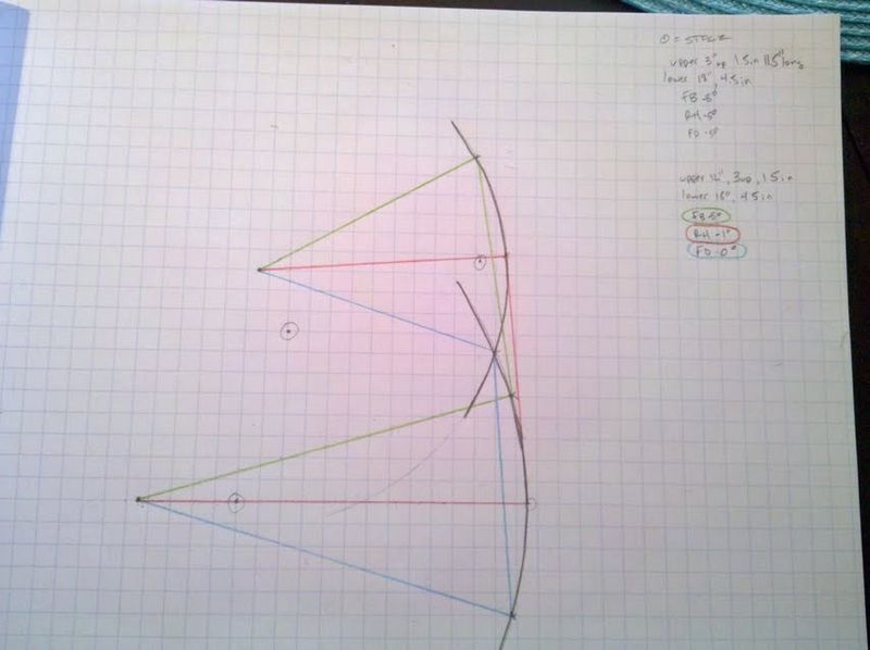

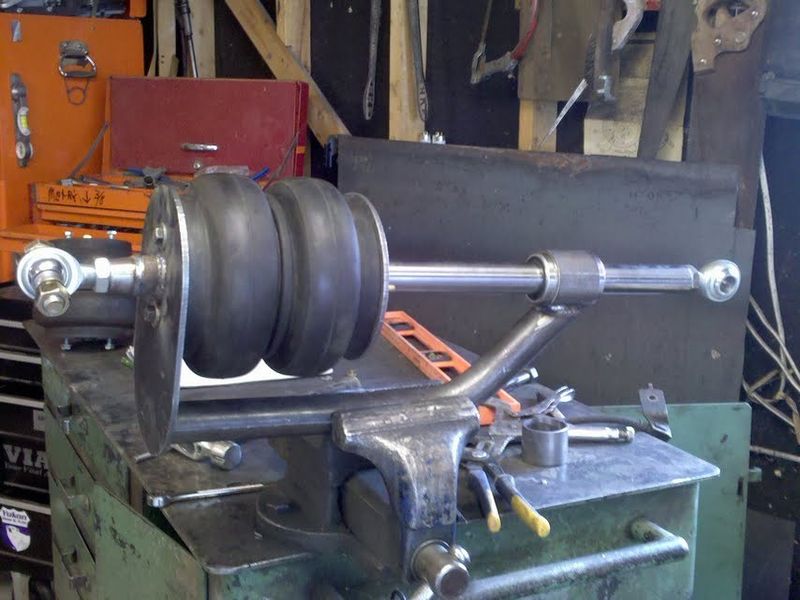

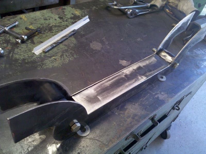

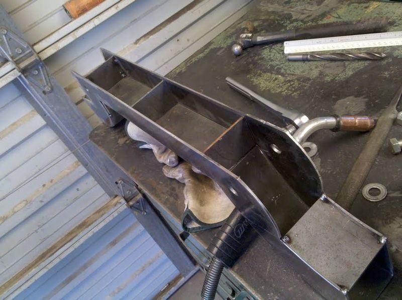

So here is a update, I got all the Front geometry figured and started to build my x members. I ended up lenghtening the lower arm by 4 in and moving it in about the same. With the upper will also move it in and up a bit and also make it 12 in long. This should give me about 5 deg of NC at full bump and 0deg at full droop here are some pics I hope to have this thing installed by the weekend and the other one done too. I think I said this last week but things are just taking a bit of time.

can i have some info on the rear disc brake set up
skro777
the discs and calipers are off a 99 mustang gt and i made the mounting brackets to fit them up.
