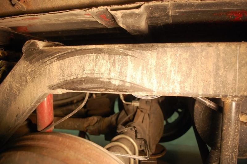

teckn9ne
If your trucks heavy this is what will happen without a legit panhard or watts link, mine HAD a diagonal bar trashed it friday and I couldnt be happier with my panhard!
truk2low4u's avatar
truk2low4u
I'm not sure what I am looking at in that pic other than your wheel rubbed on your frame. I've known alot of people that have used track bars on duellys etc and never had a problem with being heavy.
teckn9ne
Well mine swayed like a bitch sooooo im stuck with broken ass bedsides and part of my tire on my frame!
