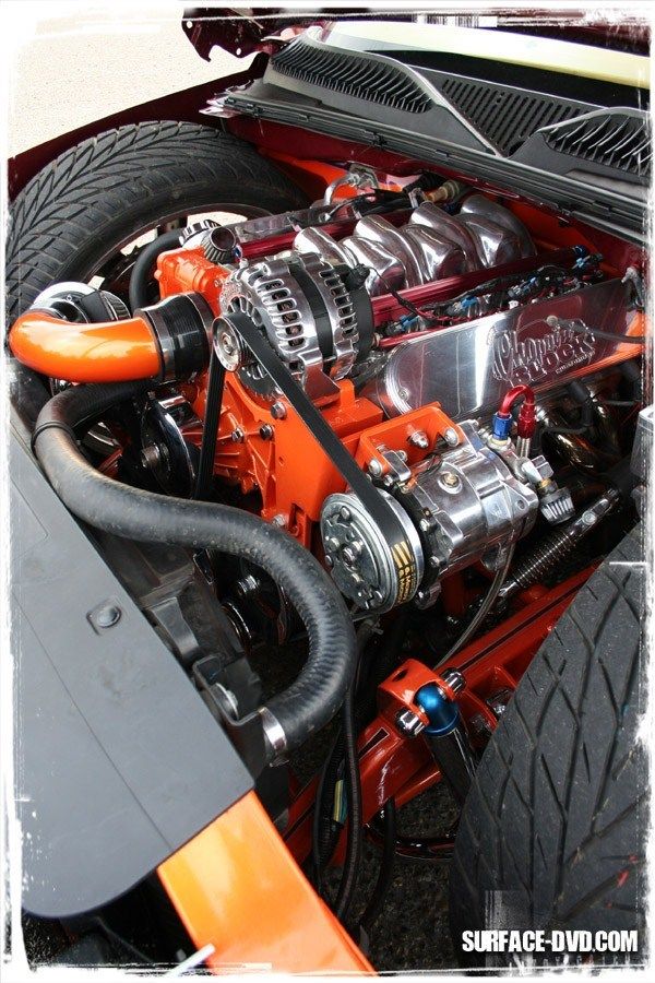

garagebuilt's avatar
garagebuilt
is this the right type?
Marcos_65's avatar
Marcos_65
You should use either a 508 or 709.
