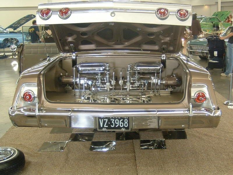

---------------------------------------------Originally posted by fknlowjeepsomeone should start posting some pics, i can't find anything about this ! sounds pretty cool though.---------------------------------------------This is a liitler off topic...On my last post there was a link to another thread, in there "tre5" posted something about aircraft hyros in layitlow.com. I went there and man there are I found some crazy set upts that I have never see in my life. I spent 10 year of my young adult life in Mexican town in Detroit Michigan there  I was spoon feed hydrolics for a good part of my life and NEVER EVER saw this crazy setups like the ones on that website (I guess I was hanging out with the middle class). Check them out it would be worth your time.  Here is one for the the ppl that care less and are too lazy to search... www.layitlow.com/forums/index.php?showtopic=425207 http" target="_blank" rel="nofollow">http://www.layitlow.com/forums/index.php?showtopic=425207 http://www.layitlow.com/forums/index.php?showtopic=425207
rzarock
Mexican Town huh? I grew up in Ecorse MI. Small world. That's an OG setup. It does all the same moves a modern setup does but it uses aircraft parts to do it. Looks great and is probably bullet proof but there's nothing different about the way it works. Check out this link. There's some good animation on the 3rd page. http://auto.howstuffworks.com/hydraulic-hybrid.htm This uses hydraulic energy stored in accumulators to drive a vehicle using a hydrostatic drive train (similar to what BOOOGHAR mentioned). This concept uses regenerative braking in addition to an engine mounted pump to charge the accumulator. This same concept could be easily used to run a very versitle hydraulic suspension setup that could be adjusted to simply lift and cruise or smash the back bumper. A real sleeper.  The fork lift components that dragnblazer mentioned would work for a power take off (PTO) that could be used to charge the accumulator.
