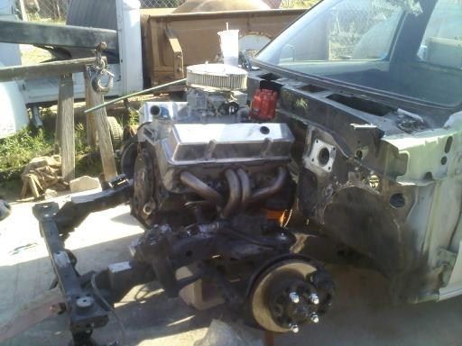

it alot of work when your bodydrop besause the motor sit so high! The pic is when we mock up the motor to build motor mounts!!!truck is almost done!!
