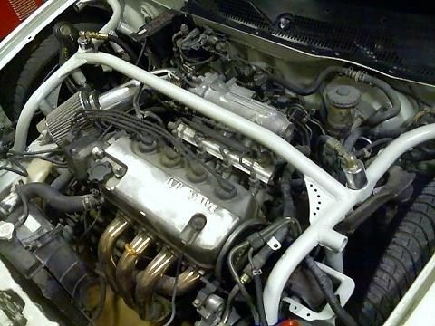

Im not sayin or arguing the properties of pipe is correct for structural use..........but its strong shit. it's not going to give you any problems making a wish bone from it.  i built a complete front subframe on my old civic from 1 1/4" pipe and daily drove that shit.
