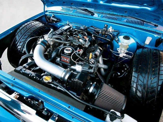

i have a 91 yota 22re i was wanting some pics of where everyone relocated the things under the hood. pics and description would be great

i have no pics yet cause we just finished mine up friday night to drive mine to unite this past weekend. anyways my clutch master cylinder was moved inside the cab notched out my dash crossbar to be able to have access to it, my fuse box on the passenger side was relocated to the inside on the firewall for now til we clean up the wiring more and my battery is mounted behind the passenger side seat for now til i get like a kinetik or batcap to take up less space. ac shit is gone in mine didnt use it anyway. all my wiring has been cleaned up and tied into the main harness coming out the passenger side of the engine going into the firewall. and some wiring for the driver side has been ran the same way close to the engine and ran into the firewall. only wires towards the front are for the headlights. ill try and get pics up soon as possible.

sadisticiron... do you have anymore pics? yours is very clean want it to look like that. or anymore info on where you put it all lol

everything is either in the same spot or just slightly moved. the fuse box is on top of the frame rail next to the radiator. the harness wires are poped out on the side of the firwall and ran in the fenders to the core support.  and the firewall harness is poped out near the framerail to be hidden from view. clutch master is under the dash. but will post pics tomorrow

I noticed you have an aftermarket cone filter. What did you do with the charcoal canister tube that goes to the stock air box.

removed it all
