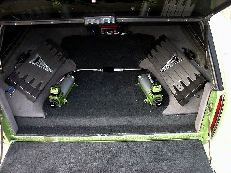

I've got 2 green OG style AZs. Had them since green first came out. They still run great. Still air up great. No issues with them at all. proper wire size and use of relays helps.   But hey Paul if you want to kick in a new set for the green machine sign me up.
