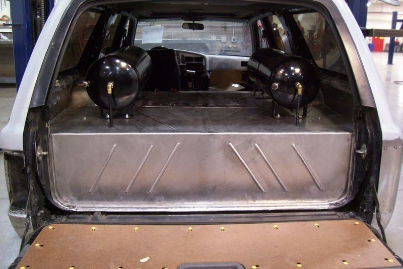

Are you wanting to keep your gas tank in the stock location? I relocated mine to the rear. My lower bars run forward and my uppers run backwards. Heres a picture how mine looks.   And this is it all covered up I still need to run the filler neck which I'll probably do out where the driver side tail light was. I also made an acess panel for my bags and shocks.

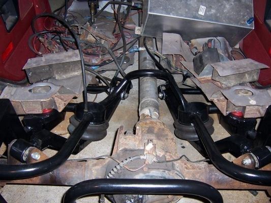

I ran a forward triangulated 4 link on my explorer, bags are on the upper bars and everything clears the floor except the driveshaft hoop which is only a couple inches up under the seat still a work in progress but you get the idea, and yes its the angle of the pic that makes it look like the driveshaft will rub it actually has a couple inches of clearance.

im planning on putting the gas tank in the back... matt that a sweet set up i like the beads you rolled in....  but im tryin to keep it more of a factory look... i know that about impossible but as much as i can anyways.....

brian that really loks good.... i like the low profile look... thats what i had in mind.... with your upper bars like that are there any negs to having em bent..... never thought about that but im would help keepin it lower profiled..... thanks for the pics yall.... really appreciate it....

slammedxonair
pivot points are what matters its just getting there a different way really
