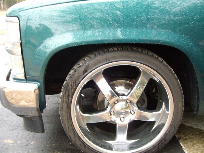

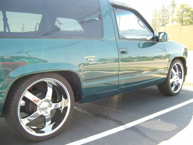

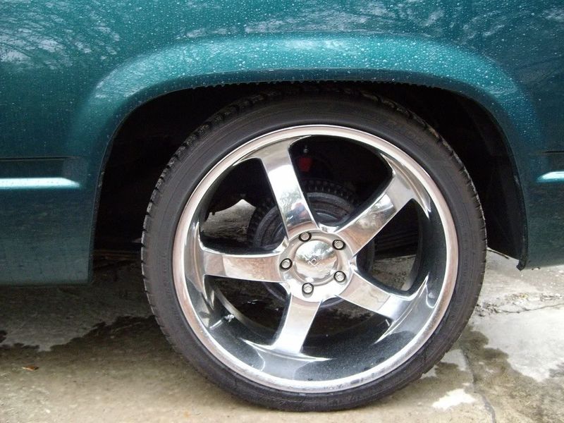

Edited: 3/15/2009 9:31:25 AM by phkntknThis is how My 96 sits with a 4-6 drop and 22x9 Boss 335 with 265/35's (sorry for the crappy pics its raining today)FrontEdited: 3/15/2009 9:30:17 AM by phkntknBack
